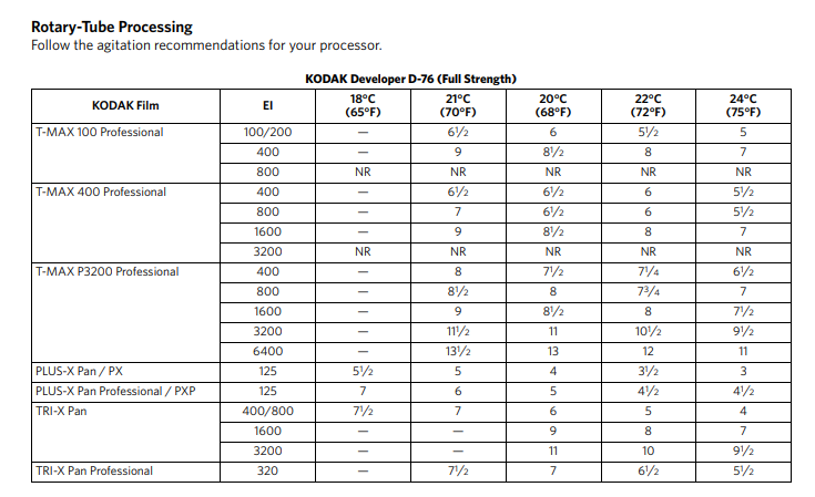

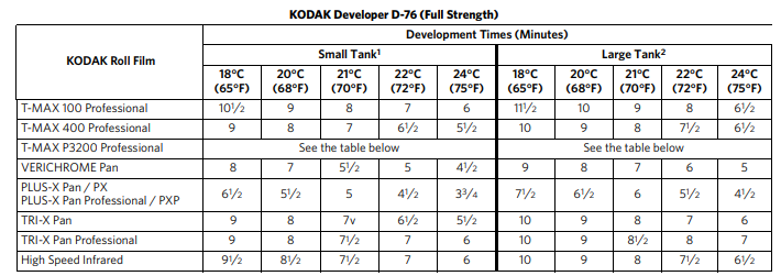

I’m planning to use D-76 developer; up until now, I’ve primarily worked with Ilford DD. While I haven’t set up the JOBO machine yet, I’m making sure I understand the correct programming times. Most of my experience has been with a dip-and-dunk setup, so I’m trying to mindfully adjust and adapt to the JOBO process to ensure everything is done perfectly.
And yes, I run a commercial operation and wanted to check if that still allows me to ask questions here. I apologize if that isn’t permitted and hope I haven’t inadvertently broken any rules.
Kodak tends to have starting times for different development methods including rotary tube.
I know the times are for full strength, but it gives you an idea and you can begin by extrapolating the difference between the full strength and 1:1 times using a different method.
