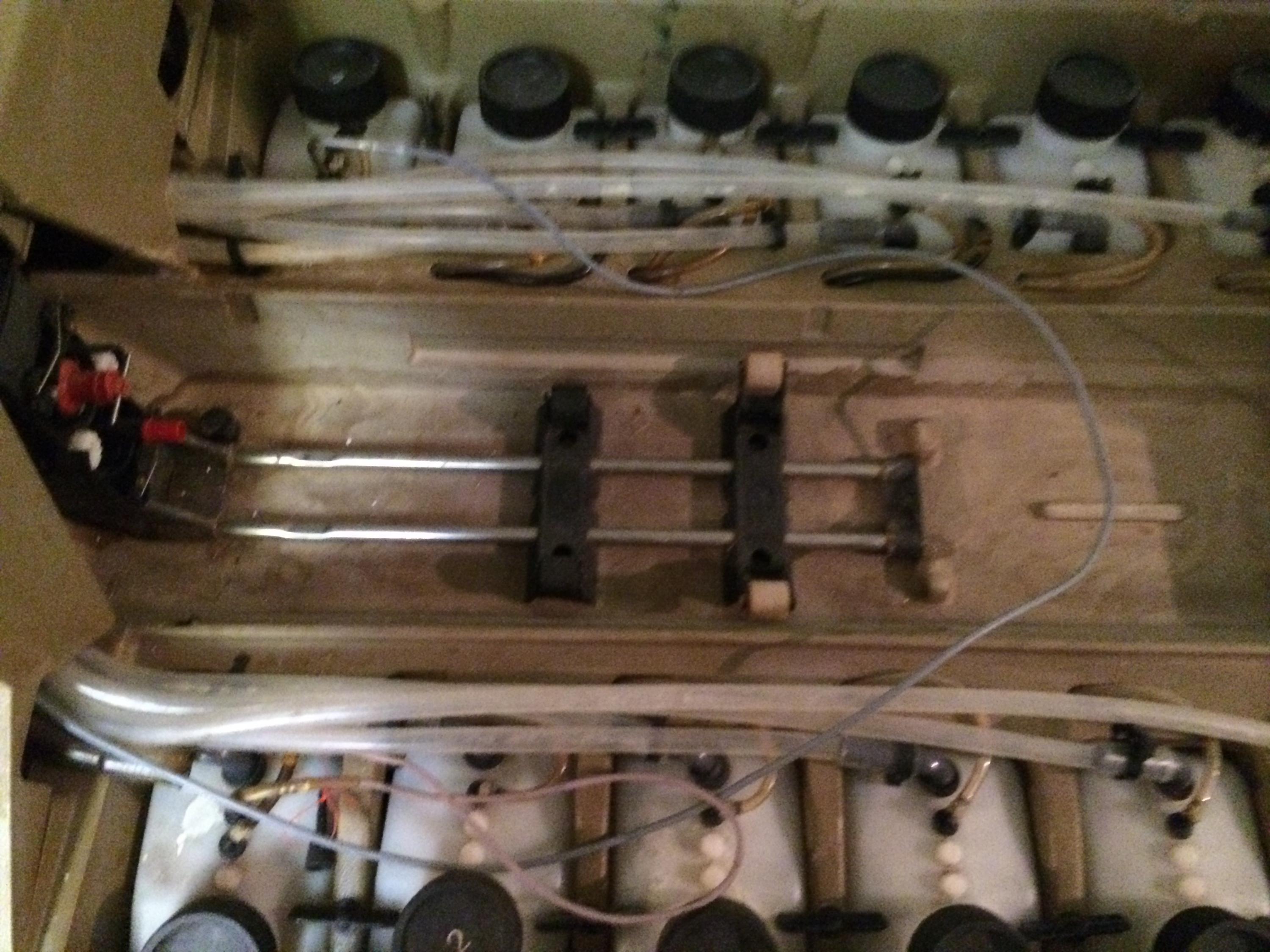

I'm reviving this thread as I got a chance to look at the Jobo today. I managed to connect most of the tubes that drain used chemistry into the 15l containers and I figured out how to plug it in, but there's still a few things I don't quite understand.

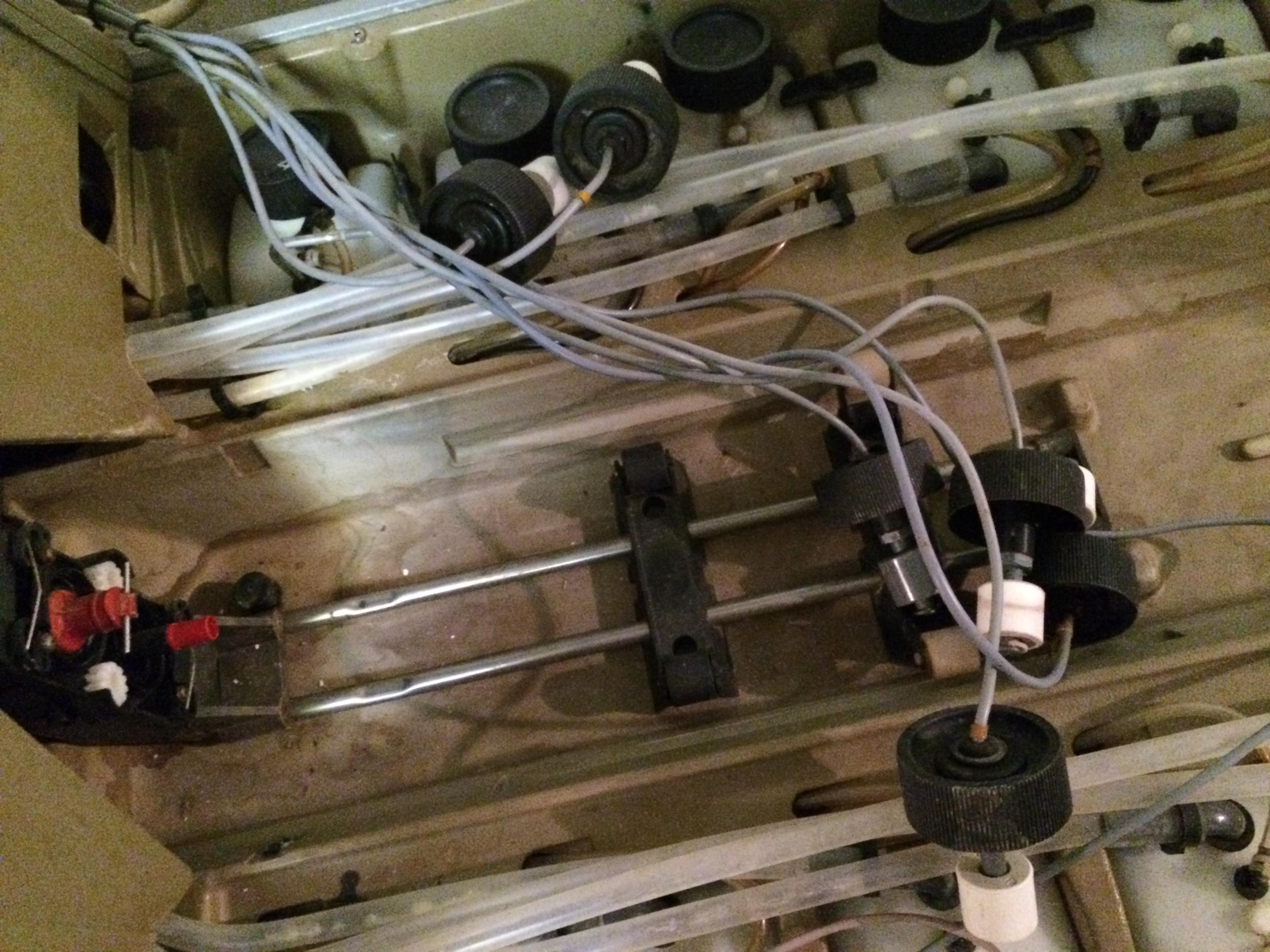

There's this grey tube that runs from one end of the machine to the other (see attached image), it seems to me that it would get in the way of the rotary processor, and not all the bottles have the same kind of tube going to them.
Then there's a large number of smaller tubes going to what looks like lids for the chemistry bottles, but all the bottles already have lids, as well as other tubes going to and from them, so I can't really figure out what they're there for.

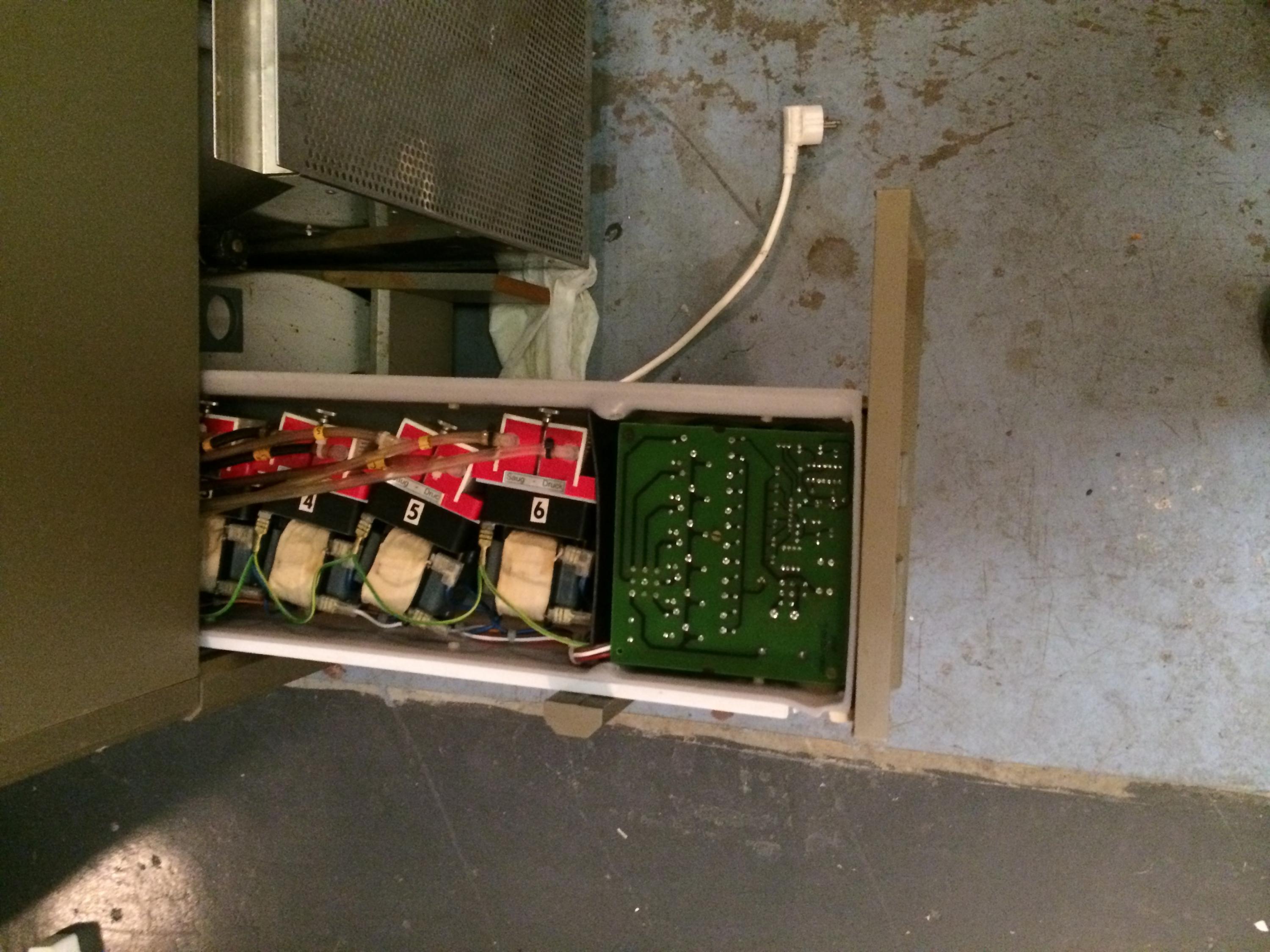

Then under the "main unit" there was a drawer with two buttons and a hole on front panel. Inside this drawer there were loads of electronics, couldn't find any mention of them in the manual, any idea what they are for?

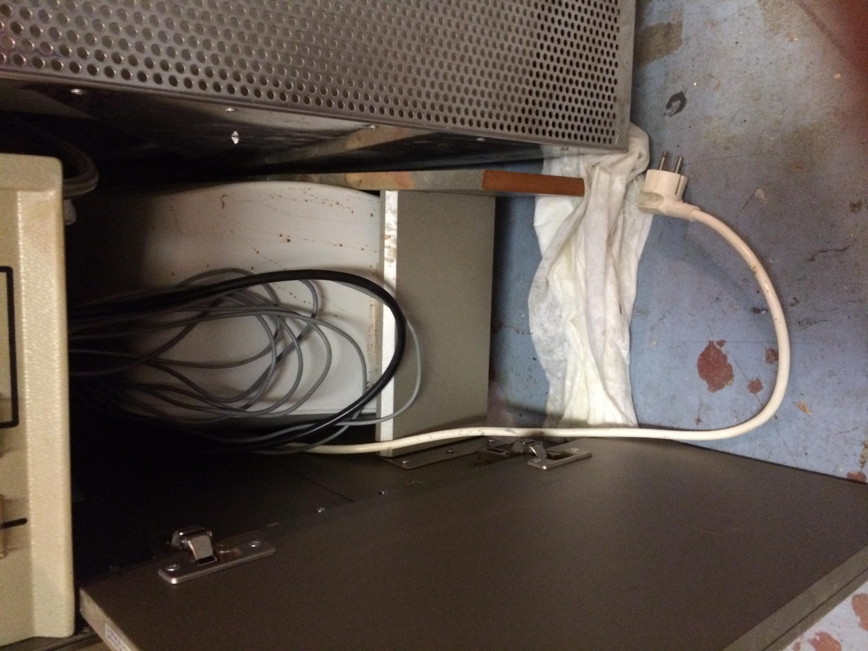

Under said drawer I found a white box with a power cord attached to it, couldn't find anything about that either.
The unit also had two additional pwer cords near the back, one that went to the top unit (made the entire thing turn on) and one that went to the bottom (didn't seem to to anything at all), any ideas?
