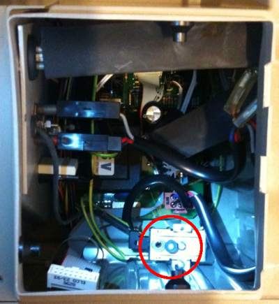

I'm new here, but I was wondering if anyone has any tips for fixing my processor.
I have a 110v ATL-1000 which does not seem to heat the water bath. If I warm the water bath to temp externally, the process runs. If I don't, it just sits there forever rotating the drum and neither heating anything nor starting the first step in the process.
I tested the terminals on the heater element and they seem OK, 17 ohms from memory.
Does anyone have a Jobo schematic, or any handy troubleshooting info for what might be causing this?
Thanks!
- Angus

Thanks willem. I emailed Jobo, and they kindly sent me a copy of the ATL-1500 service manual - it has the disassembly procedures, test procedures for the 1500 and schematics for both. Is that the one you mean?
I've waited a long time, but it's definitely not heating. I have a power usage meter that shows it never uses more than 50W of power, so the heater element is definitely not coming on.
It seems to sense the temperature fine, because if I give it 38 degree water then it will start (and then the water bath slowly gets cooler as the process runs. Eek!)
eclarke, I know I need to provide tempered rinse water, but AFAIK the unit it still supposed to be able to heat the water bath and maintain its temperature. Mine doesn't do that. :sad:.

I have a theory. There's a part inside the case that looks a bit like a fridge thermostat, with two heavy duty electrical connections. It was showing open circuit when I tested it.
The service manual talks about a "temperature limiter", and the schematic seems to show it needs to be closed in order for the heater to power up. So I think it might be that.

Oh wow, I can't believe how simple this turned out to be.
The "fridge thermostat thing" was indeed a thermal circuit breaker. I pulled it out and was looking at it when I noticed it had a big button on top of it. Press the button, breaker resets and goes close circuit. Reinstalled, and I have a heater! A test process is running now.
Jobo's manual only mentions this in vague passing, so I've attached a photo of where you can find it. It's directly under the control head, so you'll need to pull that off to access it. However, you don't need to remove anything else - you can just press the button on top. Make sure you unplug from the mains before doing anything (obviously.)
Please excuse camera phone quality. :wink:.

I am using a Jobo ATL 1500. Running the machine dry by accident will invoke the thermal circuit breaker in order to avoid overheating or burning.
For a reset you have to remove the top cover around the on/off switch. You can look inside the machine then. Straight down you can see an electronics board. When the machine is running, a red LED will indicate that the heating is on. For a reset you must trigger the reset button with a thin pencil. The reset button is placed on the electronics board.
Another reason for nil heating can be a malfunction of a little trigger which gets lifted by the waterplane inside the tank. You can find the trigger by grabbing inside the tank. Next to the six bottles containing the chemicals there is a rectangular hole inside the front wall next to the bottom of the tank. Grab inside this hole. The floating trigger is on the right side (the side where the on/off button sits). Move the floating trigger and check the red LED.

I sold a Jobo processor that turned out to be a spare. The previous owner said that the motor and heater were working. When my buyer received it, the motor worked but the heater did not. I had him contact Dave Smith in Los Angeles who walked the buyer through the repair on the telephone. The reset switch had shifted during shipping. By moving it back in place and pushing the connectors on better, it was fully functional again.
These type of problems are either not written up in the instructions or just glossed over.

Once I decided to give up, go watch some TV with a glass of wine and stop looking for the reset button on circuit board it suddenly appeared to me!
Its not on the green circuit board at all! it was in the place like the picture angusgr described, which I too first saw but discounted it early on because the button doesnt push (at all) and I couldnt associate the picture with what I was looking at, I wasnt sure what location the picture was showing (the underneath of unit or from top?) ! I tried to push the button as suggested but its just a solid bit of plastic that no amount of pushing moves it! so I moved on to looking on circut board :confused::blink:
So, as these things happen, once I sat down and decided not to bother with it the solution came to me and I noticed how the pic resembled the veiw from looking down into the machine, from under the control panel (head?) on the top, disgusted with my solid lump of plastic where everyone else got a button to push (how fair is that!) I pulled my lump of plastic UP and that was the reset switch :laugh::laugh: problem solved and the wine tasted even better :cool:

My heater in my Jobo ATL 1000 crapped out today between process runs. I had just started to develop my 86 rolls of 35 and 120 from my European 2010 summer trip. Before freaking out and picking up the processor in a fit of rage I decided to see if my good analog friends online had any solutions.
So it is that I found this thread here and pushed in my little black button as per "angusgr's" post. The button made a warm mechanical click that leads me to believe that my world of analog is safe again once more.

It works! I simply removed the 3 screws that keeps the control panel in place, moved it aside and located the reset button in the unit.
