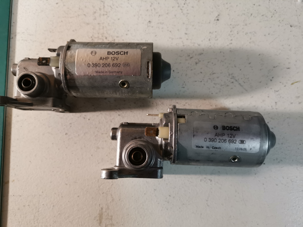

The rotation motor in my ATL-1000 is making strange noises. It still works, but it's probably a good idea to start looking for a replacement.
The question is: Where can I get one?
In the past I've got parts from Klaus Seynsche, but his website is down (www.fotolaborservice.de), so I wonder if he's still in business. Catlabs is an option too I suppose, but I'll first try to find one closer to home.
Also: Do anyone know the manufacturer and parts number for the motor?

I can probably answer my own question. I found this post: https://www.photrio.com/forum/threads/what-are-those-jobo-parts.74633/ which refers to "Bosch 0 390 206 692". A quick search reveals that this motor is used, among other things, as a head rest motor on some Mercedes cars. Found one on eBay which I bought: https://www.ebay.com/itm/original-B...369611&hash=item3b25e57ebb:g:-qgAAOSwXyBcIVOV
A search on eBay for "Mercedes w124 head rest motor" results in several motors made by Brose, which look very similar to the Bosch.

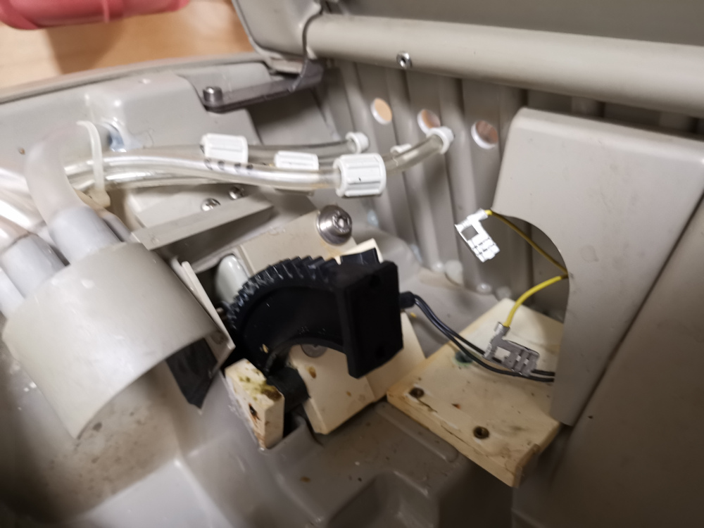

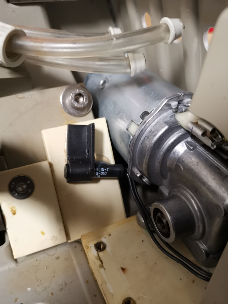

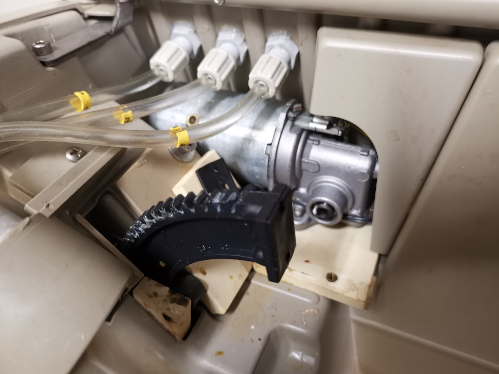

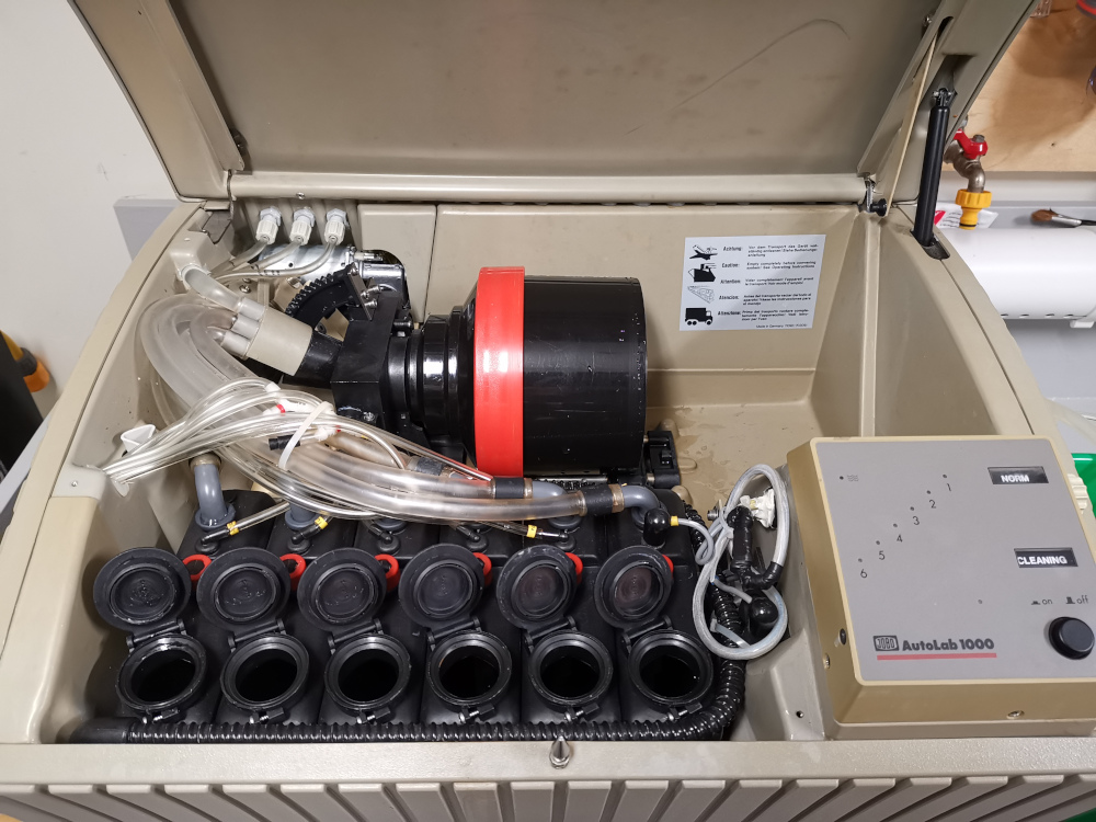

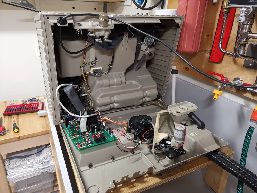

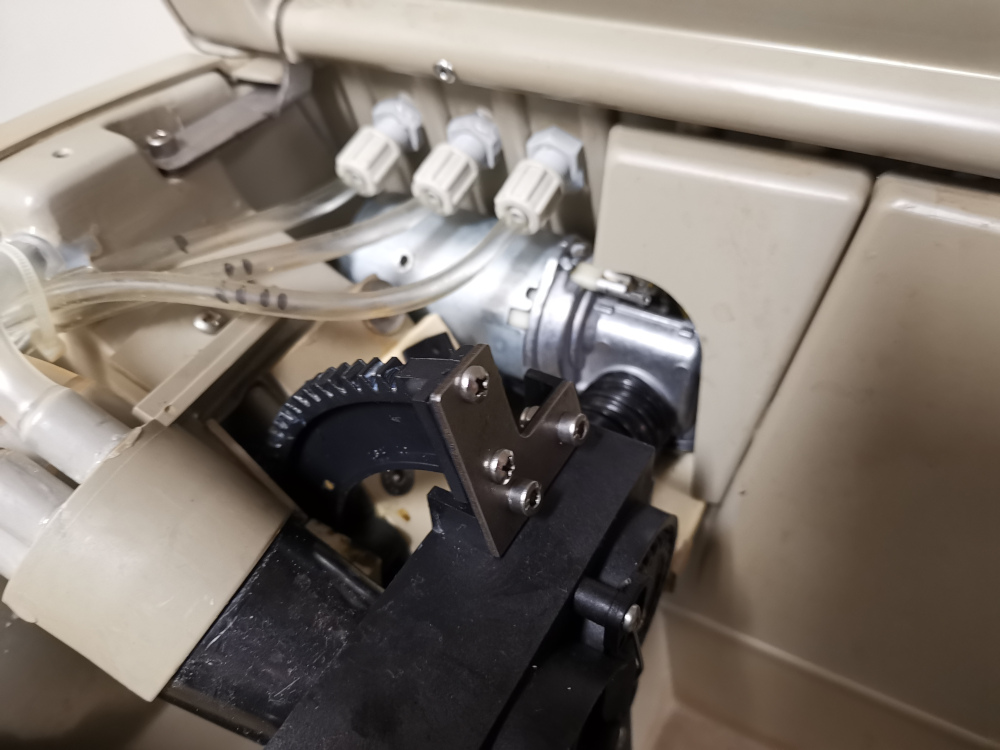

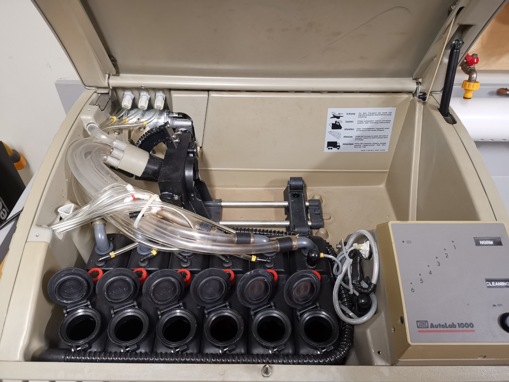

Collected the motor yesterday, and I have now replaced the motor in my Jobo. It took about two hours, and was relatively easy to do.
Trond
