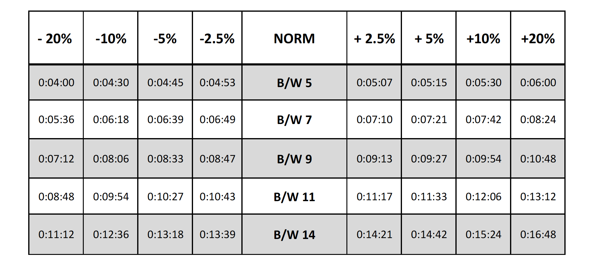

I received the Jobo and everything is working great. I had originally only planned on using it for color and continuing doing B&W by hand, but after trying it with the Jobo a few times I will probably use this machine for both (not sure how I ever managed without it honestly).
Anyways, I made a chart in Excel detailing the actual times for the different B&W programs instead of "+5% of 8 min", as I was getting tired of calculating it each time to find the in-between times. I hope someone else will find it useful!
