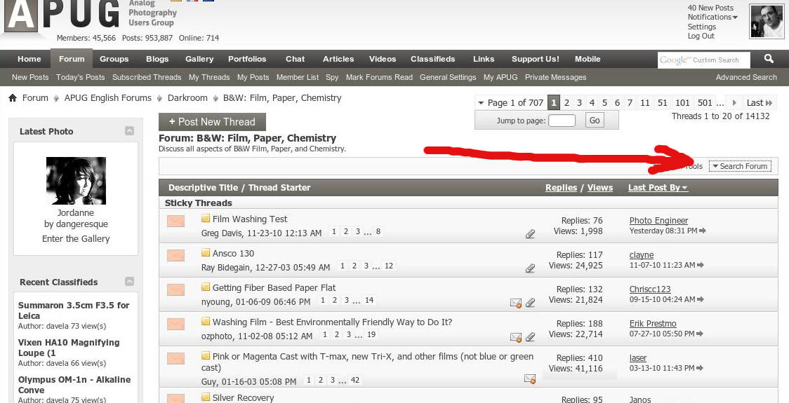

All of the Apug forums have a nice "Search" function. Learn how to use it, it's not difficult.
Once you open the "B&W: Film, Paper, Chemistry" forum (where you posted this), you should use "Search forum" - just above the "Last post by" link (see attached screenshot).
Enter "JOBO" as a search term, and you'll get more reading material than you'll be able to read in a week. :smile:
