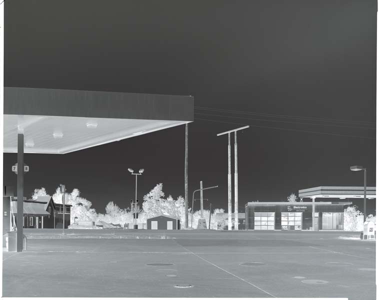

Here is an example of the uneven development issue. Look in the upper right hand corner. Thanks.
