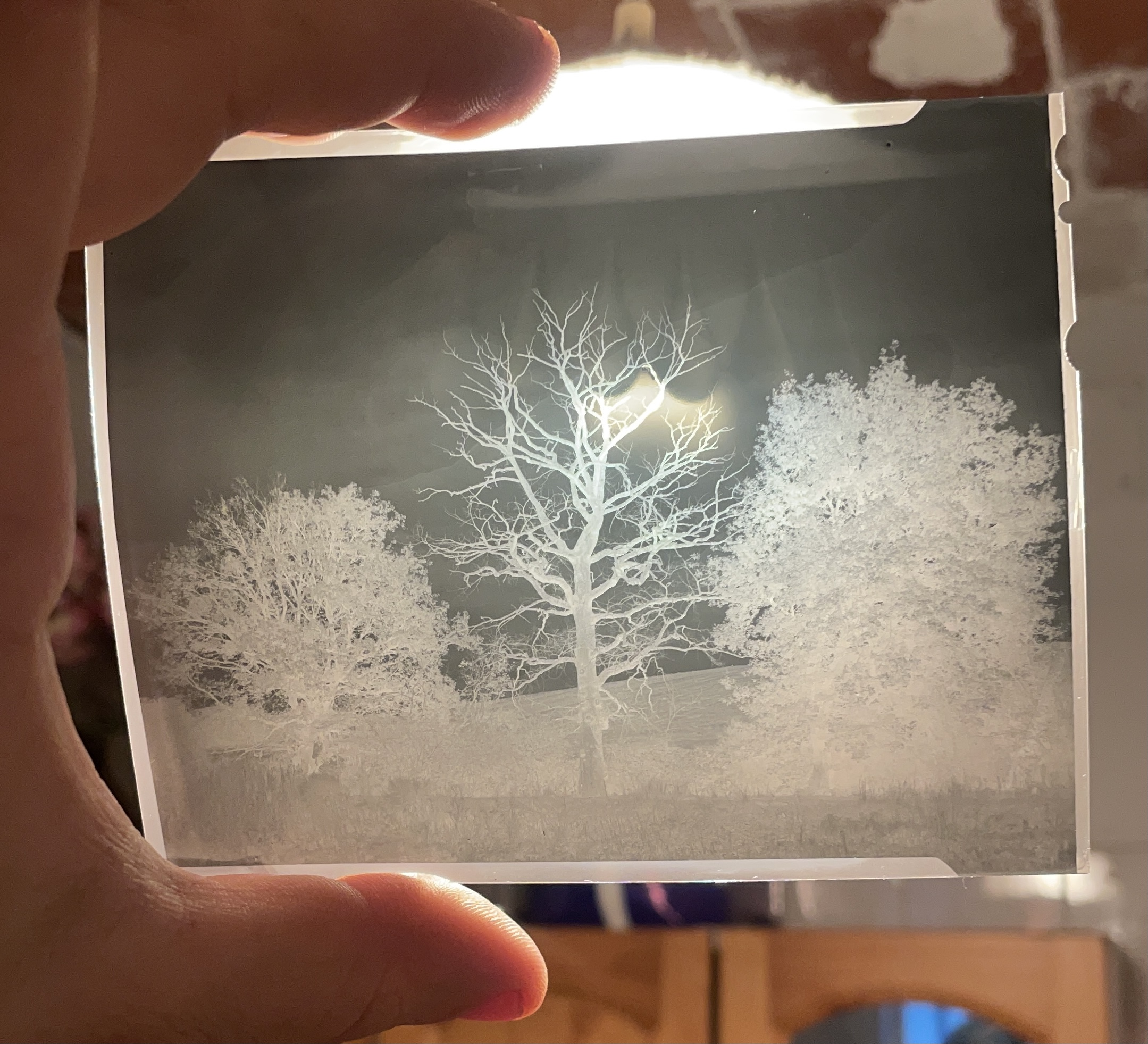

KraftwerkNation63
Jan 13, 2021
12
France
Hello Everybody!
Only to says to you that i have follow your advices. I have not reduced the time of 15% and all work perfectly!
Thanks a lot for your help! :smile:
