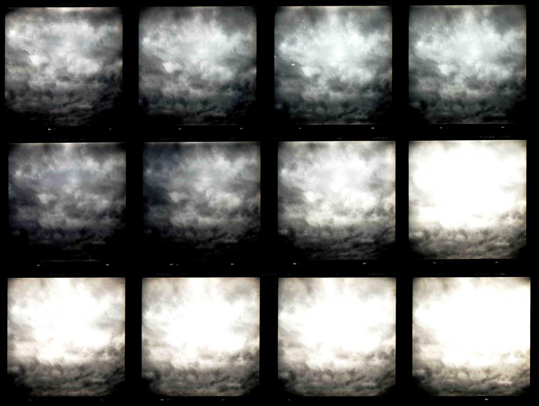

Greetings,
I recently acquired a 2500 series jobo tank, I believe the 2553. In my second attempt to hand process I purchased a jobo roller base. I photographed an overcast sky on three separate 120 rolls and processed all in D-76. Regardless of developer/film combo, what I noticed was that each roll was consistently unevenly developed. From one end to the other each roll's density increased.

I am eager to continue my testing and figure this out, before I move on to the 4x5 testing of the tank. Any suggestions as to how I could go about getting even development would be greatly appreciated.

More info please.
How much liquid?
How did you load the reels? Film on the outside? Inside of the reel? Or two rolls on the same reel?
If you're spinning then the inner part gets the least amount of chemicals.
Roller base requires constant spinning. The P/75 is for the processor don't worry about it.

My hypothesis:
The film end closest to the center was being submerged in the developer more often than the outer portions of the film, causing a gradation of development.
This would be true only if you loaded the reels all the way to the inside of the reel, i.e. all the way to the center core, leaving the empty space on the outer part of the reel - which is NOT how you load the film if you want to use rotation. If you use "normal" way of "hand" developing in a tank, it doesn't matter. But, for rotation, the film must not be threaded all the way to the core. Or, it may - but then you must fill the tank/drum almost completely - according to instructions, which can be found on the web, e.g. HERE.
You'll see that the quantity of chemicals if you use ONE 120 film per reel is lower than if you want to use TWO films per reel.
Some (newer) Jobo reels have a red tab, with instructions that you load the 120 film only until you reach the red tab. The way to load it is to "thread" the film in only until you reach the end of the film - do NOT thread it any more - i.e. closer to the center. The red tab is used when you load TWO 120 films on the same reel, preventing overlapping of the negatives.

Dear Victor,
The approximate speed for rotation is 75rpm. If I had to bet (and others have noted) you probably loaded the film in without the red tab in place but only used 650ml rather than the 1250ml required when 2 rolls per reel are loaded, separated by the red tab. It might also be that the tab was never engaged and the film worked it's way towards the center.
I have used the 2551 a myriad of times with 4x5 and the newer reels that have the black separators and never had problems with uneven development. You should fare well in that regard. (BTW: I use 600ml rather than the minimum specified 560ml for ease of measuring.)

Thank you all for your replies. In regards to the questions:
- I did not load the film to the center. When taken off the reel the film had no apparent signs of having moved in any further toward the center.
- I used 400ml instead of what I thought had been recommended for three rolls of 120 @ 330ml. Perhaps this is the wrong data sheet.
- the spinning was constant. Should I use more/less chemistry?
I will try again this weekend and repost my results.
thanks again.

Dear Victor,
The advised fluid volume for 3 rolls of 120 is 640ml. It should be printed on the side of your tank. Look here for more info: Dead Link Removed

Hi Nick,
Victor states that he has a 2553 tank, not a 2523. For a 2553 tank 330ml is not enough.
Neal Wydra

It is if you load the exterior of the reel with 120 film.
Dead Link Removed
Check the link you posted -) I do this for C-41. I use dilute developers of B&W so it's not an issue.

..... well from how I read the chart on the above links, 1x 120 = 3 rolls @ 330ml and 2x 120 = 6 rolls @ 640 ml. I used 400ml(an assumed middle ground I think). So my next tests will be: 3 rolls 120 @ 330 ml / 5 min presoak , and then another set : 3 rolls 120 @ 640 ml / 5 min presoak.
a new post with images nest week.
Is it agreed upon then that the uneven development is due to the lack of chemistry? or could it be the way I am agitating?

Hi NIck/Victor,
I see that I was wrong in reading the chart. 330ml is indeed the amount advised for the setup Victor used and I am confident that Jobo knows the correct amount of fluid required.. This leads me to believe that it might be an exposure issue rather than a lack of fluid volume. Looking at the little arrows on the film it does not, to my eye, appear that there is a trend in their appearance.
Neal Wydra

The Jobo info is a bit confusing. It's not really the number of rolls. It's how you load the reels. For example if you load three reels with one roll per reel [3 rolls total] and all three reels are have the film on the outside then it's 330ml. OTOH if you load one reel with two rolls you'd need at least 640ml.
Both numbers assume you have the tank level. That the developer is strong enough
If the inside is more developed then the end that was loaded last then the volume was enough. Was the D-76 stock? Or diluted?

I used d-76 at 1:1. I had photographed the sky in a matter of minutes and aimed it in the same direction for all twelve shots. My final guess for this batch of rolls is that I did not consistently agitate. perhaps rolling more in one direction than the other. Later this week I will be posting new images from my second round of tests. thanks to all who replied.
