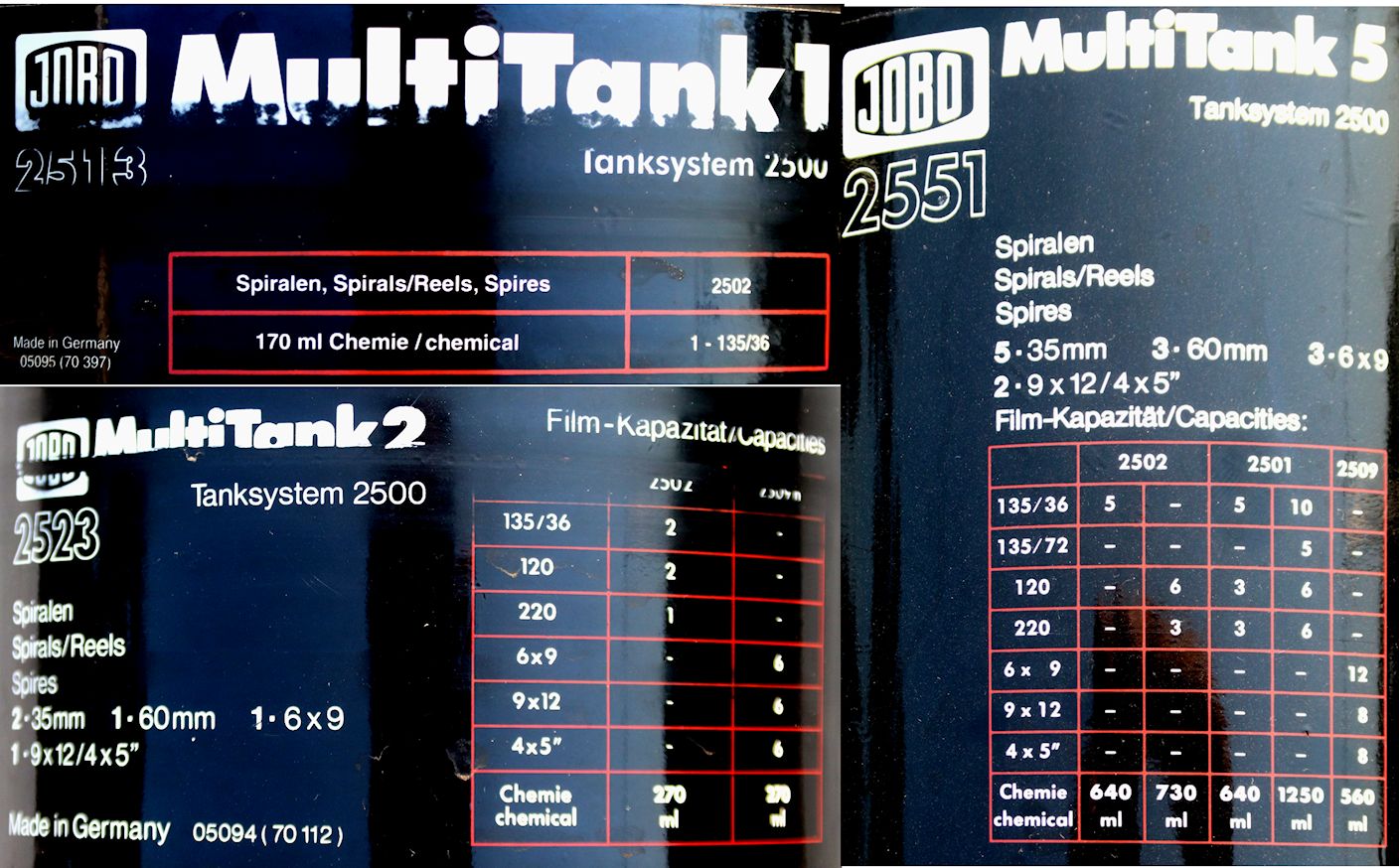

Neal
Dec 3, 2004
2,027
Chicago, West Suburbs
Photos of my tanks.
