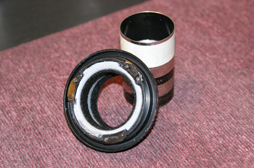

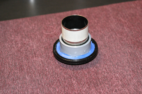

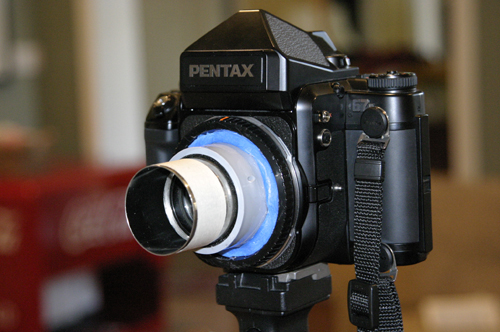

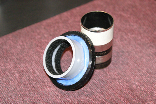

I bought a Pentax 67 bodycap, a piece of plumbing something or other from Home Depot, the fuzzy side of some velcro strips, some tape, and after a little dremel tool action, voila!
I focus by simply pulling/pushing the lens in and out. It focuses from infinity to about 2 feet or so.
See the attached pics with a preliminary of one of the first images. I'll probably not get any of those elusive swirlys, since the image circle is probably too big for the 6x7 format, but I like the result so far.

Wow! Too cool for school. What was the thingy that you put the felt strips into? Gorgeous result and it can't get any better than focus ttl. Bravo! I better hound the little green guys to find me some more of those! The photo is perfect in 6X7.

I'm not sure what the thingy is. I found it in the plumbing section. It is plastic and about 2 inches in diameter and has a flange on it. I had to put the dremel tool to the flange to make it fit into my bodycap, and glue the two pieces together.
The lens fits perfectly into the velcro lined tube. No damage or modification to the lens is required at all. I put some masking tape around the lens "hood", in order to give me a visual limit for pushing it into the body of the camera (ie, if I push it in too far, the mirror hits it). This is not a problem, as it focuses at infinity before the tapestop is an issue.
The lens fits just snug, but slides perfectly in and out of the tube. It just couldn't be any better.
