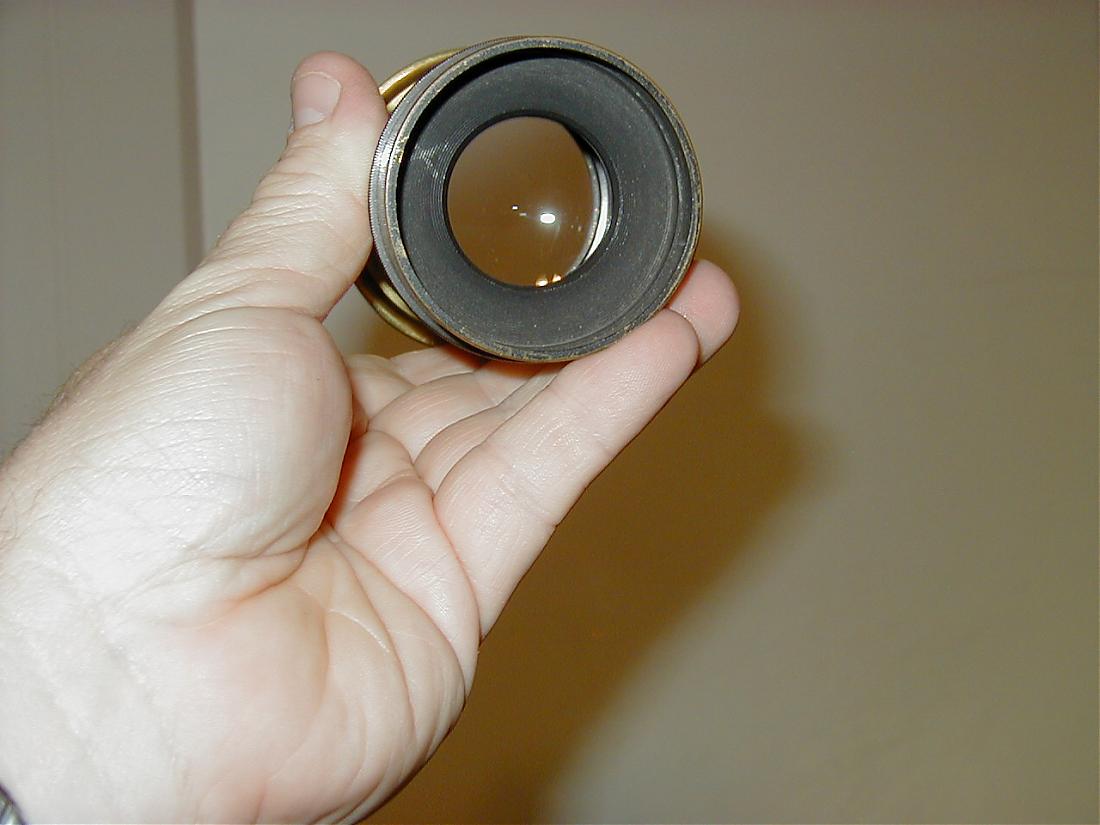

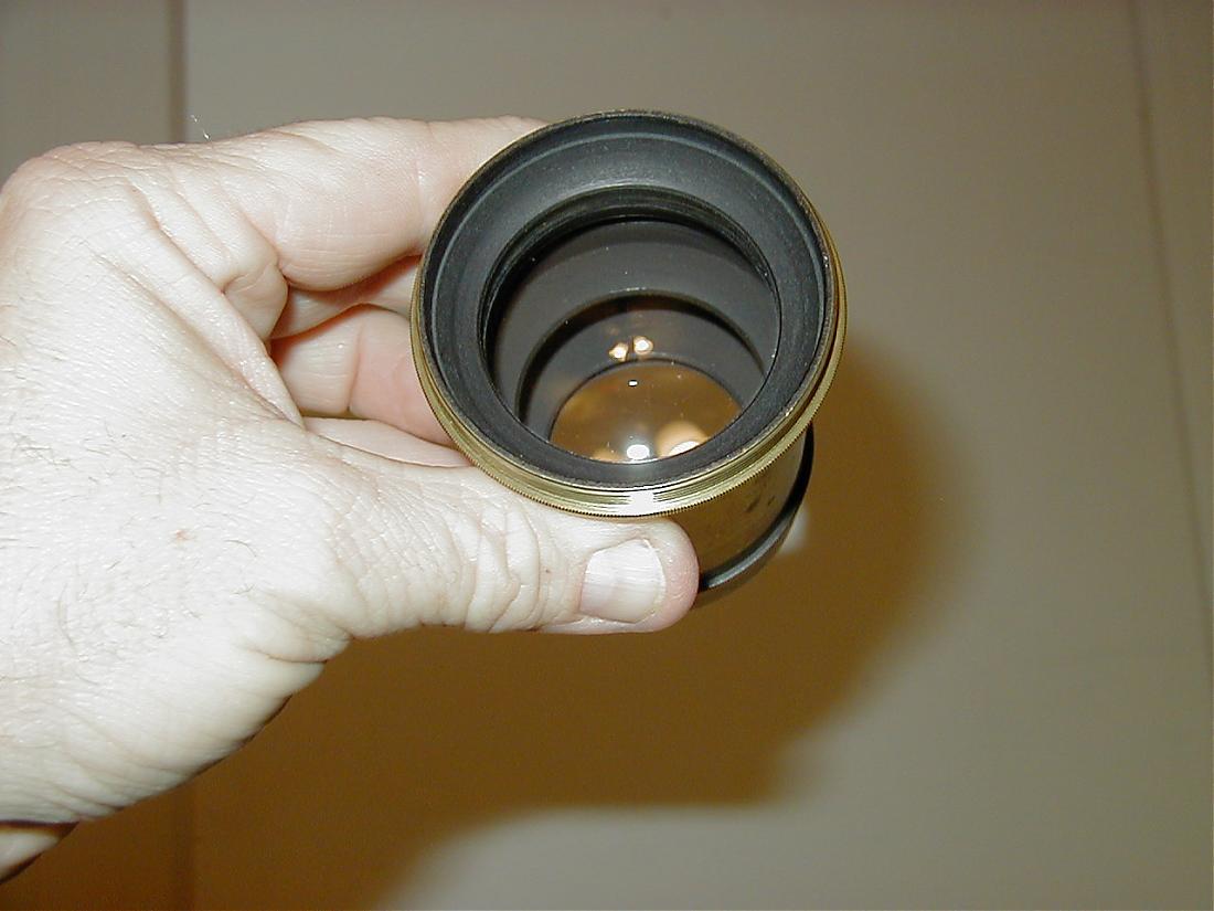

Can someone advise me whether or not my JH Dallmeyer Rapid Landscape LF #2 barrel lens (ssn 49244) is missing a set of lens? My lens only has a rear set of glass (possibly 2 separate sets, not certain), the barrel is just shy of 3 inch, waterhouse slot near the front of the barrel. The lens covers 8x10 on th V8's gg, but definitely softens from the center. According to my calculations, it is about a 13 inch lens with a f11 aperture. Any assistance is appreciated.

Generally a "Landscape" lens means a cemented achromat. In this case your lens should be (as I recall) a three element meniscus type lens. Coverage should get about 50 degrees at f11, and goes up to about 90 degrees stopped down further.
So no, you aren't missing anything.

thanks JG. Appreciate your assistance and confirmation. JW
