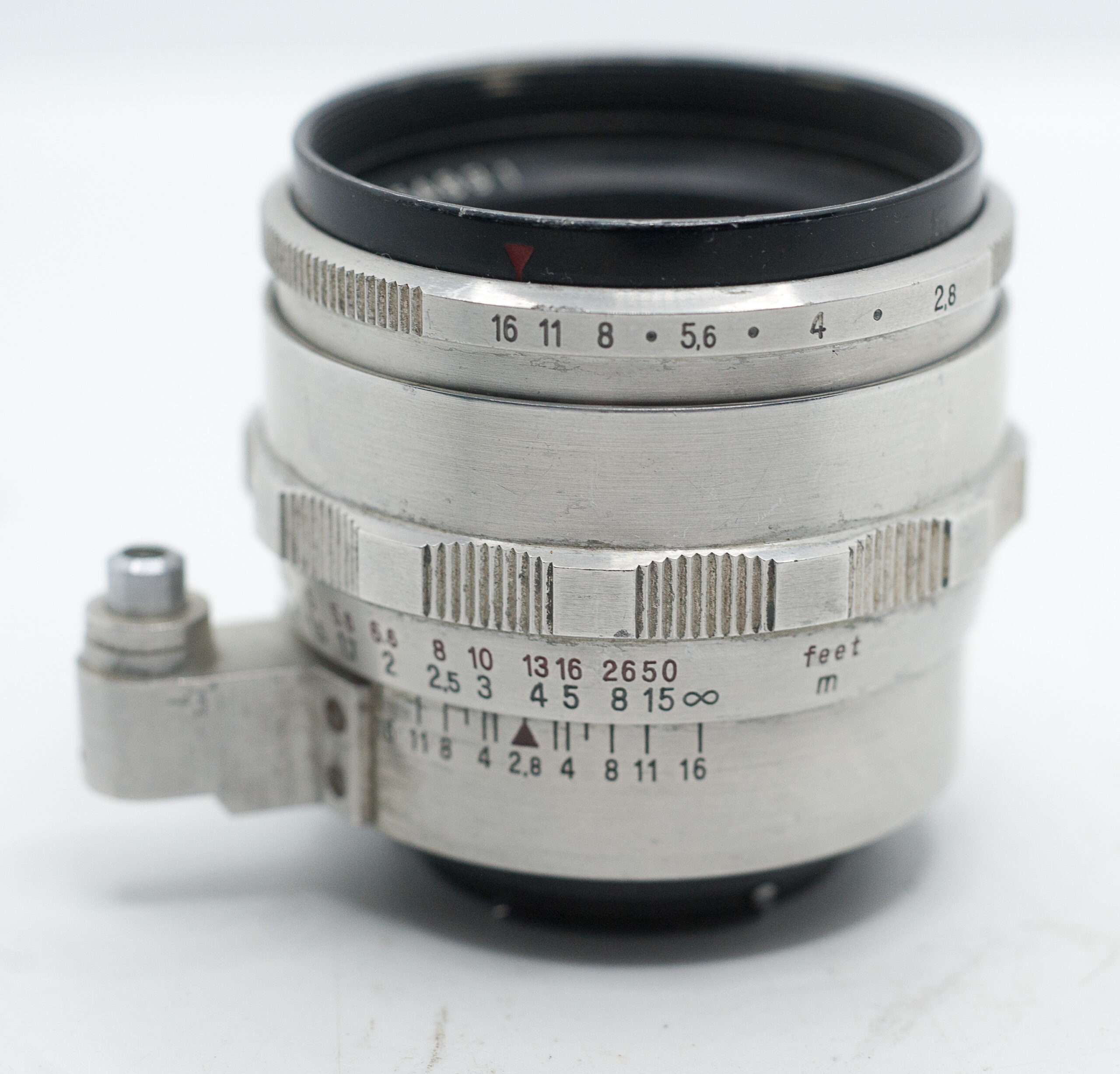

Hi all,
i recently bought a beautiful jena-tessar 50mm f2.8 exakta mount lens. The lens work fine, except for the fact that the focusing helicoid is stiff as all heck. I’ve done some work on lenses and cameras before, but those were all cool-if-i-fixed-it-whatever-if-i-don’t situations. I’d rather not ruin this lens by taking it apart and not being able to put it back together properly.
Tl:dr-> I have to get to the focusing helicoid to clean and lubricate it. I do not know how, and what to watch out for.
Does anyone have any good insights/guides i could follow?
Thanks in advance :smile:
