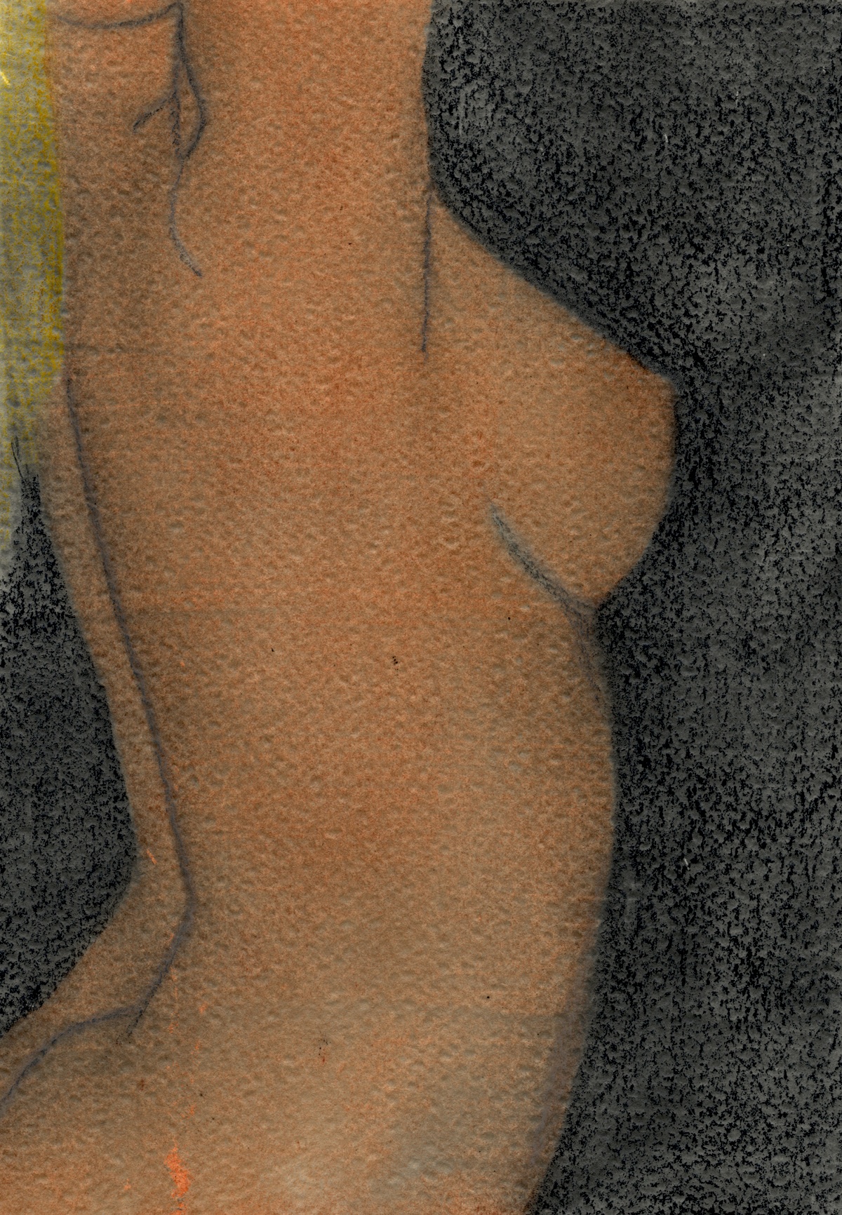

I'm using liquid emulsion on rough Fabriano Artistico paper. I don't use gelatin, for the reason both you, and Clive, mention. After printing, I'm using oils and pencils on them, and want the texture to be a part of the image:
