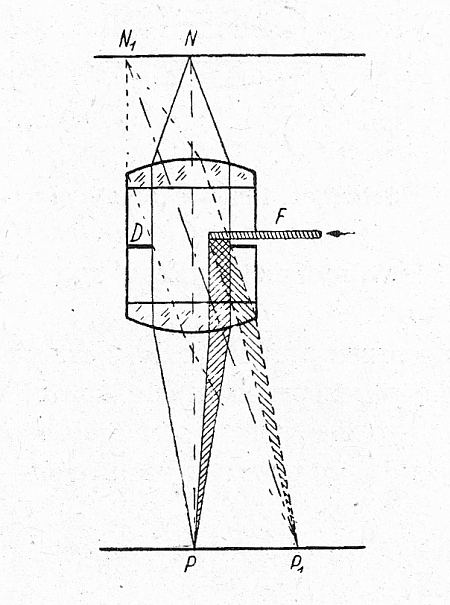

I am asking a theorical question or if you want to answer with numbers , examples , here is your chance .I was thinking to control colors of my photographs and Our ic-racer pointed JanPol lenses.Here we simulate the lens and the MF Back Camera. What would I see when viewing from finder if I rotate the controls ?Strange color combinations or increasing of red , ...? Could you please describe me ?

The filter, marked as F is situated over the aperture, marked with D letter.
From the N point exits a divergent ray of light into which you insert the filter.
After exiting the lens, rays focus on the positive in the point marked as P. These
are filtered (the lined area) and non-filtered rays. The intensity of the colour
of the positive depends on the ratio between the filtered and non-filtered rays.
A similar light path from the N1 point to the P1 point proves that the whole
image projected on the positive is equally coloured and the degree of the
colouring depends on how deep the F setting point is positioned. --- http://www.lenstip.com/index.php?art=132

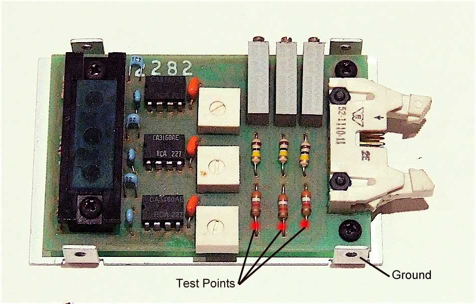

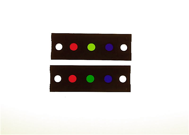

Theoretically all colors. You can use graded levels of Yellow, Magenta or Cyan individually or any combination of TWO. Not all three together, but that is OK because all 3 together is just neutral density.
A system for sensing color is simply three 'standard' photodiodes each covered with a little color separation filter (special fade-resistant Wratten is best, but not available in green as seen in the lower picture of the faded green Wratten filter). Many color densitometers and closed-loop computer controlled color enlargers use that method.
