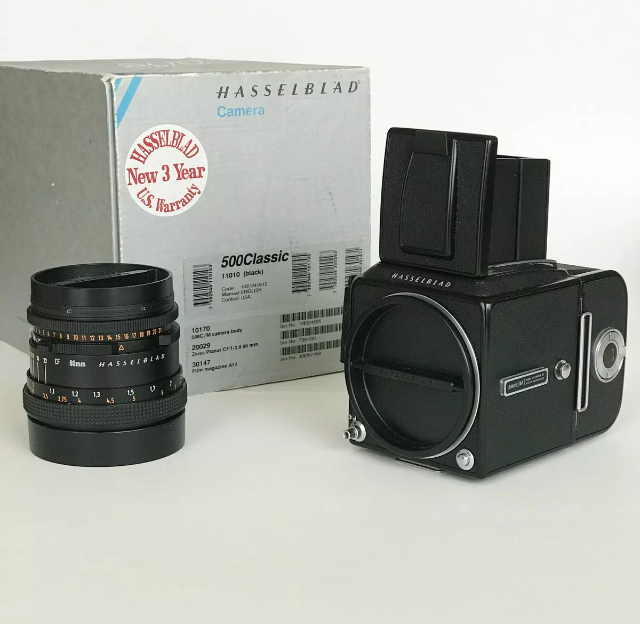

I know we all love relaying stories of jammed hassies...I also understand it rarely happens unless you have no idea what you’re doing, and you try to remove and re-attach a lens to an uncocked body/shutter. So, here’s my dilemma.
I recently bought a barely used 500cm classic kit off the bay. A day or two after purchase, I messaged the seller and asked when they were planning on shipping it. They responded that they “accidentally got the lens stuck on the camera “, and were trying to take it off before shipping it. Odelay!!!!
I convinced them to bring it to Hasselblad in NJ (they live one town over), and let a technician handle it.
My fear is that they’ve damaged something internally by trying to force the lens off. Have any of you experienced a Hasselblad, either body or lens, needing repair after a particularly bad jamming experience??

I don’t understand the premise of this thread... story telling or addressing your “problem”. The former bores me so I’ll address the latter. Tell the seller that given the circumstances you want your money refunded. Find another to buy.

Jim- I appreciate you sharing your experiences. I had a similar experience with my first 500c about 25 years ago, which led to me selling it, and the slew of lenses I had collected up for it.
The camera in question now is what looks to be a very original, lightly used and well cared for late (‘94?) 500c/m “classic” kit. I believe the seller, and I’m not trying to be sexist here, is the wife of the original camera user. So, either one of them could have jammed the lens. I don’t think the camera is a lemon, just in the hands of someone not experienced with hasselblad’s quirks. My main concern, is that there might be internal damage from someone trying to force a jammed lens off the body-

One would have to work darn hard to forcibly remove a jammed lens. Probably using tools. If it works after a proper unjamming then chance of residual internal damage is unlikely. But even a “relatively new” 500 C/M might benefit from a good professional overhaul to ensure proper operation... but you probably know that already. :smile:

The seller contacted me today, and fessed up that the lens was not only jammed on the camera, they somehow have it cocked at an angle as well. They told me they could hear snapping noises as they tried to twist it. Yes...I’ll take that refund please.
Such a shame...it was an exceptionally clean late 500c/m...
