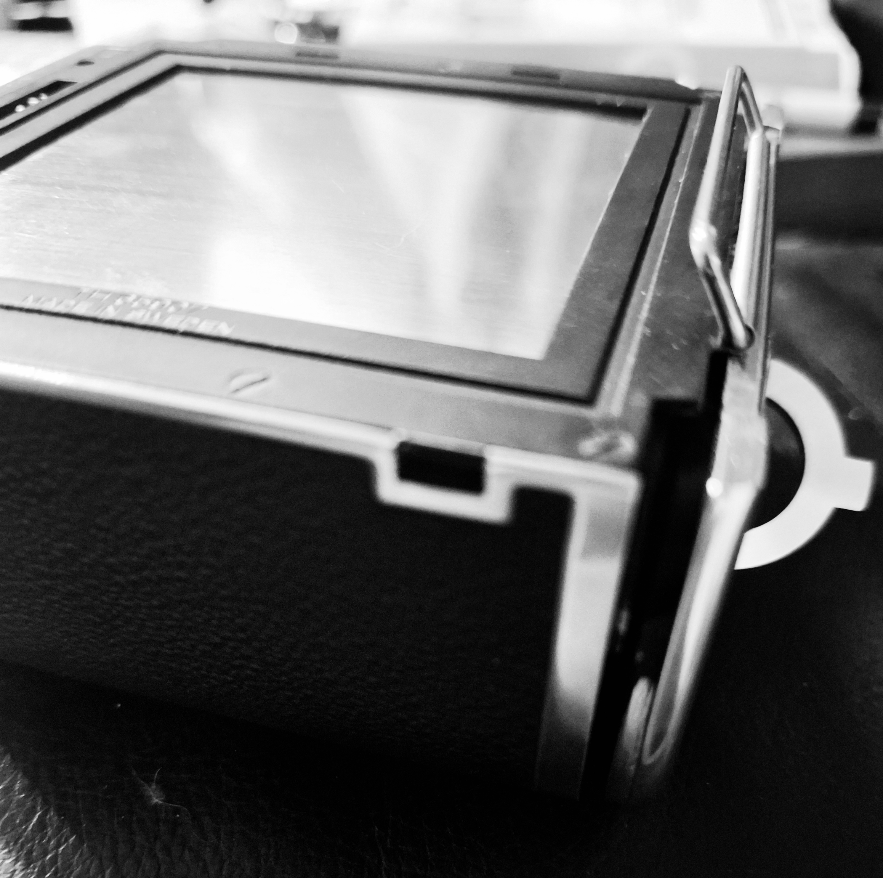

I have experience with the camera. It has worked properly before. Thank goodness I have a functioning C12.

Try two things. Remove the dark slide and give the insert a jiggle as you attempt removal.

So what seems to have been the problem: jammed sealing tape or a loosely rolled film?
Or did you mean film on top of clamp (it should be under the clamp, normally).

Finally got it. Loosely rolled film was the culprit. I had to use a screwdriver to push it down while I jiggled the tray. Whew! Now I'm going to run an old roll of film through it to see if anythings mucked up. Thanks to all who answered!!
