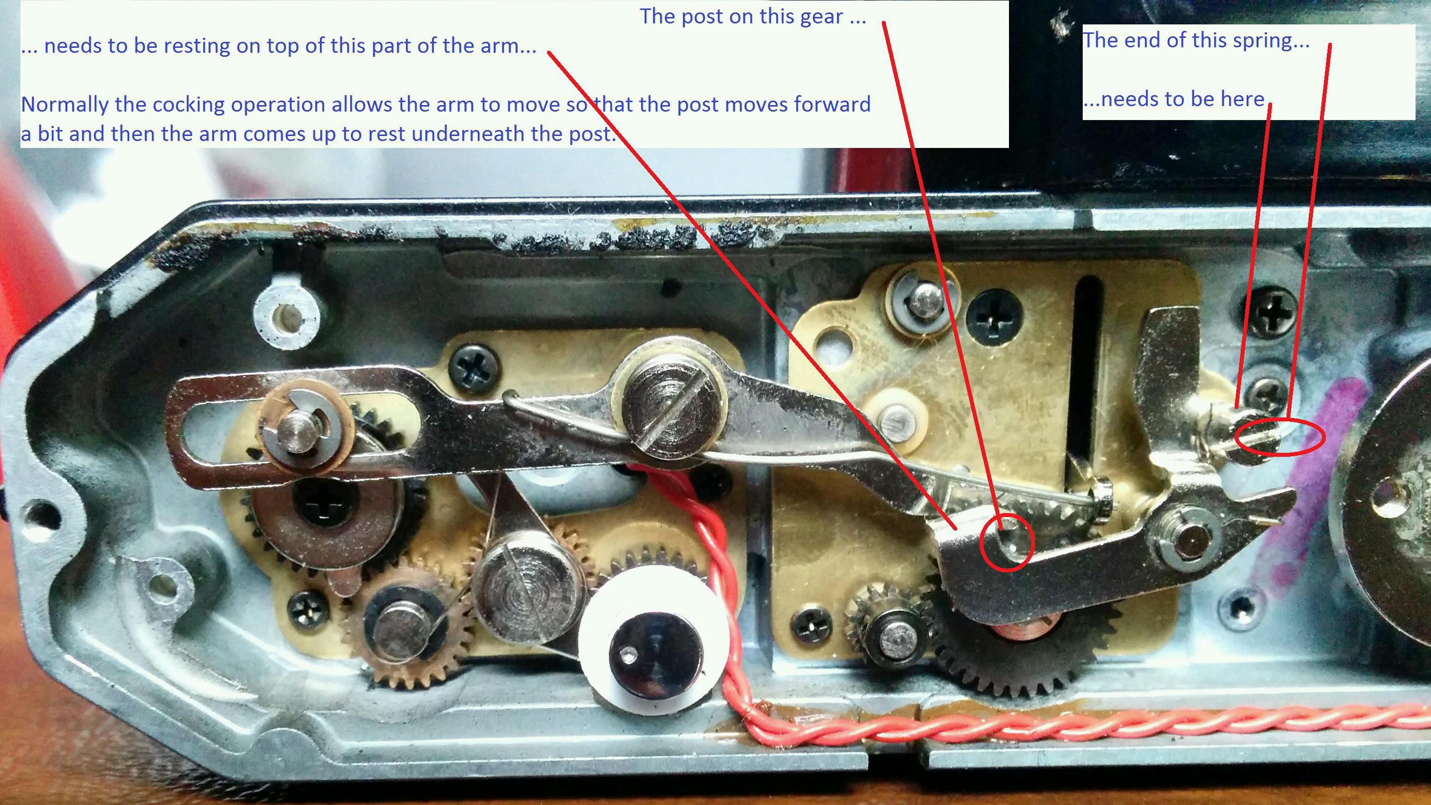

My K1000 jammed. The Fix Old Cameras trick did not work. All the levers inside don't move anymore. Here's the photos of what it looks like.
Any clue? I have another K1000 as a backup so while I would spend time trying to fix this I would not send out for a CLA

Ok, I see a few things wrong that you may be able to correct. I'll try to edit your photo to illustrate. Otherwise, I will have to experiment this evening with my "repair-demo" K1000.

Here is what I see wrong:
The arm is way to the right, but it seems like the post on the gear is preventing it from returning to its normal position.
Normally, when the shutter trips, as the second curtain closes the gear (and post) rapidly turn clockwise. At the end of that rotation, the post hits the arm which causes the mirror lever to fall.
However, since your shutter is cocked (based on previous discussion), it puzzles me why the post is still under the arm and not resting on top of it.
Gently, without using your fingers or any breakable or sharp objects, can you get the gear or arm to move at all?
I will experiment when I get home tonight, but I suspect the arm may have to be removed so that it can be repositioned.

Nothing wants to move. I await further instructions. I'm unsure about removing the arm but no biggie, I can always try. I'm a bit unclear about that spring and where it should be though.
Nothing wants to move...
The end of the spring, circled in red, appears to be resting on top of its post. The end of the spring should be moved "up" (that is, in the direction of the top of the photo) so that it rests against the post.
Press and hold the shutter release and then, if you can, carefully raise the mirror (don't touch the surface), keeping it raised all the way (the mirror reaching the top of its travel is what really trips the shutter). If successful, this may get the mechanism back to its normal state.
The cameras released. The lever in the slot will be at the top of the slot and held in position by the flattish section of the lever to the right side.
If Theo is right and the spring has jumped the post, move the spring and move the lever from the bottom of the slot to the top
then release it. That may allow it to free everything up. Or maybe not.

He tried that initially (in a thread prior to this). Now none of the levers move but the shutter is cocked.
Therefore I'm hoping my lift-the-mirror suggestion above works.
Nope on the lift mirror.
Rats. Ok, the only other thing I can think of is to view the service manual (see Ron Paul's post #9) where the mechanism is described early on (pages 8-10). Once you remove the E-clip, the mirror-catch arm can then be removed and positioned correctly.
One thing that bothers me is the position of that mirror return gear. When the arm has been removed, be sure to test whether the shutter is indeed fully cocked.
