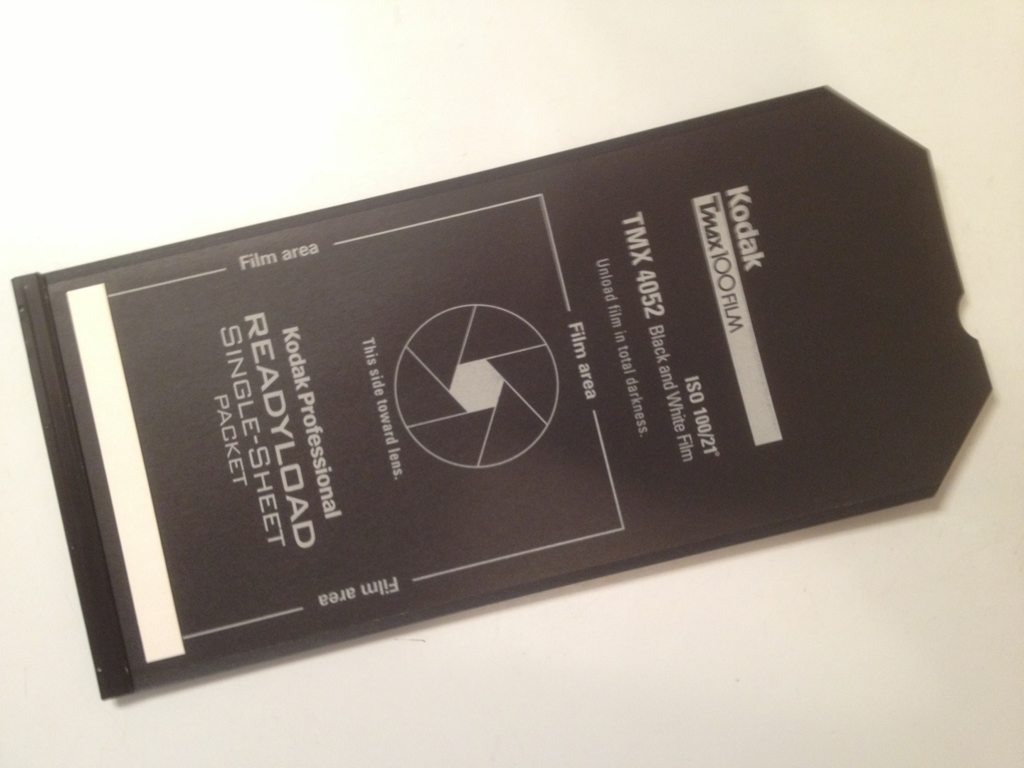

I was going through a small box of stuff that came with my camera, and I found a box if these. It was a box of 20, and there were 16 left.

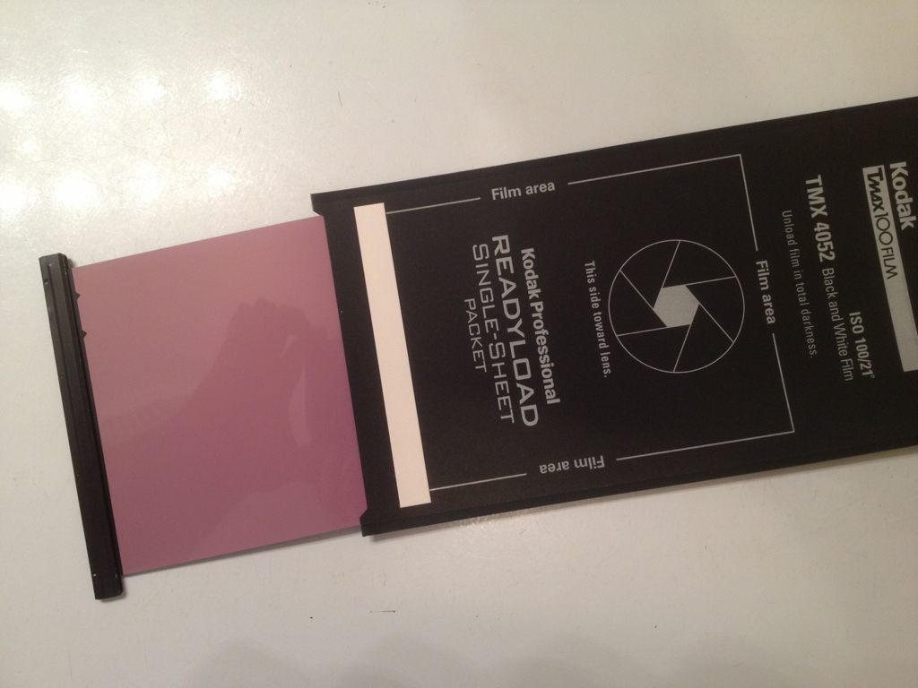

So I sacrificed one to see what it was. I actually thought it was ancient instant peel apart film. I soon realized that it was actual film in a convenience pack. The expiration on the box was 2001.
Then I realized that I could take it apart quite easily. So I took two apart and put them in the 4x5 fidelity elite holders that arrived this afternoon.

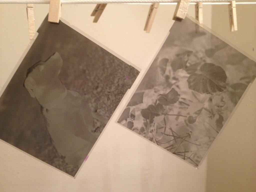

What else is there to photograph in the back yard but the dog, so that's what I did. I put the SG on the tripod and begged and pleaded for the dog to hold still. He obliged. And then I shot a flower vine that is growing on our fence! Developed them in XTOL, and this is what I got!
My very first two 4x5 photos taken with a 70+ year old camera!! And my first two 4x5 photos ever!!
I'll scan them later on, but I'll have to piece them together because I only have a V500. Tomorrow I'll try contact prints.
They look a little thin, but I don't know if that's underexposure, age of the film, or problems with the camera - but I'm certainly excited to continue experimenting!!

Both of those are printable. Believe me I have exposed and printed far worse exposures.

I was going to point this out too--- for a first effort with LF and unknown film--- very nice. Also nice to see someone with some serious enthusiasm...LOL Have fun there.

To me, T-Max 100 always looks thin when shot at 100. I expose it at ASA 50 for better density. And those are readyloads, you can shoot them without holders in a Polaroid 545 if you have one.

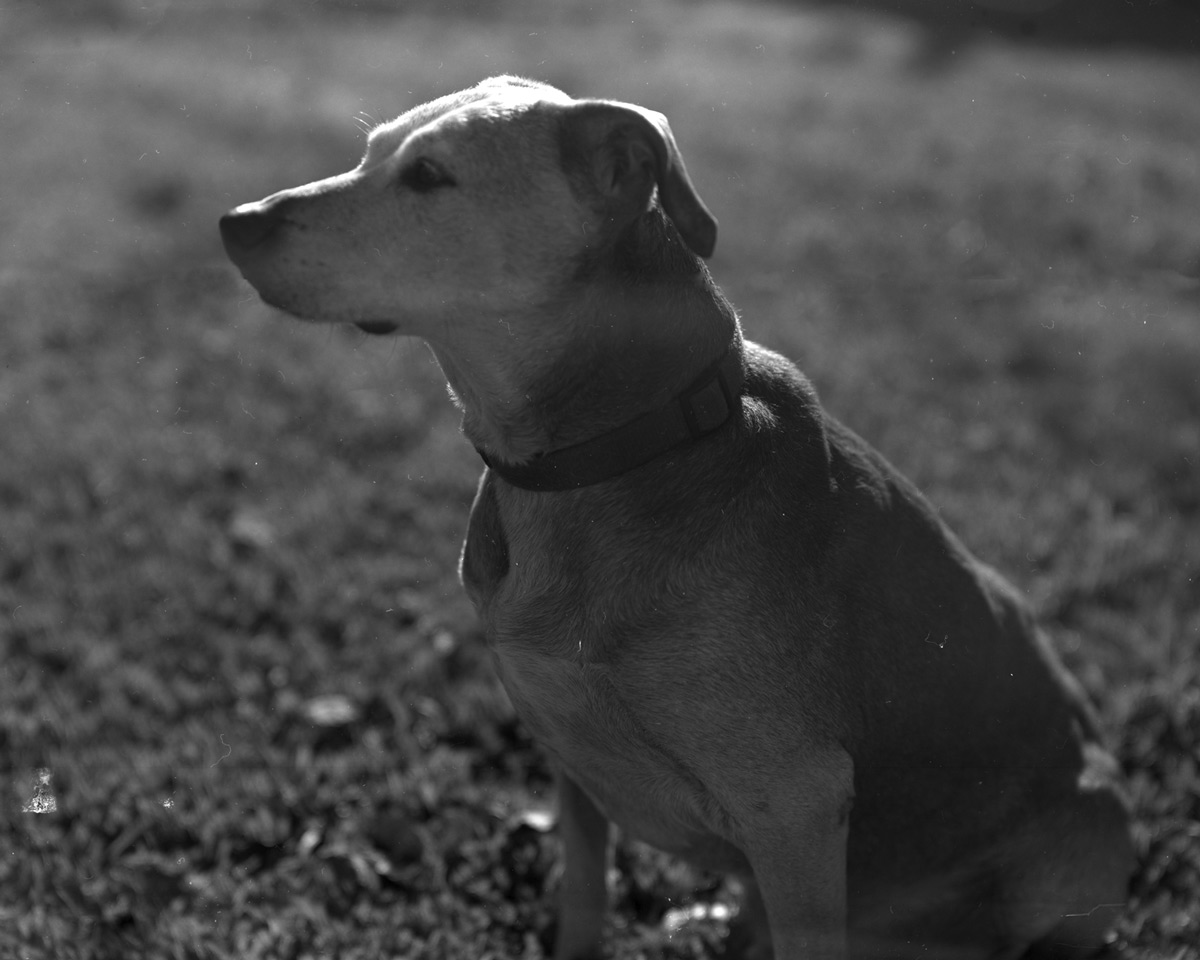

Well here is a quickly scanned, and pieced together negative. I'm thinking its at least 2 stops under exposed, but I still can't wait to go into the dark room tomorrow morning and try to contact print it. Most of the dust is from the very dirty scanner bed.

The dog isn't underexposed at all, note that there are no clear portions on the negative where detail has been lost. You don't want any more exposure than that or the highlights will get flatter as they shoulder-off.
The vines likewise look like they probably have enough exposure but they could possibly use a bit more development (I guess it was flat light); another half-stop might get some of the shadows off the toe a bit.

If you want a holder for the film packets, I have an extra one I could send you for the cost of shipping. This way, you don't have to take them apart and risk dust getting on the film before exposure. PM me if you're interested.

Maybe a tie. I like your enthusiasm. Don't get carried away with more development, it makes the negatives harder to print. Those negatives look pretty darned good for your first efforts and using outdated film.
Get some real film, somewhere in the 100 to 125 speed range and perfect your development technique. And... go out and shoot. Lots.

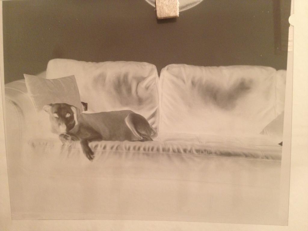

I ordered the Arista box and took my first 4 photos today. MUCH BETTER negatives this time! Shot these inside, f4.5 at 1.5 secs. I'm hoping to contact print them later tonight or tomorrow.
