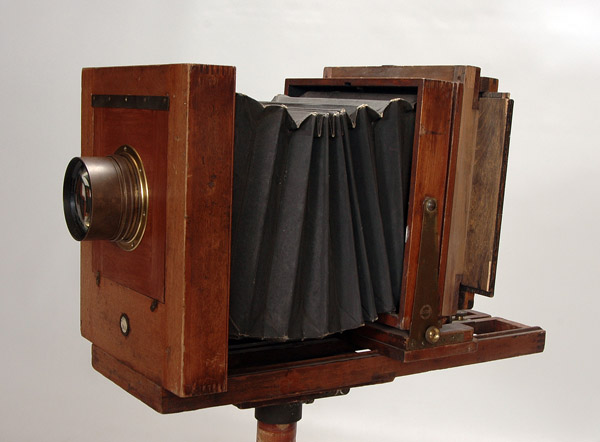

So I run a digital studio in Orange Park FL, and when we acquired the buisness 6 years ago, it came with all interior fixings. In the attic was an antique 8x10 large format camera... it has a few markings, and appears to be in decent condition.

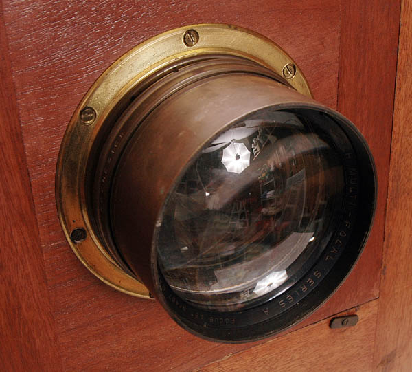

From what I can discern, it is a Wollensak-Rochester No.6 ? Does this sound correct? It also has a "beach multi-focal series A " lens on it with the inscription
"beach multi-focal series a focus 16" no 487 made by wollensak-rochester usa pat appl'd"
the aperature appears to still work, with the action being very smooth.
the stops are labeled 6,7,8,9,10,11 and 11.7
overall the whole camera is in pretty good condition. can I still use this camera? the rear slide mechanism still works but there is definatley something missing...
how much is something like this worth? I can post pictures if anyone is interested.. thanks for your time... -b

Post pictures. It would be interesting.
If it's all there, it's usable. The bellows may have leaks, but that can be patched if it's not too bad, or replaced if necessary.
The lens may be worth something, since it's a historic soft-focus lens. The number series may refer to the soft focus settings, rather than the stops. I forget if the Beach Series A is an adjstable soft focus. There is probably a description of the lens in the documents on cameraeccentric.com.
The camera is not likely to be worth as much, because shipping is usually difficult with these studio cameras, so it's worth more if it's, say, in New York City where there is more local demand for unusual cameras.

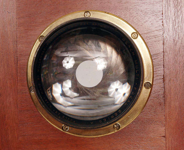

Pictures would be helpful. Absolutely useable. That Wollensak Beach 16" is a very desireable lens. The numbers are the aperture scale and I've yet to find the literature that describes the wierd system but you would find 11.7 = f4.5, 11 = f5.6, 10 = f8, 9 = f11, 8 = f16, 7 = f22, 6 = f32
Hard to make any $$ with it because they are from an era when the value of time spent is quite different from now.

Having just purchased a Beach Multi-Focal lens, I have some information given to me. The 16 in. No. 7 model covers 11x14. It says, "For those who prefer a soft focus effect in portraiture, the Series A produces a pleasing quality that almost entirely eliminates retouching and the smoothening processes.

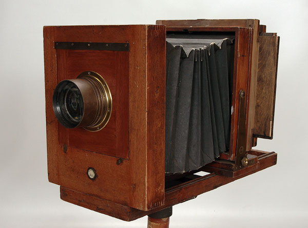

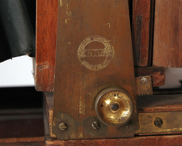

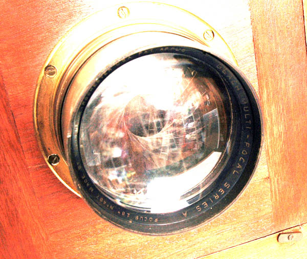

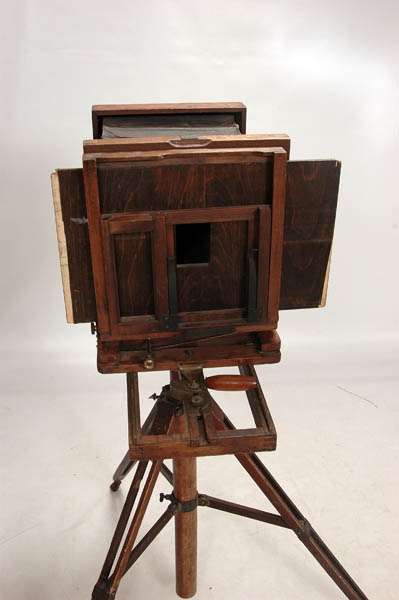

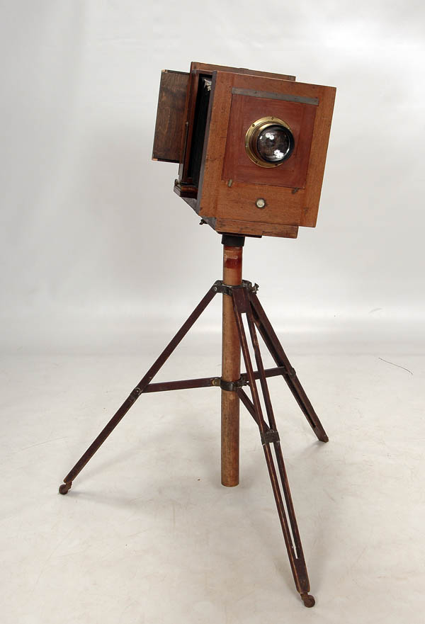

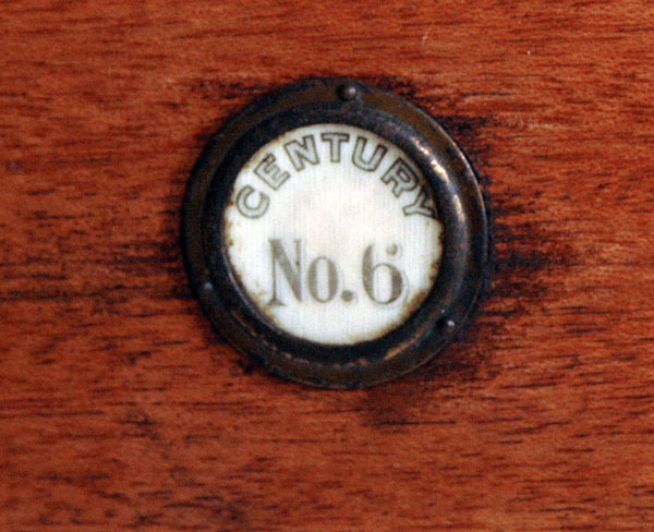

attached are the requested photos...
badge1_lores is on the front of the body
badge2_lores is on the side of the focus mechanism
lens2hot_lores i took the curves way up to bring out the engraving on the lens itself..
lens3_lores shows the aperature mechanisms (and quite a bit of reflections, its been a long day..)
and the rest are fairly self-explanatory...
the bellows definatley leak, as there are holes in the majority of flex corners
thanks for your help

So the camera is a Century No. 6.
The back looks like it's designed to take other backs of different sizes and has some sort of movable masks for taking multiple shots on a single sheet of film.
To make it usable, I suspect someone would just remove the back and build a back to take modern filmholders. The maximum size is probably 11x14".
The lens looks great. You could get good money for it on eBay or here in the classifieds.
The camera is going to be a hard sell, since it doesn't have a terribly workable back, is heavy to ship, and needs bellows replacement and a certain amount of general restoration. You could keep it around for ornamental purposes, either on the stand, or some people turn them into coffee tables by putting them on the floor with a sheet of glass on top.

That back looks like it was designed to take 4 vertical shots on a sheet of 5x7 film. This "multi-shot" approach was quite popular for portrait photographers. A way of economizing film use. More common was the sliding 5x7 back that took 2 images per sheet of film.
