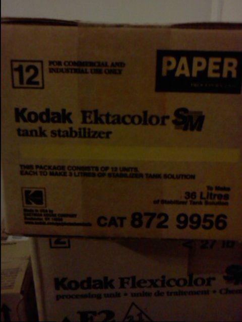

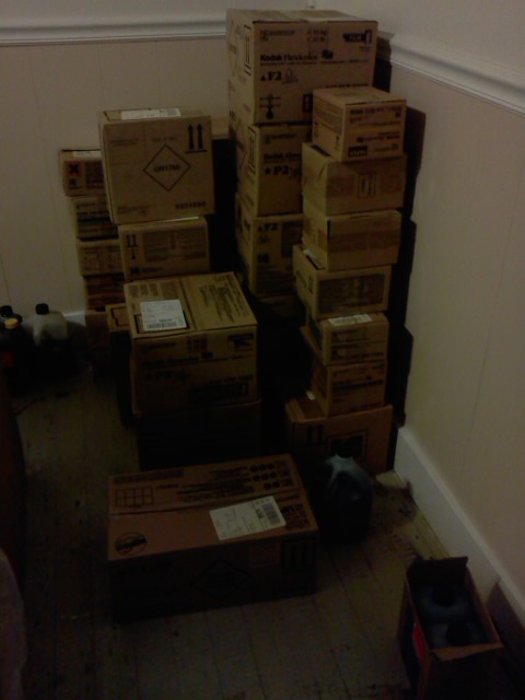

Like a pallet full of stuff. It's all chemicals, no paper or anything. It's all still sealed in boxes and it shows that it was shipped between '03 and '05. Is it possible that it's still good (it was stored in an air conditioned building)? And do you think there are people who would use it?

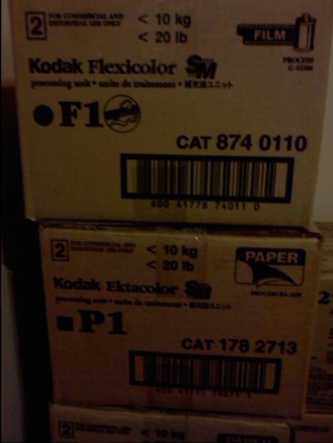

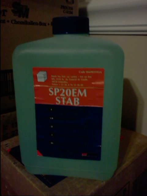

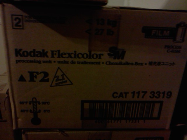

It's mostly Kodak stuff. I only bought the stuff because I thought "I bet some APUGers could use this." The only problem is that it would be a pain to ship. It could be done, but I'm hoping someone in Florida ñeeds it. I'll have to check tomorrow what everything is and open the boxes to check for discoloration and sediment. I'm storing it where I don't live so I can't get to it tonight. I've attached some pictures I took earlier.
Sorry the pictures are sideways. They looked fine on my phone but my phone has been acting up lately.

From what I can see these are mostly concentrates for minilabs.
The F cartridges are C41 and the P are RA4.
Yeah they all say for industrial /commercial use. Is this type of thing useful to people still? I called a couple smaller labs, but they (understandably) declined.
