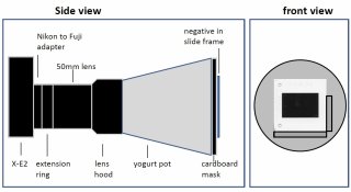

But now I'm back on the analog track. It started by thinking about an efficient way to digitalize my old B&W negatives. I found an easy and low cost solution as follows:
I own an Fuji X-E2 and (among others) a Nikon 50mm F2 Ai-S with an adapter. After purchasing an extension ring an a metal lenshood, I attached a plastic yoghurt pot, which was conneted to the lens hood (fits in perfectly without glueing. A cardboard mask was attached to the open side of the pot. The mask is notched with a 4x3cm hole so that I can put on framed (slide frames) negatives. As a light source I use the overcasted sky, which turned out pretty nicely. (see attached image)

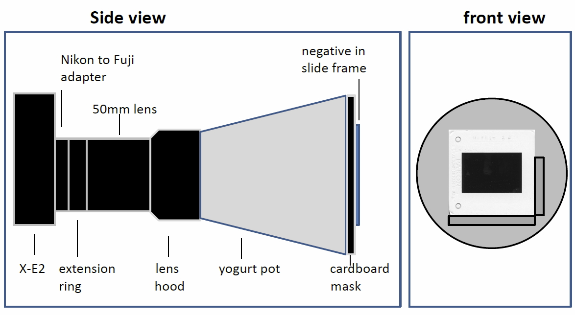

@Hatchetman: This is a sketch of the setup. I'll provide the photograph of the real thing later.

Thanks. I will see if I can replicate something similar. Your digitized negatives look better than those from my cheap scanner.

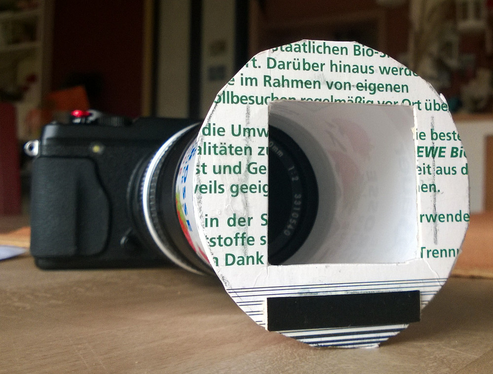

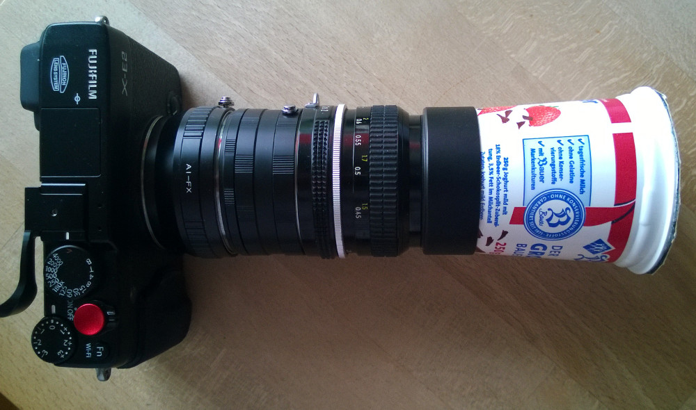

Here's the setup. Simple but effective.
Sorry for the bad quality. Images were shot with my smartphone.
