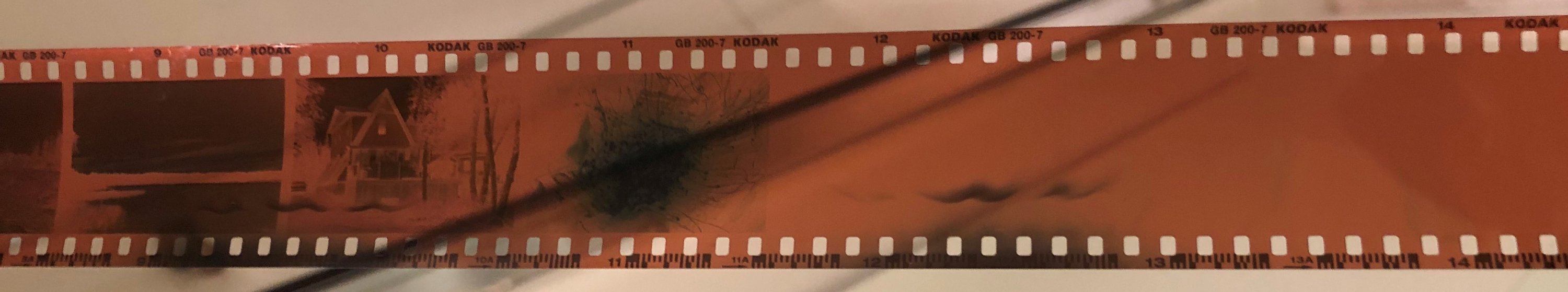

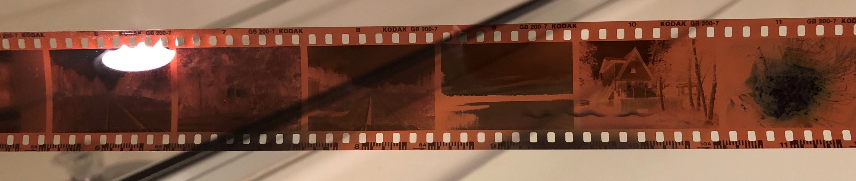

Hey guys! I've decided to post my questions here after getting tons of help from other threads here found off google in the past.
I've recently started to get into C-41 color film, and am developing it myself. However, previously I had only ever shot and developed expired film (~20 years out of date, not refrigerated). This is now my second roll of non-expired film I have developed, and it is Kodak gold 200, nice and cheap. The first roll I developed slipped off the reel in the tank, which lead to as you may imagine, bad results. With this roll, I had issues getting it onto the reel in the dark, but once it was on there was no issues. I blocked the exit of the reel with a piece of plastic, so the same thing as last time wouldn't happen.
A number of issues occurred when developing:
One thermometer was used to measure both the temperature of the blix and developer solution, and there may have been cross contamination, but not much. I'll be running a few test frames to see if the developer is completely done. However I had divided my working solutions in half, so I used the known good other half for this roll
On the edges of every few frames, there is a dark spot. On some shots, this overflows into the exposed area. It is worst at the end of the roll that was exposed first. (see exposures 12 and 15 on 0.jpeg, the first image)

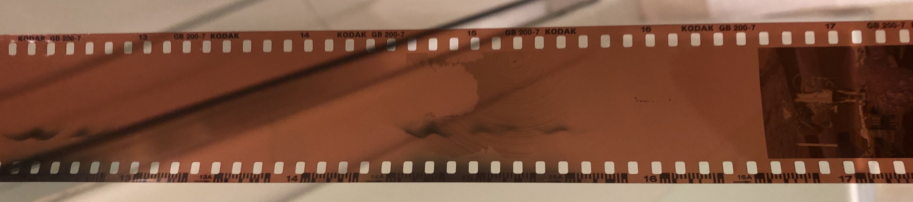

The other issue is these weird wavy lines on approximately half of the roll, see exposures 9, 10, 12 on the images below, or 15 above)
My apologies if the images above imbed poorly, I've never used this forum software before. Also, the dark lines are on the wall I'm using as a lighting source, its the best I have right now.

What could have caused the wavy lines?
This has not happened on any other roll, no part of the process was different, other than it being a new type of film(from amazon), and no other roll has has light leaks or other issues. Photos shot with a Canon EOS Elan II.

Looks like a light leak to me. Coming from the cassette cap being opened where there was still light in the room. Cell phone in the darkroom with you, lighting up on its own while handling the film? Smart watch in the changing bag? Or possibly a problem with the top of the camera's film door...
knotimpressed
Aug 28, 2020
16
Canada
Both darker spots would be caused by that?
I made sure to put my watch in my pocket, and put my phone on do not disturb, but that could be an issue. I'll check the film door too.
Are you sure this would have happened while on the roll? The length between the spots seems to somewhat line up with the circumference of the film reel, but I haven't precisely checked.

An edge leak like that could affect multiple frames, where the film layers one on top of the other (consecutive turns on the spool), either in the dark bag/room or in the camera. If film door, most likely it's at the take up end, since you have the same on multiple frames about one spool turn apart. Another possibility is that a leak on the straight part of the strip could repeat when the camera sat for longer between advances, and be less noticeable (even invisible) where you shot multiple frames in succession. That won't necessarily have even spacing.
If it lines up with the film reel, then it has to be in the dark bag/room during loading, or tank didn't get correctly sealed, or something of the sort happening before or during development (not afterward, fogging later wouldn't get developed, just fixed away).

Excellent, thanks for your help! The light seals on the camera are not foam, they're just hard plastic, similar to the light locks on some developing tanks. I use a very old developing tank (1960's), and a windowless bathroom, so I'll check if the light leaks line up on the reel. I also left the film to sit in the tank for longer than normal while I troubleshooted a thermometer, so there was a greater chance of light leaks having an effect.
Edit: The light leaks line up in the tank, and they face the top of the tank where light may come in. One half of the light lock may also jostle loose, I'll make sure to check next run, and perhaps not have as bright of light on the tank, as well as have less time with it sitting in the unprotected tank.

If that 1960s tank is Bakelite, it might have a crack that can fog film directly beneath it, but be quite hard to actually see. Most modern plastic tanks are made of ABS or polypropylene, which are much more resilient than Bakelite.
A brand new Paterson tank, including a single reel (holds 35mm or 120, depending on adjustment) is around US$40 here; if it seems possible you've got a cracked tank, that's what I'd suggest as a replacement.
Well crap, its hard black plastic and it looks pretty close to other samples of bakelite I have. I'll see if I can find any cracks and what I can do about them, I could buy a new tank but they're 70-80 CAD here, and long shipping times, if in stock at all. I probably should get a new one though.
