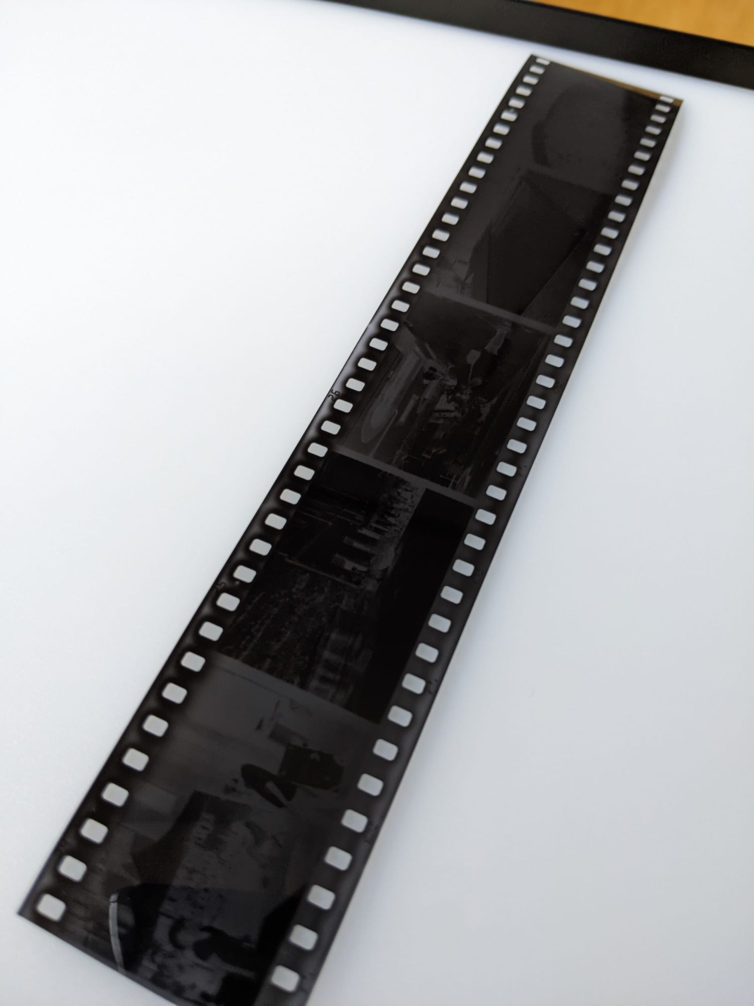

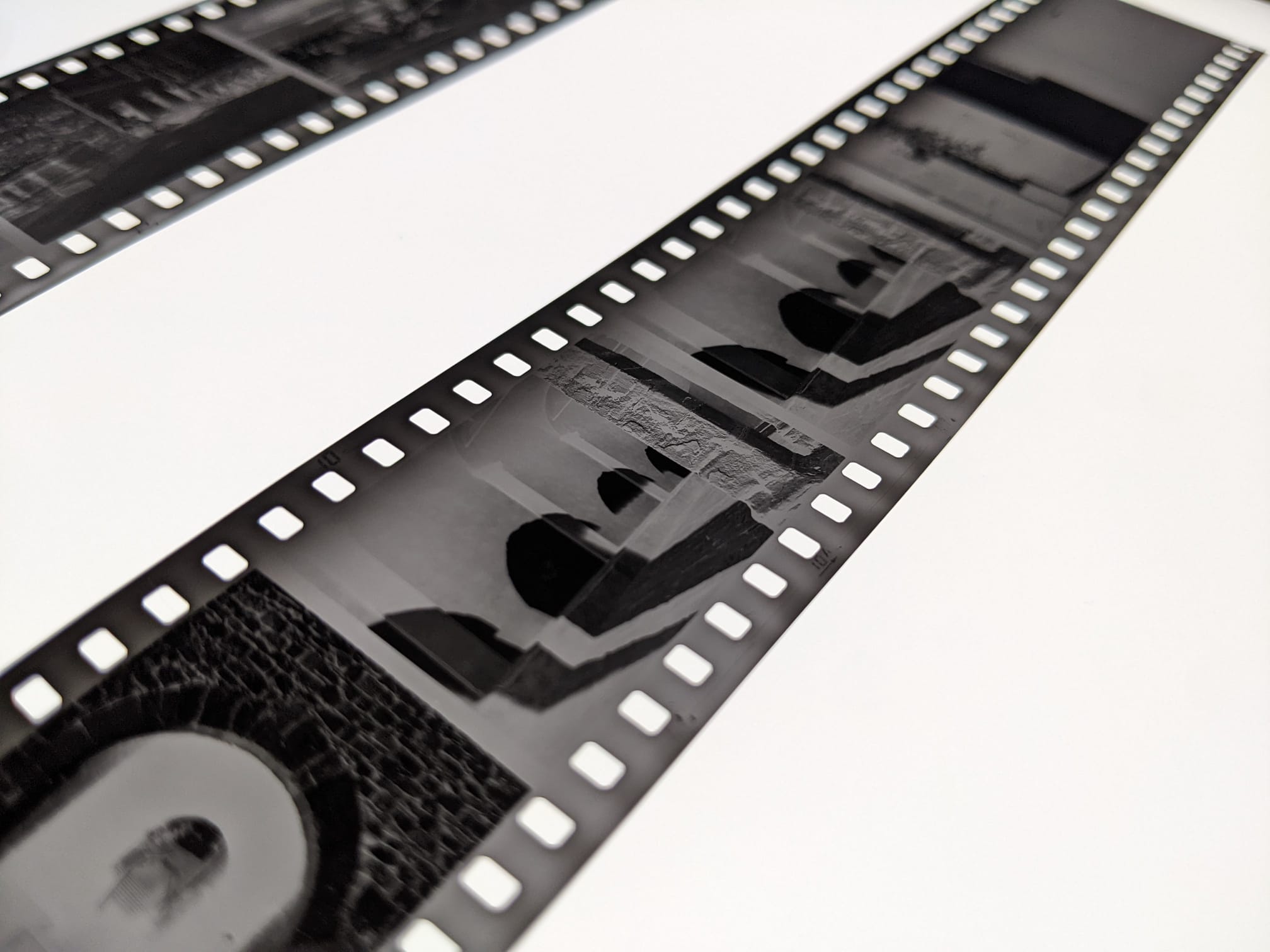

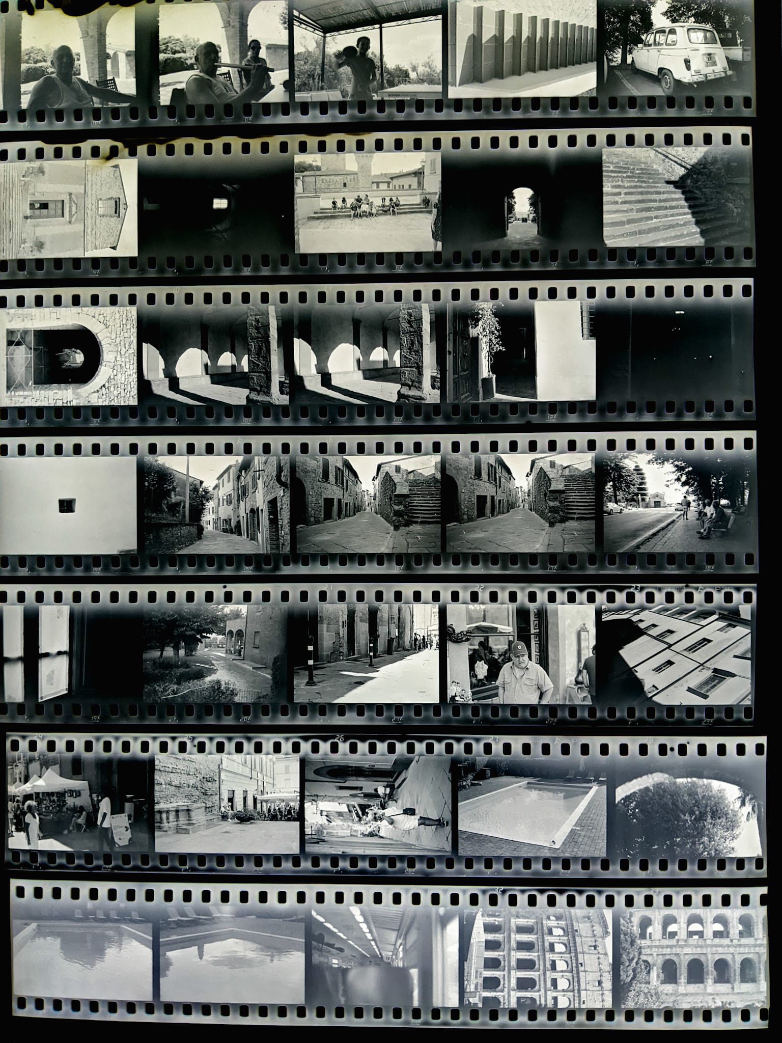

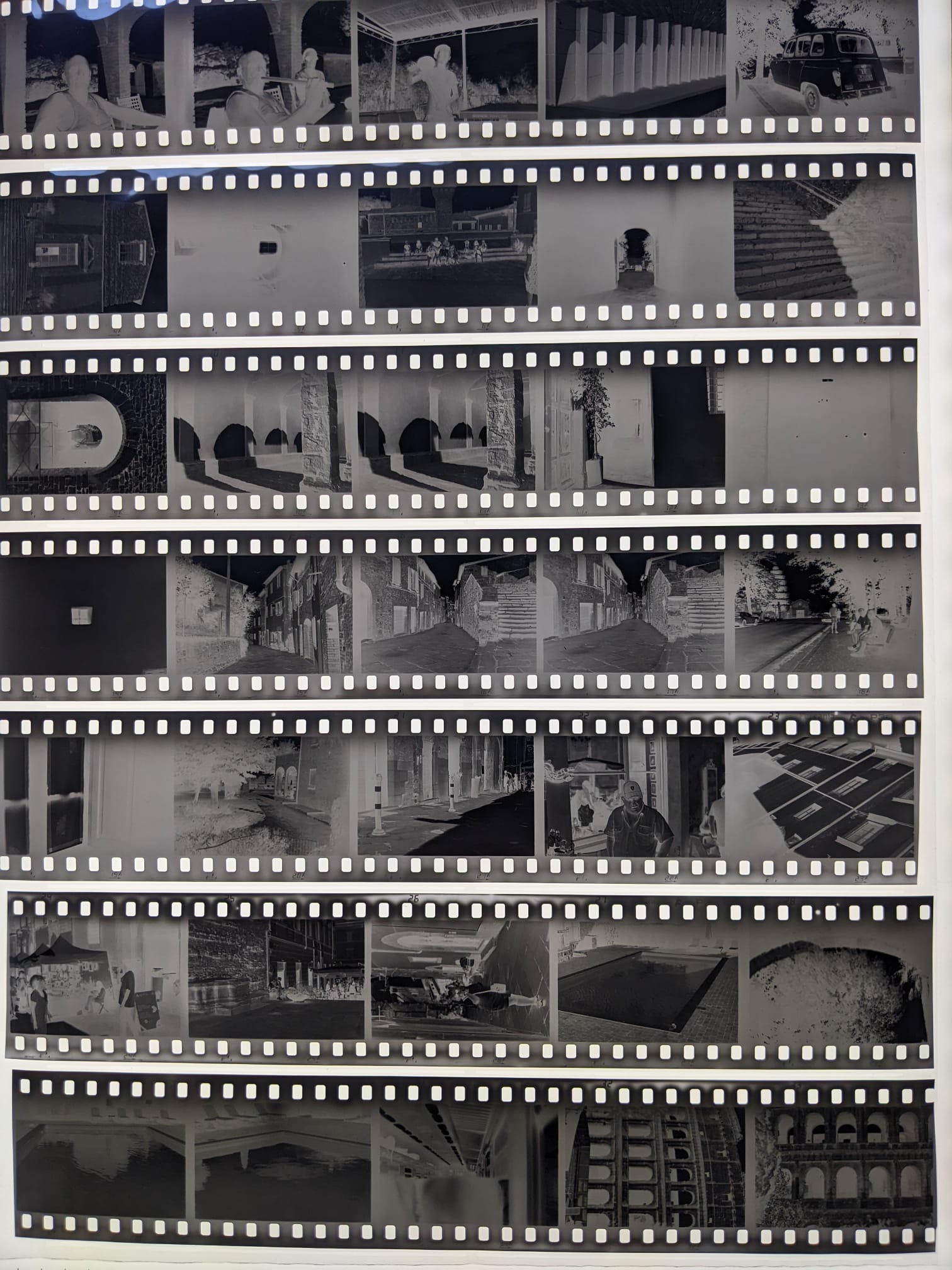

I'm pretty new to film photography and even newer to developing film at home. This is the 4th roll I've developed and the first Ferrania, and I noticed that the edges of the negatives look "burnt". It's right where the perforations are and in some cases it seems to get into the frame itself. I'm attaching two photos to show that, both were taken with my phone with the negatives laid on a light table. The "contact print" photo just the same pic with the colors inverted digitally.
I developed the roll for 12 minutes in dilution H (7ml:443ml) with inversions the first minute, and then 10 seconds inversions every minute (per Ferrania's website). Then a minute in the stop bath (Ilfostop), then five minutes in the fixer (Kodak Rapidfix).
Could this be due to an issue with the developing?
The other possible culprit is that I shot this roll with a Canon A-1 and its AT dial guard fell off and I replaced it with one I 3d printed. It's not a perfect fit like the original and it does have a couple small gaps in the side. I find it hard to believe that's what's causing this, but like I said earlier. I'm very new to the whole thing and wouldn't know any better!
Thanks!
-Eliya

I'll echo what Matt said -- the bluish spots in the top two strips are curious.
These are reflection from a window onto the liner. So that's not an issue with the negative - at least that!
It's worth noting that the high density sometimes exhibits as a continuous band (e.g., top of strips 2, 3, and 4), and sometimes as halos concentrated around individual sprocket holes (e.g., top of strip 6).
I too thought that was curious. Also strip 6 exhibit one little white dot over the last frame. I can't imagine how a light leak would be so symmetric and concentrated.

On a side note: I'd warn against labeling an image a 'contact print' if it's really an inverted digital photo of negatives on a light table. It's confusing to those of us who are familiar with actual contact prints; for instance, what turned out to be a window reflection also got me second-guessing, just like @MattKing. A real contact print wouldn't have shown this artefact.

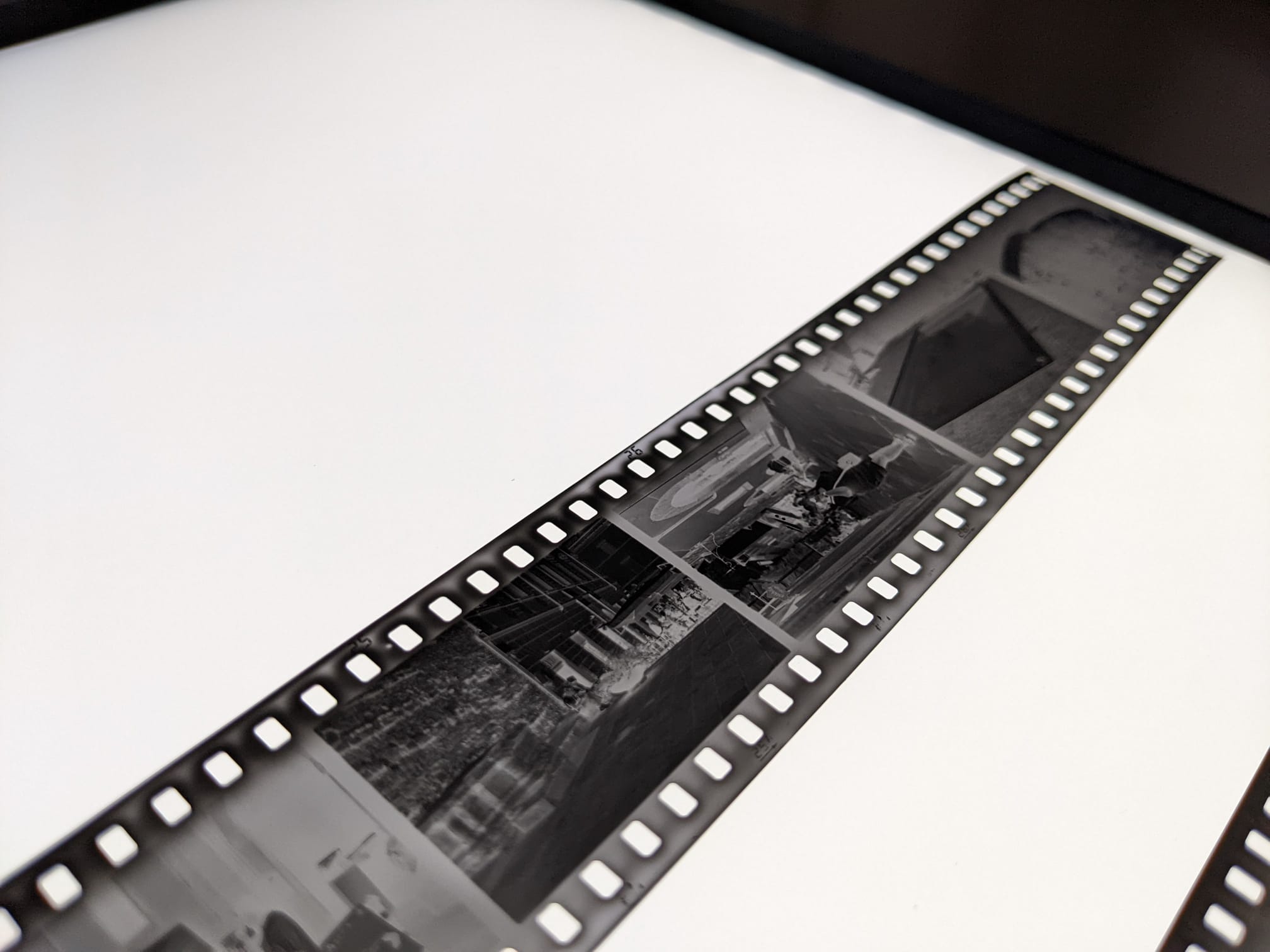

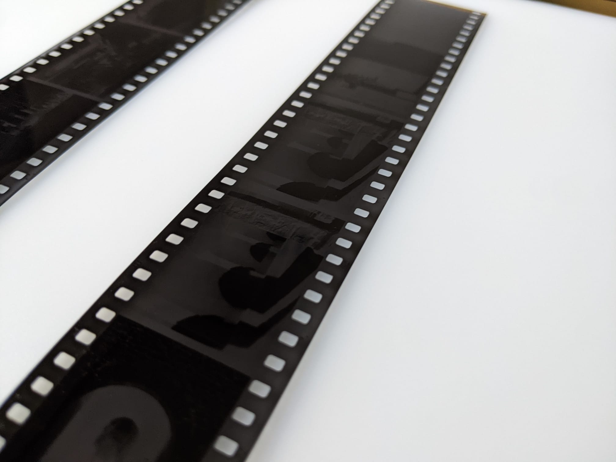

Attaching some pics which hopefully help. A couple of them are backlit because otherwise the fogging barely comes through.
What kind of development tank do you use, and is the center column properly fitted? Keep in mind the center column is part of the light trap. Leaving it out will result in severe fogging problems that very much resemble what I see in these negatives
I use a Patterson double tank. The center column was properly fitted, I believe. One thing I do remember now is that I put the light trap on, and I thought it clicked into place when I turned it clockwise. However, after turning on the light I realized that it didn't fully click into place. Once I figured that out, I did make sure it properly clicked. So that could be a source of the light leak.
Got it! Won't happen again.
