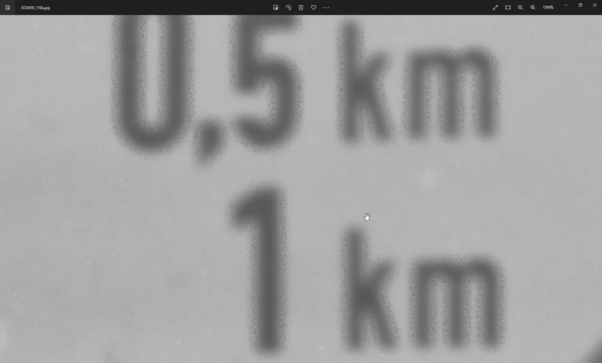

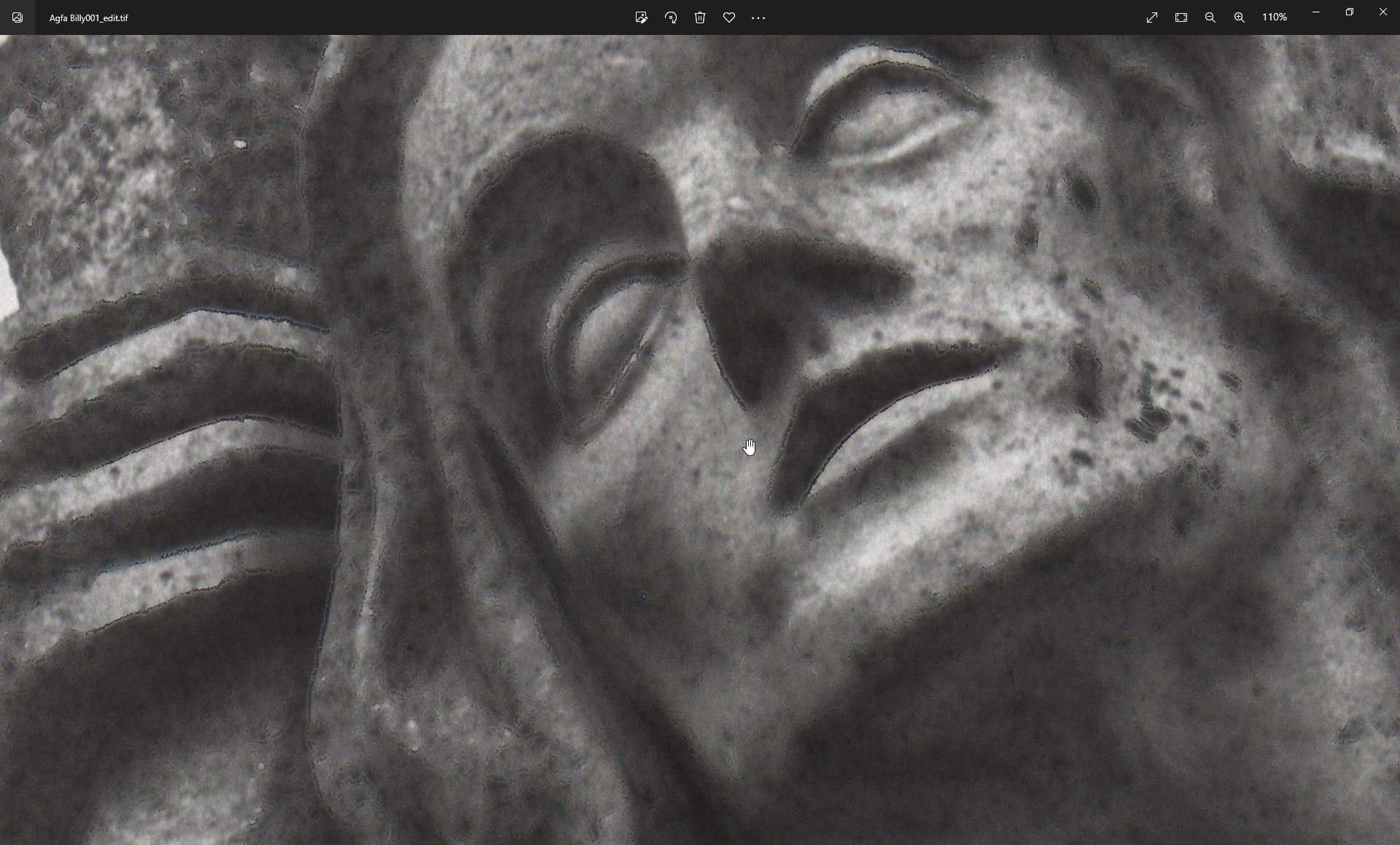

Hello everyone,
I`ve bought this summer a Agfa Billy I. I was very excited to tested out because I like the 6x9 format. After taking my first roll of 120 film (Fomapan 200), developed in a shop in Vienna and scanned myself at home with an Epson V550, the result were promising at first sight as exposure (most of them OOF). The OOF isn`t a problem now, I`ll get it better next time. The problem is, after zooming in, there`s some thing happening (I don`t know how is called). I`ll attached some examples (screenshots) which are zoomed in. Thank you and have a nice weekend!.

Have you just looked at the two images submitted by the OP before issuing that comment?
The OP is most probably referring to the artefacts that appear at the contours between dark and light regions. No optical lens, whether a triplet or a planar, or the lens of the scanner itself, could cause these artefacts. They are a numerical artefact, and it is very likely caused by the OP leaving the ICE dust suppression "ON" when scanning this B/W film.
@ LuckyMe : once again, can you confirm whether you left ICE on when producing these scans; and if unsure, can you please repeat the scan making sure ICE is off?

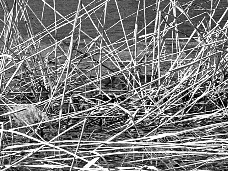

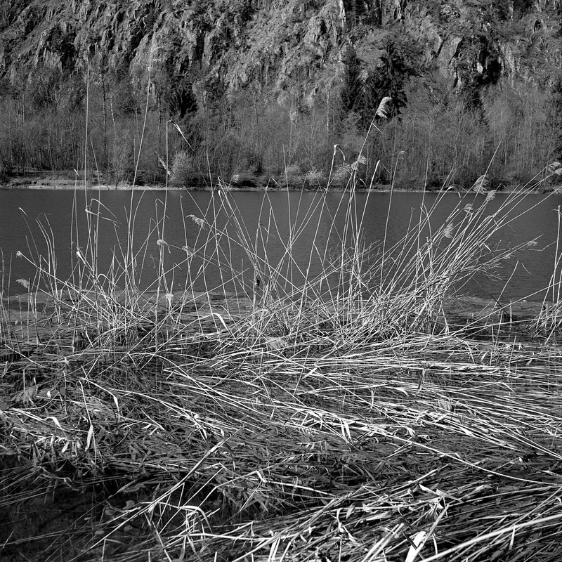

This.
Zeiss Nettar, Novar anastigmat. 400TX, D-76 1+1. Scanned V700 @ "only" 1600dpi.
Full frame (56x56mm) resampled to fit on screen
100% crop of 1600dpi scan.
This image printed at 300dpi would be 12 inches (300mm) on a side. The image on-screen would be larger (most screens are less than 300dpi).

Yes, I was referring about those artefacts.
And yes, the ICE was ON. With 35mm film was and is always ON and never happened those artefacts.
I scanned the film without ICE and artefacts disappeared.
From now on...always with ICE OFF.
Thank you very much @bernard_L

You may/should keep ICE on when scanning:
  • color negative film
  • slide film (other than Kodachrome)
This said, with a little care and a Giotto rocket blower, I have no problem scanning b/w without ICE.
