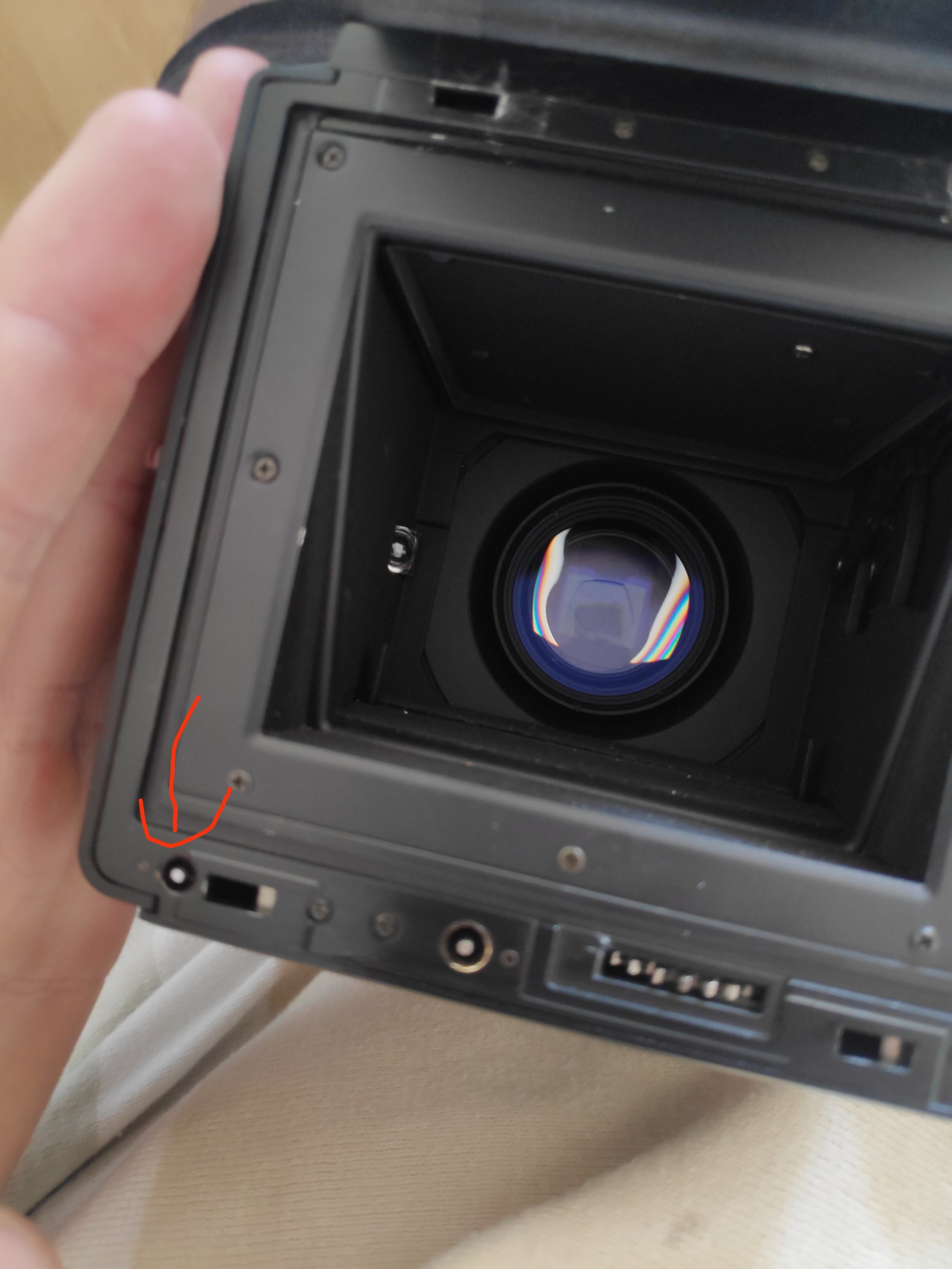

When i push this little thing (see photo) on the camera body in (with the back off, obviously) the camera fires even with the multi exposure position off!
could that be hint, that the camera body works. and the film back is the problem?
I'm not sure. The body and back mechanisms interact through this pin. The camera needs to strike it when the shot is made, but the back, which also has a pin there, needs to make it stiff (or slack, i can't remember) until the frame is properly positioned.
I'm a camera tech, btw. This is my view: You should better give the camera a service by a technician. It's always a good idea, even if the camera is working OK. I just gave service to my ETRS and my ETRSi this year, even though they were working. Now they are more enjoyable to use -- they're smoother.
The mechanism around that pin could be in need of lubrication, both in the back and in the camera.
Think it a little bit -- the camera and the back were stored together, in the same environmetnal conditions, for the same amount of time. Thus, if the camera body mechanism is in need of cleaning and lubrication, then also the back is, and viceversa. The film transport gears NEED to have their grease, clean grease in place. This will assure the camera will last for long and long, for decades. These aren't throw-away cameras.
Also, you haven't checked the light seals, they will probably require renewal.
This is a professional camera, it was a VERY expensive camera in its day, and those cameras were intended to be serviced periodically (i.e. every two years).
