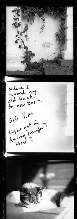

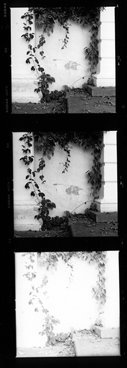

I bought a second Hasselblad 201F with film back recently.
Something weird happened in my tests, and I can’t figure out what happened.
Besides doing a roll all shot with new body with new back (which turned out fine), I did combinations of new body plus old back and old body with new back to check for light leaks in new items. I know my old body and old back do not have leaks.

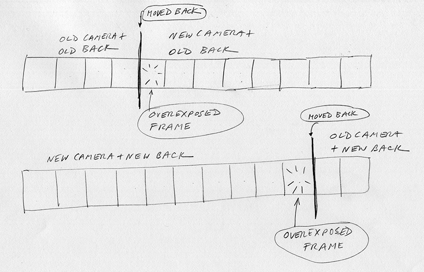

I did two rolls where I was switching things around.
In the first of those rolls, I took my old back which had four shots taken on my old camera and put it on the new camera. The first frame (#5) shot on new camera (with old back) was way overexposed. The image was just slightly visible on the right side of the frame, the rest of the frame was basically white. There were also flashes of light on the top and bottom in area around frame on left side. The rest of the frames shot with old back on new body were fine (6 through 12). So it was just the FIRST frame after old back put on new body that was extremely overexposed.
Then for another roll, I shot the first 10 frames with new camera with new back. Then I moved the new back to my old camera. In this case, it was the LAST frame shot on the new camera before new back was moved to old camera that was overexposed. Again, the image barely visible, mostly white. No white in the border this time. The remaining two frames shot with new back on old camera were fine.
The common denominator for the overexposed frames is the new body. In one case, it was the first frame shot on new body after a back attached. In the other case, it was the last frame shot on the new body before back taken off.
Frames where I shot something black with combinations of new back/old camera and old back/new camera were fine. No light leaks. And, as I said, the roll I shot all with new camera/new back (no back changes) was fine.
It’s possible I didn’t wind film to next frame before moving backs. But that shouldn’t matter either, should it? Of course, the dark slide was on backs when they were moved.
I’ll attach a sketch of what happened in case what I described isn’t clear. Also scans of parts of contact sheets with overexposed frames. In first, overexposed frame is frame number 5. In second, overexposed frame is frame number 10.

Did you insert the dark slide between exposures when the back was not being removed?
Did you wind the camera both times before removing the back? And the bodies were wound when attaching the backs? (ie: sync'ed - no double exposure?)
The supplied image for frame 5 appears to show what would happen if the dark slide not all the way in when the back was removed, or the dark slide got pulled out a bit after the back was removed.
Frame 10 looks like an uniform over exposure
They appear to be 2 different issues.
The only issues that I could guess that could be blamed on the body is uneven shutter speeds / uneven shutter curtain motion? How is the battery?

Hello. Thanks so much for your reply.
-- No, I did not put dark slide in between exposures. Dark slide only on backs when backs off camera or when I was finished shooting (I put it in then because camera can go off accidentally in my camera bag if I don't have dark slide in).
-- For frame 5: Agree, it does look like dark slide problem because of those light areas around image. The first 4 frames on that roll had been shot months before. The back was stored. Then I put on the new 201F for my tests. One might think that dark slide was not in properly during those months. Possible, but this has never happened before with this back or any back, and since I also had an overexposure on roll with different back, on same day, with the new camera, I feel I have to consider camera issue. (Camera common denominator in overexposures on two rolls.)
-- It's possible I did not wind the film to next frame before moving the back to the camera each time. But if I didn't, I must've wound it after on the camera, because I took notes about exposure for each frame, and I only have notes for 12 frames. If I had shot a frame twice, I would have 13 notes (and I would've wondered what was going on at the time). I was testing the shutter speeds and shot at almost all possible shutter speeds.
-- All the other frames where I was shooting at all the different shutter speeds were fine. Frame 5 (which looks more like a slide problem) was shot at f 5.6 and 1/180. The other overexposed frame, on the other roll, was shot at f 22 and 1/10. So different speeds. All the other speed/aperture combinations had correct exposures.
-- The battery was brand new.

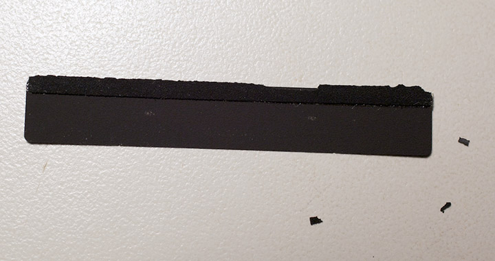

Hi Itsdoable. Attached is photo of the light seal that fell off inside my 202FA. I took this photo to send to Hasselblad/Bron for estimate.
Is this the mirror light seal? As you see, mine has a foam part along one edge. Then below the foam, it looks like the non-reflective material that is inside the camera. The other side is shiny. (I had saved the seal and dug it out this morning.)
When I look inside the 202FA, it looks like the foam part may have broken off at the top/back side of camera box.
If it is the part you're talking about......I don't need to have it replaced? That would be very good news. I haven't used the camera since it fell off, so I wouldn't know if leaks.
Just for laughs, also below is a photo of the seal falling. Fell off during a portrait session. I didn't realize it had happened until I saw the contacts. The photos after this one have a jagged black area at top of photos (the seal resting on bottom of camera box). I actually kind of liked the effect, looked like doom descending on this poor girl.

BrianShaw
Nov 30, 2005
16,948
La-la-land
Oh, what a shame... a potentially good photograph of a felt strip totally ruined by a cute kid photobombing you.

I recognize those photos from the other forum. We both have different user names there.
Here is the post where I replaced my mirror light seal the 1st time, before the replacement failed.
https://www.photrio.com/forum/threads/hasselblad-heartbreak.128814/page-2#post-1700820
The pictures should still be viewable. The metal part (that got left inside the camera body) has doublesided adhesive, and attaches just above the shutter. You can pry it off, and refurbish the entire seal unit, and reattach.
Wow, that was five years ago. You have a good memory:smile:
I actually was going to try to post about my just-bought 201F there, but the forums were down whenever I checked. Reason I came here. Do the forums ever work there these days?
Thanks for link to your photos of your seal. Does look like same piece that I had problem with, but the metal part is still in my camera.
I will test the camera as it is. If no light leak, I won't bother doing anything.
And I presume this is the "rear mirror light seal (upper)" which Hasselblad/Bron says on their site they don't have anymore.
Thanks very much.
