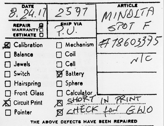

Super8
When I acquired a used Minolta Spotmeter F some years ago, I sent it to Quality Light Meter in Los Angeles (highly recommended, by the way). Some bad soldering connections and shorts on the circuit board were repaired.
