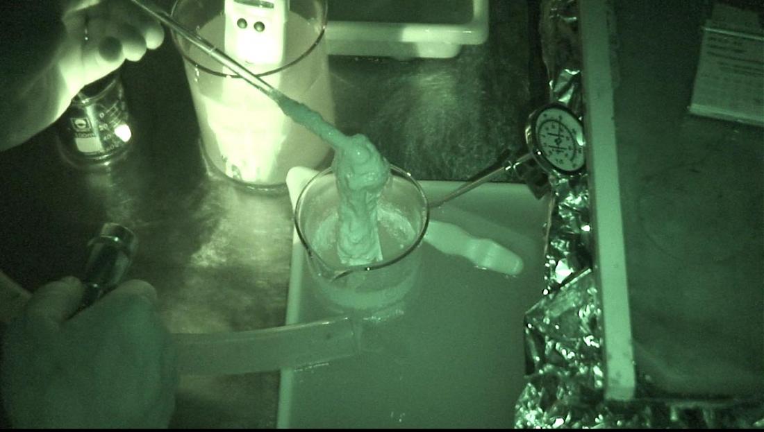

Well, this is not a subject to generate much interest it seems, but I have added some other information from a previous post. The incorporated picture, also from another post will illustrate.
When you ISO wash, you can get a series of forms of coagulum (this is what it is called in technical terms) that is created by acidifying an emulsion made in PA gelatin. You can get a loose flocculant material, a curd like material, or a putty like material. This depends on temperature and amount of PA gelatin used in proportion to regular gelatin. It also depends on the percentage of phthalate groups grafted onto the gelatin.
The first type of coagulum settles slowly, the second more rapidly and the third is formed almost instantaneously. Now, which do you think is desired in a manufacturing situation? Well, the quick one is. However, you run the risk of not being able to re-disperse the coagulum upon adding base. So, you have "the permanent coagulum". (also the name of a band formed by a group of emulsion makers at Kodak who played instruments and who suffered this fate at one time or another in the lab)
The slow loose type is most difficult to separate from water as well as being the slowest to separate from the water and salts. Most of the time it is useful to stay in the middle of the range. I use the higher level of phthalated gelatin in my coatings for purposes of teaching as it makes for a rapid wash and is almost foolproof for the beginner.
In any event, when the latter, putty like, type of coagulum forms, it forces out about 90% of the salt and water. At this time, more water can be added and it can be washed again. You can also knead it like bread dough to force out more water and salt. The attached picture shows the coagulum, adhering to a stirring rod and most of the the water and salt remains in the beaker.
Now as far as using PA gelatin and then coating, hardness does suffer slightly for two reasons. First is that regular make up gelatin is added for coating, and secondly, PA gelatin is NEVER phthalated to such a degree as to completely eliminate its capability to harden. Therefore, under normal circumstances, only a percentage of hardening sites would be occupied by phthalate groups.
The evidence is the fact that many of you, as my students, have either done this or watched me do it in the darkroom, and we have coated, exposed and processed the resultant films and plates. Picture examples were posted here.
One problem I might mention is that due to the time constraints in the workshop, the film coatings only dried and cured for about 12 hours or so, but when done at home I have had more time to cure (dry and harden) the coatings.
I hope this clarifies some additional facts about PA washing that are entirely unreported in the patent literature and that are poorly understood and often misreported elsewhere.
PE
