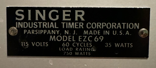

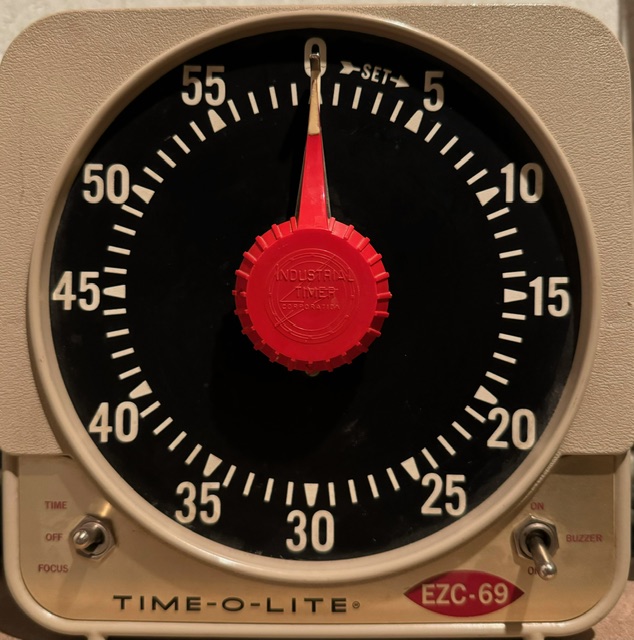

I use a Time-o-Lite, seemingly made by Singer. I use it to time film and print developing. It does not have a grounded outlet. Here are some pictures:
