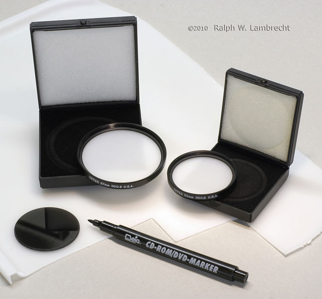

Also, whenever fogging the paper prior to camera exposure is necessary, it is easier to do that right in the camera and not in the darkroom. I built myself a special filter for that, taking an old filter and replacing the glass with a milky plastic reading exactly -2 stops. Make an exposure through the filter first, and without changing the exposure settings at all, take the filter of and follow it up with the image-taking exposure. This, in fact, equals a Zone-III pre-exposure and replaces the proposed pre-exposure in the darkroom. It works great for me.

ralph ...
that is a great pre-flash filter you have there!
i spoke with an old timer years ago who used to pre-flash his
slide film with a milk glass filter just like that. all the people around him
were wondering " what the heck is this guy doing ?! " and then when they
saw his chromes they were in awe of how "full" they were.
i tend not to pre-flash my paper.

Thanks
I forgot to mention that the milky plastic (shown in picture) is a box cover from IKEA.

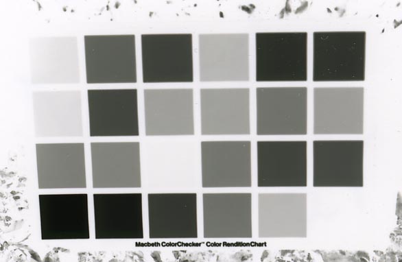

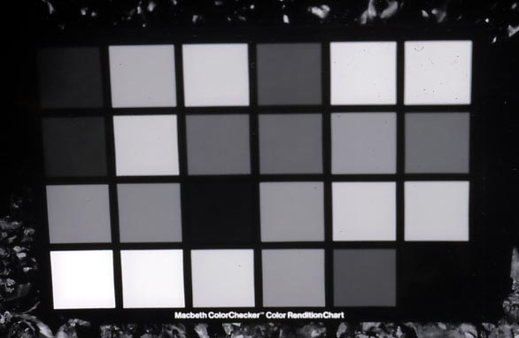

Here is the original paper negative from a scan and the reversal image courtesy of photoshop.
PE
removed account4
Jun 21, 2003
29,832
hi ron
what kind of lights do you use to illuminate your chart ?
i have found certain light conditions my paper is "faster" than others
(more blue? ) .
john
Photo Engineer
Apr 19, 2005
29,018
Rochester, NY
That was a daylight exposure.
