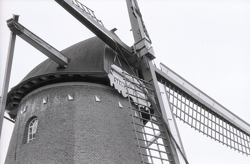

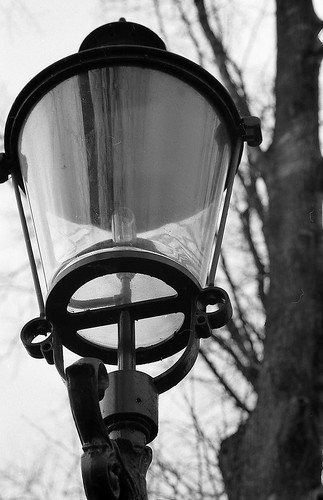

Acros 100 has excellent capabilities and can be only beaten by a cubical film from iso 25. Efke 25-Rollei Pan 25-Rollei ATP1.1 (Advanced Technical Pan - iso 32).
Controlling the contrast is not to bad with Efke 25 and Rollei Pan 25. The Tech Pan film needs a special developer to control the C.I.
I have very good experiences in the high definition developers like AM50 (Amaloco, based on pyrocatechine) and Beutler (metol) on the two regular films.
Here some shots to compare. (1) Acros 100 in Rodinal 1+50 (2) Rollei Pan 25 in AM50 1+29, (3) Efke 25 in Beutler 1+1+10.

It's a difficult choice.
Robert
I'll take the one in the middle :wink:
