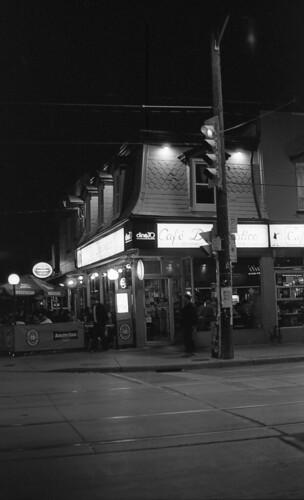

I'd try opening your lens all the way up and shoot at the lowest speed you know from experience you can hold..and see if you like the results. In the end, it is a night shot and you probably want the shadows to go black anyway so. ...Missi's picture above is a good example. If you shoot handheld a lot at night, I'd highly suggest a range finder of some flavor...that alone is good for about 2 shutter speeds.

As others mention will depend on just how dark it is and how many street lights might be around. Wet nights make a difference too, as does the camera's hand-hold ability. I've been surprised how nice many night shots have come out using 400 speed film and shot with my Contax G2 with my 45/2 Planar wide open at 1/15th. Other times, also as mentioned above, Tri-X at 1600 developed in Diafine is really nice, this shot with my Rolleiflex TLR:
