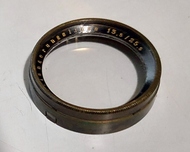

I have this Isco Verlängerungslinse accessory lens that increases the focal length from 13,5 to 25,5 cm. It's equivalent to the Zeiss Distar. It requires some exposure compensation, but how much? Let's say at a normal head and shoulder portrait distance. ½ or 1 stop?

Naively, it seems you're doubling the focal length, so what's marked as f/8 is now f/16; two stops?

Yes, something like that, probably. Doubling the focal length and a lot of bellows draw. I should experiment.

This thingy is presumably, like the Zeiss Distars, Proxars, and ordinary closeup lenses, a simple lens, in this case it should be a concave, diverging lens. It's not afocal - an afocal lens has no net power, like the cheapo screw-in front mount converters you can get for video cameras, or the close-up and tele attachments sold for 1960s TLRs and rangefinders. That's why those don't require exposure compensation, but this one does, at least in theory.

Maybe Dan and Doremus misunderstood something. It's indeed just a simple negative meniscus, like the Distar, for fixed lens plate cameras. The one I have almost doubles the focal length.
