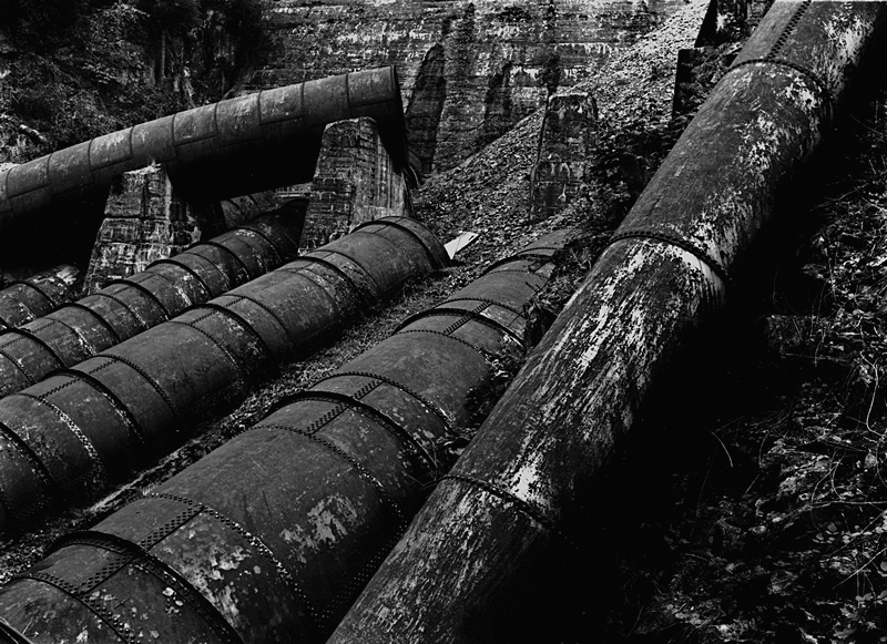

I don't have much scanned that originated on XP2, but the print below was. It may not be a good example, because it was intentionally printed to a higher than typical (for me) contrast. I don't recall whether I used split grade techniques on it, but I wouldn't have hesitated to do so.
