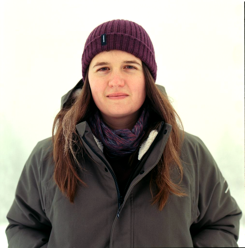

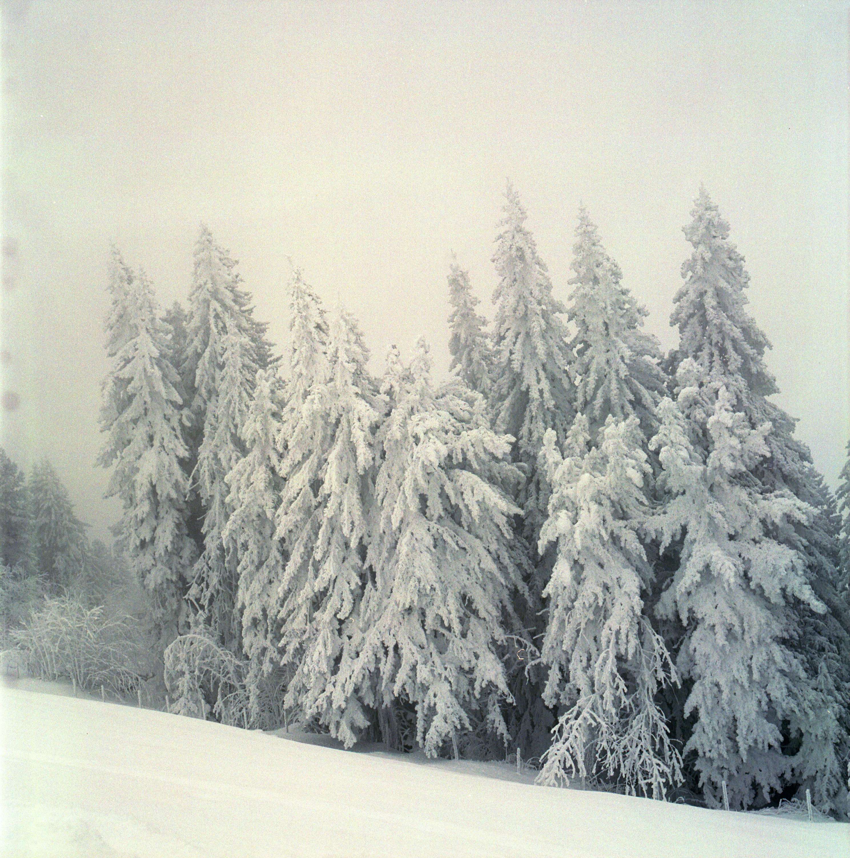

Hey guys,
I've recently came back from a holiday in the alps and developed my negatives at home. After scanning the negs I've realised that some of them have a strong magenta colour cast and a very heave grain. I suspect its UV rays as I didn't have a UV filter attached to the lens. Please see the images below - both images were shot one after another. I had a couple of the bad ones on the roll and they both had a bit of sky included in the frame thus my thinking its the UV rays.
I used Epson V550 scanner and Tetnal C-41 developer..

That's certainly not very high by my routine standards. UV would give a hint of blueness at distance, nothing much otherwise with this particular film. But the blueness in the tree/snow shot is probably just an ordinary color temperature issue, easily controlled with an 81 series warming filter. The magenta is blotchy, not overall, and looks like processing streaks to me, or else banding from the roll not being wound correctly. Don't blame the altitude.

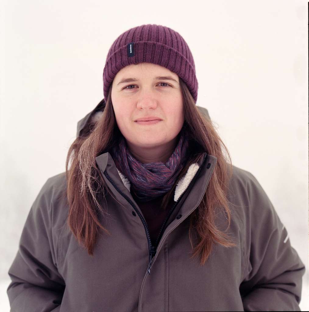

This is the example of 'good' image - the image of the trees is the 'bad' one
On my screen, in your original post, the woman is magenta and the trees are not.
