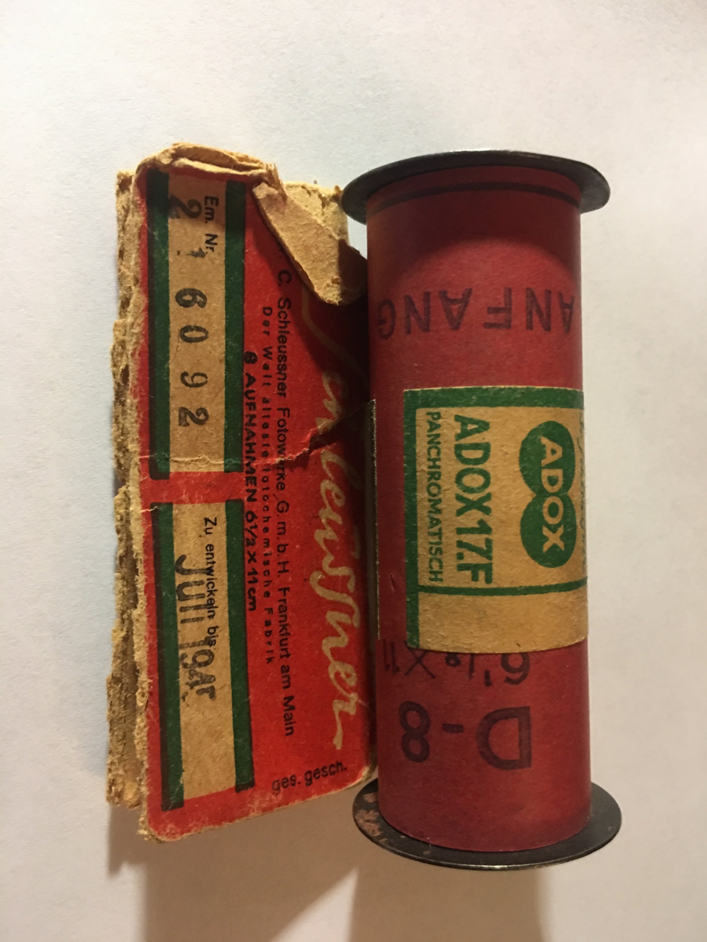

I have a couple rolls of this film and I thought it was
120 film and went to load in camera and it won't fit.
It says 6 1/2 x 11 ?

It is medium format film, but most likely not 120 film. 6.5 cm x 11 cm is equivalent to ~ 2.5" x 4.5".
Can you show us the ends of the spool?
Using Kodak nomenclature, it may be 116 film or 616 film (same film, but different spools). I have a Kodak Six-16 camera that yields 2.5" x 4.5" negatives on (long discontinued) 616 film.

It's old film but nicely sealed up, was thinking a old retro look but may not be any cameras left to use it in.
The spool is made of metal and wood.

That looks like a 116 spool - I've got a few of them in a nearby drawer to compare it with.
There are old cameras around that can use 116 film, but film that old will not be "perfect".

It's definitely 116.
I've shot and developed some of that age film, although the images came out, the image quality isn't superb.
Also, make sure the film isn't a nitrocellulose base. It's prone to spontaneous combustion, and could start a fire, its self oxygenating and so even in an airtight container it can burn.
I'm not saying this is, I'm saying if it is, it's super dangerous to keep in your home at the age it's at, they are the most prone to combustion.

Definitely type 116. Its backing paper printing says so.

There were different codings for Rollfilm types. Today the Kodak coding is international standard.
But in the past there were different codings. As the german one, a alpha-numerical one.

Well it is clearly written in German and seems to have a date( use by date?) of June 1945 on the paper. It didn't come from a bunker in Berlin by any chance, did it:D

I'm not sure of its history but may have come from a bunker:cool:.
