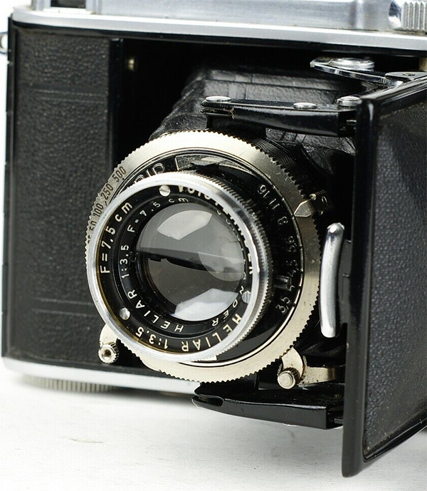

Anyone know if Voigtlander ever put a Heliar on the Baby Bessa 6x4 camera? I ran across this on Ebay. I've been looking at Baby Bessas for years, using them now and then, and have never seen this lens before. And looking at the three screws holding the dress plate with lens name on the front, well, seems somewhat cruder than Voigtlander? Then again, maybe it is legitimate.
The auction- https://www.ebay.com/itm/264391495934?ul_noapp=true

It looks like a previous owner has mounted an extra ring on top of the focus ring, maybe so he could use screw-in filters or push-on filters of another size. The shutter is nickel-plated and looks like it came from an older camera. I get a "franken-feeling" about this.

Ah, great. Thanks for the info. I've been watching Baby Bessas for years and never seen a Heliar before.
It's not worth $350 to me, but I guess if someone needed every version made, here's their chance!

I've looked at quite a few of these cameras over the years as well.
The outer ring doesn't appear original to me either. Many of these old Voigtlanders had a flip-up "moment" yellow filter attached to the front bezel of the lens. Oftentimes, this hinged filter is broken off and MIA.
The surround with printed Heliar and focal length, etc is glued on and often missing as well.
There's no reason the camera should have two Heliar lens surrounds unless the outer one is an adaptation.

Agreed on the look of the outer threaded ring. Metal color is off, as someone mentioned. The three silver screws overhang the inner edge of top ring slightly- not typical Voigtlander quality for this era. And having lens info twice is not right.
I'm going to assume that the base camera with Heliar is legitimate, with a filter threading added later by someone who had an extra Heliar engraved ring for some reason?

These specs state 1/300 as slowest speed, the shutter on the camera is 1/500
They were sold in different variations. Voigtar, Skopar and Heliar, Compur and Compur-Rapid. The one with Heliar and Compur-Rapid was the most expensive one.
Should be fastest speed ... :wink:
You're right with the camera from the ebay offer but 1/300 wasn't unusual for the Compur shutter. Kameramuseum Kurt Tauber listed a Baby Bessa 66 with Compur shutter 1/300 (here with the low-budget Voigtar lens) :
http://www.kameramuseum.de/0-fotokameras/voigtlaender/rollfilm/mini-bessa-66.html
I can remember a -late- Baby Bessa 66 with Compur shutter 1/400sec also.

I can confirm that at least one BB had a Heliar on it: the one I purchased years ago on evilBay as "for parts", with a totally thrashed body but decent lens. After cleanup and shutter calibration, I Frankensteined it onto an Agfa Billy "0" 127 film camera body, and it works great as far as pictures go, the ergonomics are a little wonky.

I have a Baby Bessa (66) with a 75mm Heliar. I don't think the front group looks like the one in your photo, but more like on the Skopars and triplets. (with the typical broken Moment filter). I will report back if I find it.
