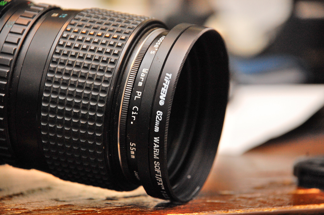

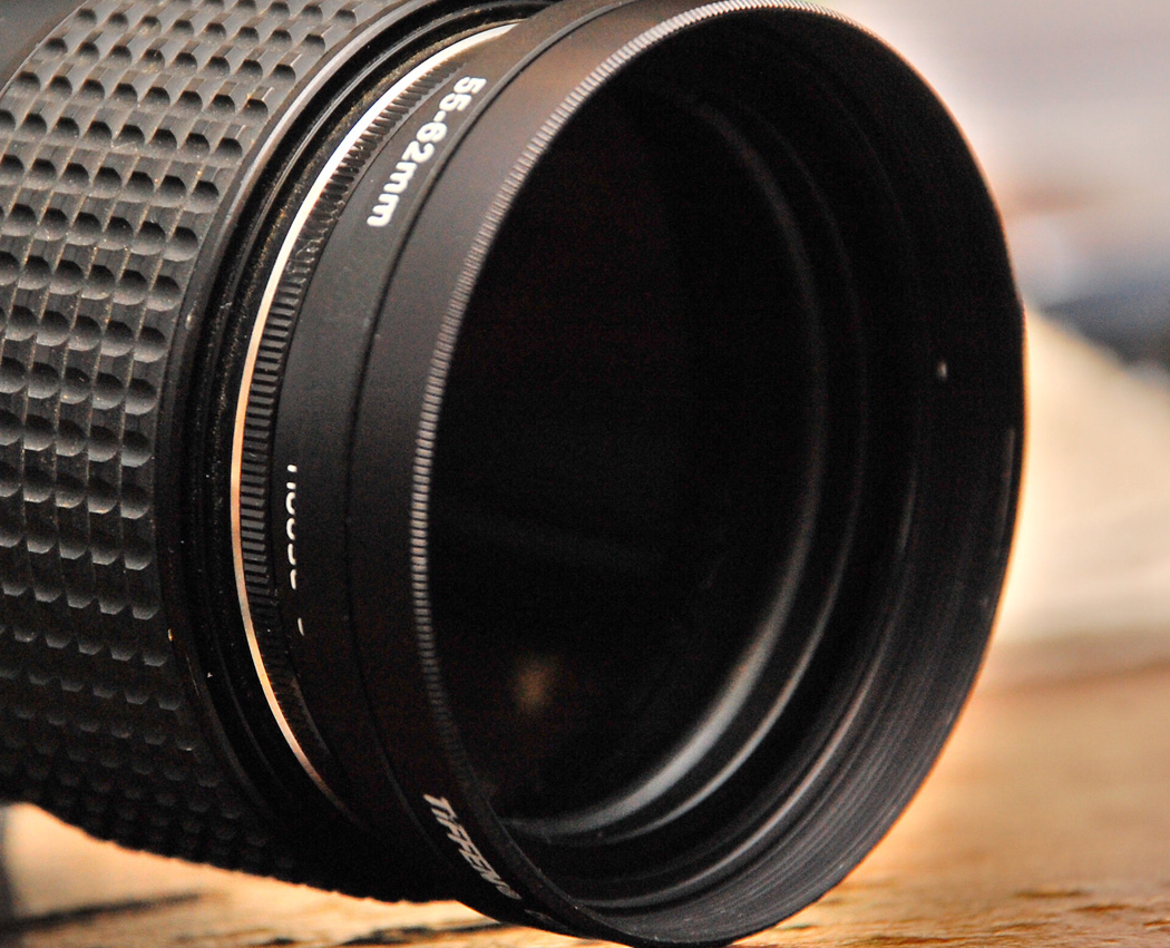

I got a "wide angle" 55mm metal lens hood for my Tokina 35-70 f/4 RMC for Minolta MD mount. If you put a filter between the lens and hood it vignettes at 35-40mm. So I made my own hood from a 55-62mm step up ring and a thick Tiffen 62mm filter with the glass removed. Do you think the hood I made has any kind of effectiveness or should I just go hoodless when I want to use a filter?

Here are pix of the setup.

Use another step ring till it vignettes...
