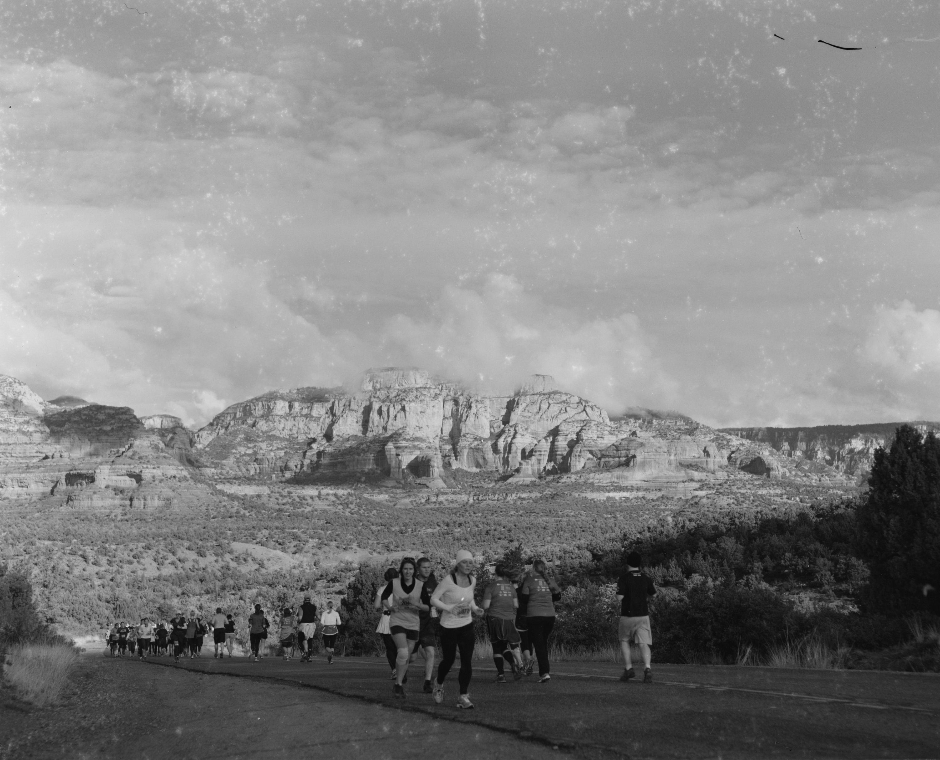

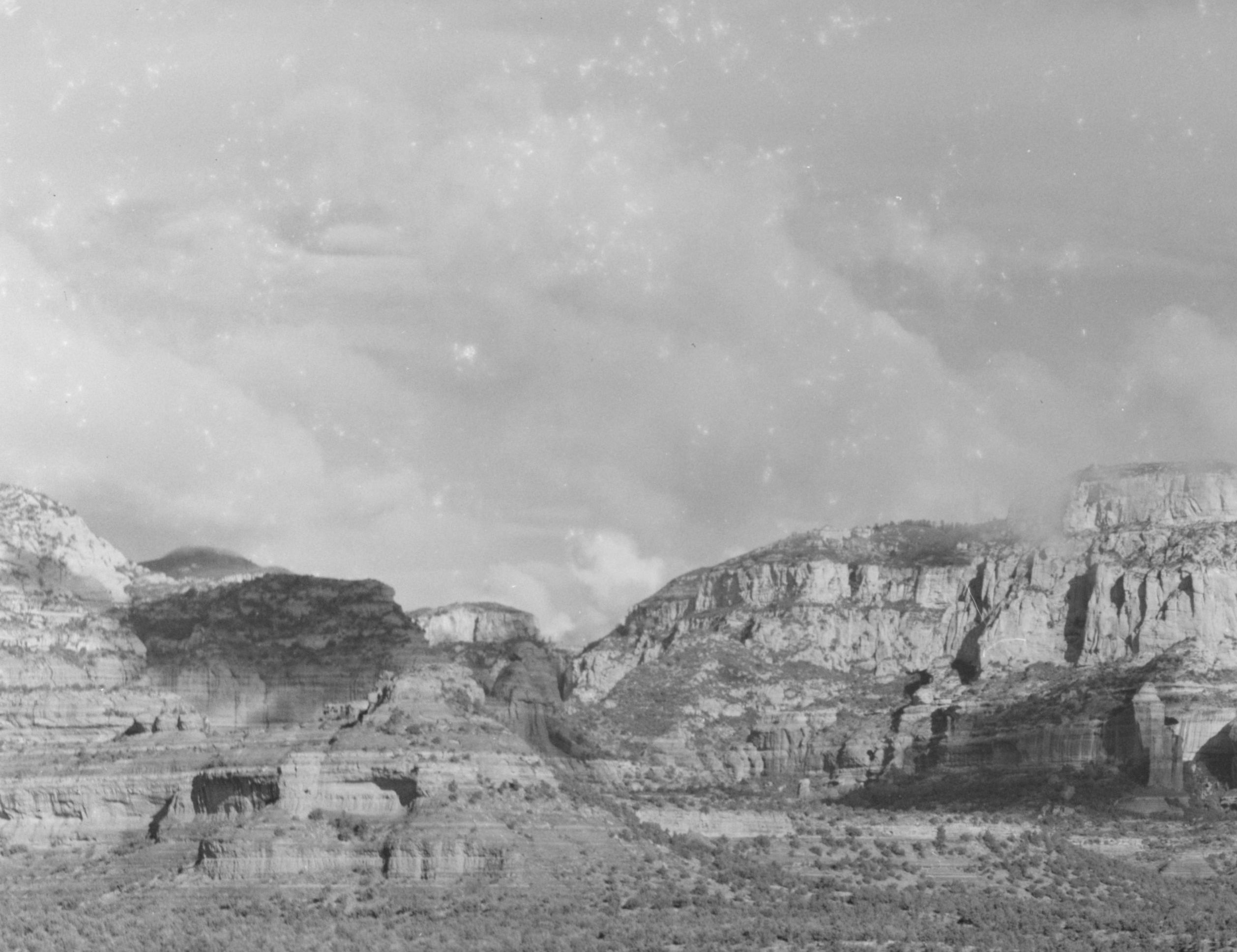

Strange... never saw anything like this.
Now is this fungus, expired film, or... ?
Taking the negative, and holding it sideways, to light, emulsion side up, and looking at it with a magnifying glass, I can see nothing pitted or raised off the surface. On the edges of the film, that was not exposed, you can see the grey 'spotted' areas through the clear negative.
The film holders are clean, as far as I can tell. Looked at them carefully under a magnifying glass. No sign of anything growing on them., or had been gowning on them, on the dark slide, holder surface inside film chamber or out.
The scanned sample below was the worse, and the holder, most likely was on the the outside of the group, of three from the time in 2010.
All six negatives showed some of the same characteristic signs, and where all developed at the same time.
Any ideas?

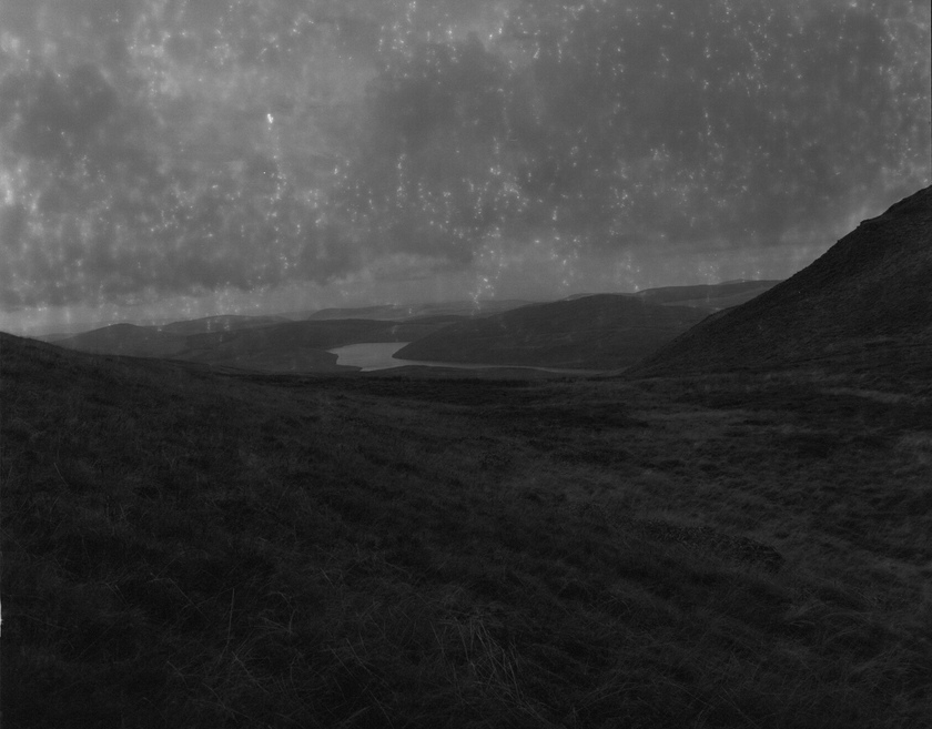

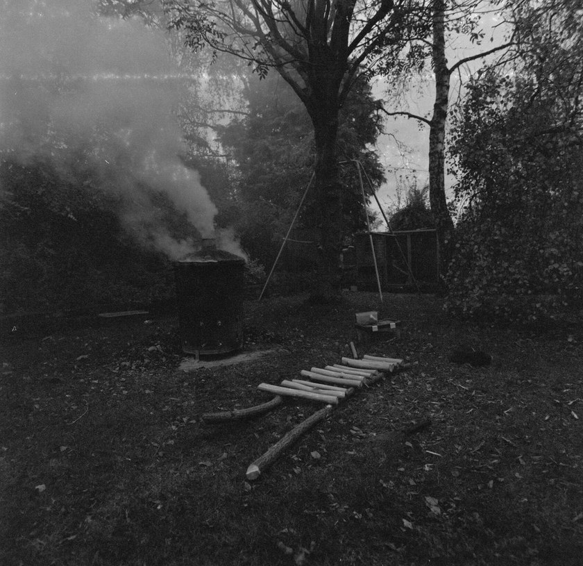

Well this is intersting because I also came accross very similar marks on a film I developed recently, also for the first time. The film was a Rollei Retro 400 (expiry 2016). It was developed in Microdol-X together with an Ilford fim. The Ilford film came out perfect, the Rollei simlar to yours.
I attach a couple of examples. In the first, note the 'straight line' of marks at the top of the image. This leads me to believe in some sort of film fault but I would be interested to hear peoples opinions. You can see that the pictures are hopelessly underexposed. I rated this film at 200 ISO, and took an incident reading with a Gossen Digiflash meter before each shot.
The film was from a pack of 5. The first two films developed came out clean - no marks, but significantly underexposed (still just useable). This was the third film. Since buying the film it was stored in my fridge. I doubt I will shoot the last two films.
