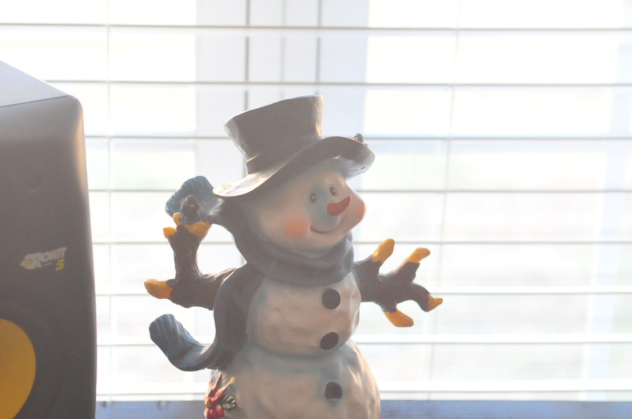

I can see no defect in the lens when looking at it (other than dust), but it is giving me hazy discolored photos in all but ideal lighting. I took a snapshot with it, then with an old AI lens, so you can see the difference. It there just thin layer of smooth fungus that I cannot see, or has a coating been removed, or what?:
Let me know what you think.
Edit: The blurriness is from being handheld at too low of a shutter speed.

How do shots look when they are not pointed into the light source? To me, this looks like flare, which could be caused by a layer of fungus or other surface coating, or just an old uncoated lens.

It looks pretty bad in anything but ideal light. I noticed it first in ambient indoor light with no flash. It is a modern coated lens, Nikon 35-70 f2.8 AF. But I got it used. Looking through the lens with a flashlight I see no fungus, but do see a slight discoloration, I think.

Fungus is often a spidery or spotty pattern on an element that is visible when you look at the lens. You might have haze on an element - this is a sort of more uniform cloudiness. You can try shining a flashlight through the lens from one end while you look from the other and see if one surface is especially cloudy.

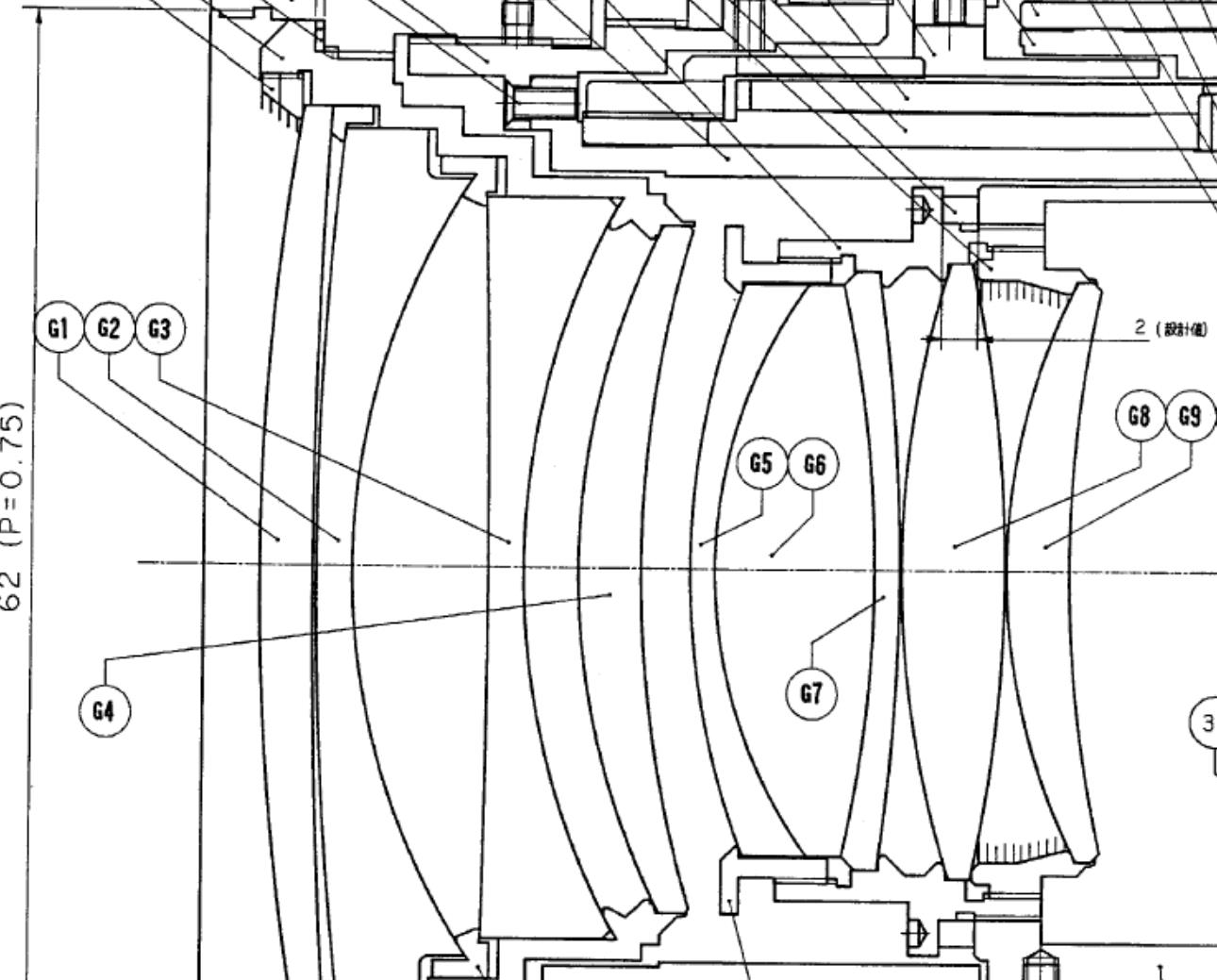

This is the front group, the elements will match the diagram. G1 through G9 are the elements.G3 & G4 are likely a cemented pair; G5,G6,& G7 may be a cemented triplet.

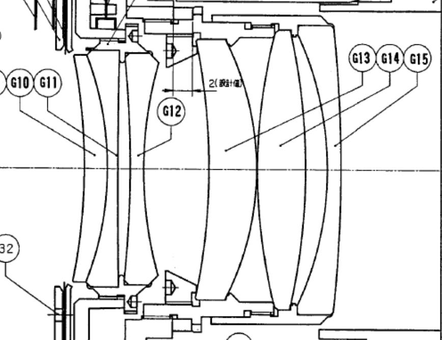

This is the rear group. G10 & G11 are a cemented pair.
Looking through the rear opening in the lens you should see a lens element retaining ring, if its larger than the lens mount then the lens mount has to be removed to remove the elements. With the lens mount off the aperture ring will likely slip off the rear of the lens barrel. The aperture ring will have a spring attached and a click stop steel ball with spring in the edge of the ring so don't bend or stretch the spring or loose the steel ball and spring. The click stop ball and spring are tiny. Item 30 is the lens mount ring. Item 39, rear cover ring will likely have to be removed. NO other parts should be removed from the barrel. Unscrew the retainer rings counting the number of turns and lift them out the rear. Assembly is the reverse of removal.
