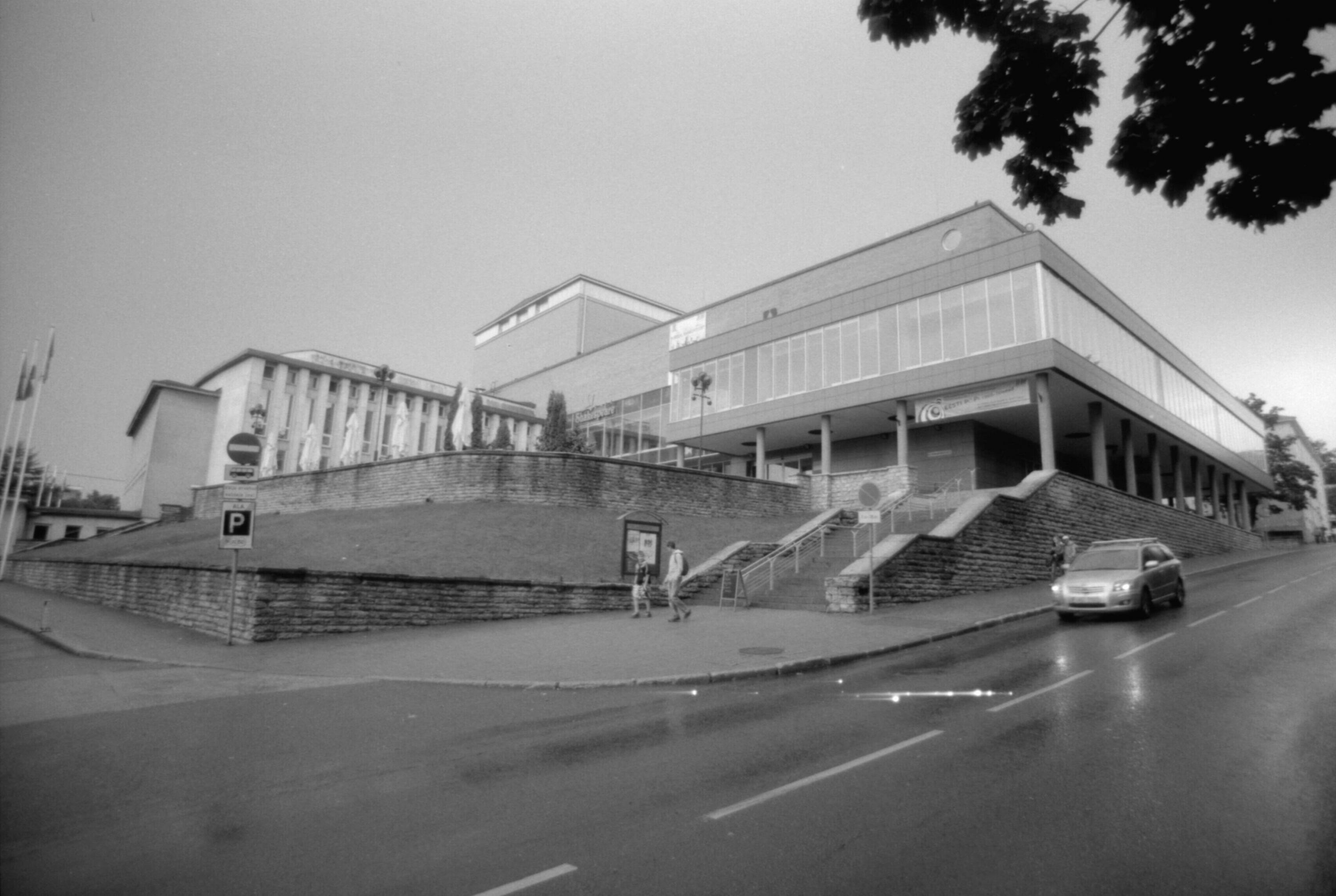

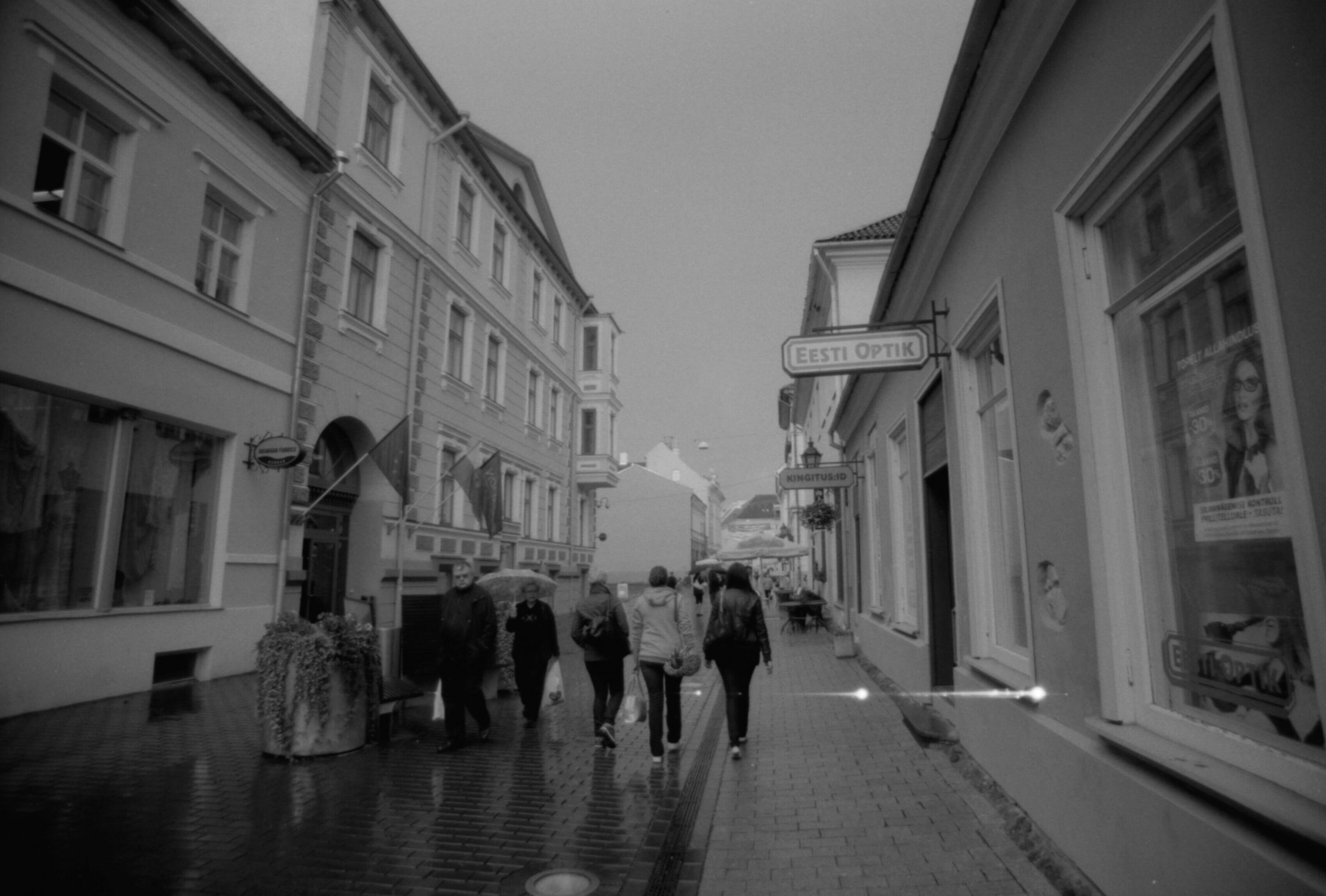

I'll make it short. I developed a roll of film and found weird streaks on some frames. I did everything as I always do, only this time I was in a hurry and grabbed the roll right from a freezer and held it in hand to warm it up. I attatched a couple of examples. Is that what it looks like when there is condensation water on film?

Here's how to analyze it:
1) It's light on print, dark on negative. That means it is more likely extra light and definitely not an absence of development due to bubbles.
2) It's a very bright spot, so it can't be simple overdevelopment due to bad agitation.
3) It's a streak. That points to something related to the film advancing.
4) It's a comet shaped streak. That indicates some strong burning in of light followed by a lot less light (per square sub-millimeter). That strongly points to a hole in the shutter curtain. The film rests for the shot and then is exposed to the hole sequentially as it is advanced. The advancing film accelerates, so the streak wanes and fades.
5) It's in the same position with respect to the vertical dimension. Added weight to the shutter pinhole hypothesis.
6) Condensation problems would be randomly located and would not be so intense.

It might be a problem related to emulsion, but I've shot several rolls of Lucky and it happened only with this roll that might have been exposed to condensation water. By the looks of it, it certainly seems to have happnened inside the camera. However, I still doubt it has anything to do with shutter, since my camera has metal horizontal leaf shutter and motor drive.
I think I'll just try to avoid shooting a film taken right from a freezer and see if this happens again.
And yes, on the right photo is theater "Vanemuine" in Tartu. Very nice you recognized it.

Dear Juri,
The first image is more distinct than the second : I think they are a coating aberration called 'comets':
Comets can be caused by many things, base anomalys, bubbles, dust etc, etc and they are typical in that they have an 'erupted' area followed by a tail where the emulsion then 'repairs' itself after the eruption and during the coating process.
These individual coating aberrations are usually identified and cut out of the master rolls of products.
My suggestion is that you return the film to the reseller and ask him / her to return it to the manufacturer
to check, as it may NOT be as I suggest and its only fair they have a chance to examine it and give you their own verdict.
Similar looking 'comets' can actually be done in processing if the emulsion side of the film is 'nicked' but it is very rare and usually the comet tail is not as linear as the example shown in the left hand print.

Ok, what make and model is the camera, leaf shutters aren't horizontal.
The camera is Pentax *ist. I know leaf shutters are round, but I thought that the term "horizontal leaf shutter" would mean a shutter consisting of metal leaves that move horizontally.
Those are the only 2 frames it happened in or the entire roll in the same place n shape? The frames that don't have this are near the end of the roll or not looking into a bright sky?
The frames in the original post are #7 and #13 respectively. It also occurred on the first frame, which you can see below. So three frames in the first part of the roll and the same position each time. That's strange now that I think of it.

Ah yes the same place, same shape on the frame as well. This suggests a light leak, not aliens, comets, condensation, chemicals or bubbles.
With the mirror in the up position, shine a bright light into the lens as you look through the open back where you can see the closed shutter? Do this in a dark room so any light wil be seen imedeately if it is in fact a pin hole in the shutter curtain. BTW the image will be upside down in the camera so look in that location as if the film were oriented in the camera, not as seen on a print? Also look in the place where the dot is not the streak.
I'm banking on a light leak.
