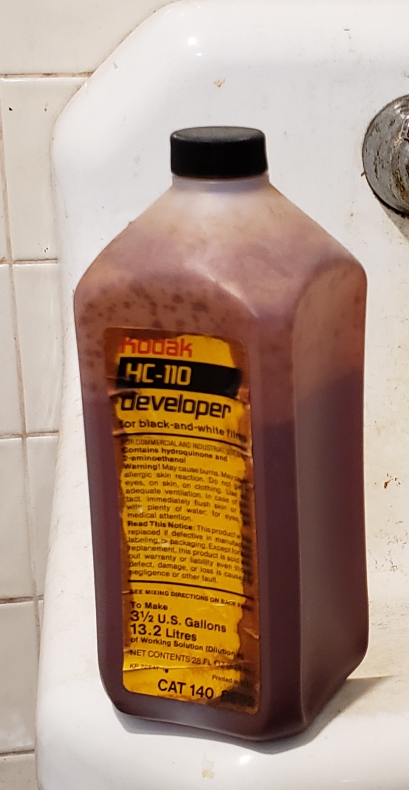

I've got an almost full bottle of the original HC-110 formula. It expired in late 2019 and I've since used it to develop exactly one roll of film without issue.
I just took it out and planned to use it to develop some Tri-X but there's some oxidation at the top of the bottle, although the rest of the syrup looks fine. Most of the oxidation is in the air gap at the top of the bottle but there's a bit at the top of the developer as well. I'm just wondering if it's worth trying to extract 5ml of developer from this bottle (with a syringe) and use it to develop some film, or if I should dump it and purchase a new bottle of developer before attempting to develop any more film.
Here's the bottle...
Thanks in advance.

Mix up a small portion of the developer and drop a strip of 35mm film into it. If the strip turn black in a few minutes it is still good. Film developer survives time much better than paper developer.
Good suggestion. I feel stupid for not thinking of that myself.

It only expired ten years or so ago. Practically fresh!

Actually I think that may be a 2019 date - still a youngster!

As others have stated, do not worry. It is still good. It will probably still be good in 2049. Maybe there is somebody somewhere that has a bottle that has gone off with age but that somebody has never made himself known.

I've seen that color appear in HC-100 that was not in a completely full bottle ( I decant it into full 120ml glass bottles, and then use them one at a time )... I just mixed it right in and it worked perfectly. I think you're going to be fine.

looks fine to me. The syrup will change color, toward a deep orange, over time (years) too but it will still work fine.

I'm still using a bottle first opened in 2004, with a use by date in 2007.
It has turned orange and thrown down a precipitate but it still works fine.

Thanks for all of the responses. I tested the developer on a small snippet of film as @Sirius Glass suggested and it seemed fine, so I developed a roll and it looks to have turned out ok.

I have 1/3 bottle of HC-110 left over since I paused my b&w film journey in 2016. When I picked up film again in 2021, HC-110 in that bottle has turned into deep orange over the years. It worked just like fresh developer. So yes, your bottle is pretty fresh. Enjoy!
