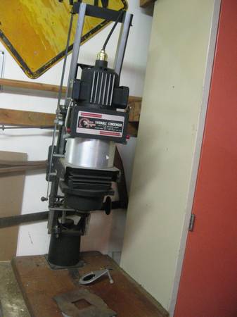

Here's a photo of the enlarger in question:
That looks just like a D2V. The door opens and there is the variable condenser which can be moved into 3 positions. One is for 35mm, one for MF and one for LF. The silver part below it is the fixed condenser. Behind that is one lens on a cone on the enlarger and one larger cone + lens on the table top. You will probably need one more cone, but on mine the lens mounts without a cone. It depends on focal length.
PE
Perfect. I had thought it looked similar to the D2 enlargers I had seen, but I didn't know enough about this one from the info given in the ad. Can't beat the price on it, so I'll pick it up...I'm sure I'll still have a few odds and ends to obtain to complete the rig, but I'll be on my way...
Thanks to all for the help!
Audi
