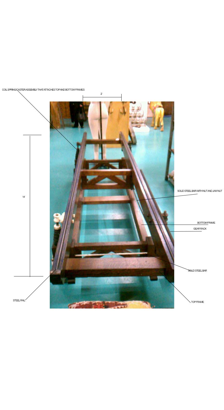

Wondering through a huge antique store in Chicago this last weekend, I stumbled on this. Tagged as an 'antique camera' and nothing else, i decided this must be a bed for VERY large bellows camera.
In the lower right corner of the bed, running towards the back (towads the maniquin) is a flat gear rack. There is a solid steel bar (the cross section would be a 1/2 circle) that runs on top of the right and left wood rails of the top frame. The top wood frame is attached to the lower wood frame via a coiled steel spring and the spring is attached to a caster that is attached to the lower frame. Under each of the wood rails is a solid steel bar that is connected to each end and in the in the shape of an inverted 'V'. The two ends have a nut and jam nut.
The length is about 14' and the width is about 2'. It is about 18" high from floor to top of the top frame.
I have attached an annotated drawing to help with the description.
Anyone know what this is for?

looks like a copy camera--HEY--I'm interested in this as I have a copy camera--which store is this? I'd like to see it...unless they want a grand for it or somthing idiotic like that....

This could be an old Bob sled from the 1924. Olympics :smile:

upon viewing--that thing is suspended by four spring---like an olde car suspension where the wheels are rigidly attached to a frame which has 4 springs that support the carriage.
8 grand
you can buy an olde car frame restored cheaper--absolutely not worth it...
it is very large...like 20" camera or more--almost certainly used to photograph ilne art in a building subject to vibrations--hence the sprung suspension.

on each side under the top rail is what appears to be a tension adjustment bar with nut and jam nut on each end in an inverted 'V' configuration. what would that be used for? And, I love those 4 coil (literally) springs. I have never seen a coil spring like that. Did you bother to shake the top section of the frame? The springs are very effective.

yeah...it was tested for "vibration worthiness"....this is pretty kool piece but you can prolly have one built from scratch for less...them springs ARE a blast from the past...olde school...they are a combination between a coil spring and an cantilever beam
that "adjustment" is still a mystery...what is it for?...fer 8k maybe they'll let out the secret...
