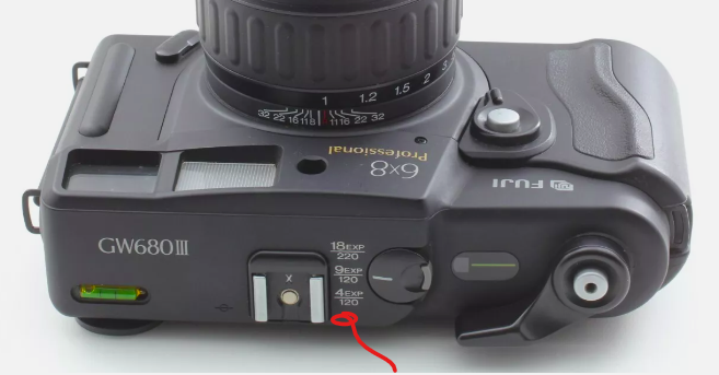

Could it be a 120 half roll?
It has not been cut, has the loading tapered tongue. I’m pretty sure the first two replies are correct. I’ll take it into the darkroom tomorrow and find out.
In Japan, they apparently sold half length 120 rolls, because the "Texas Leica" Fuji rangefinders for 120 film offered a frame counter setting for them.
You can see it in this borrowed from eBay listing photo:
I've never seen one of those rolls, and I don't know if Ilford made them.
I'm sticking with my earlier guess.
By the way, one of those GW680III cameras is definitely on my wish list!
I saw a big listing of half length 120 Portra on eBay once, they were selling like 100 rolls of it for a high price.
These Fuji cameras were used a lot to take pictures of big tourist groups so it makes sense that they wouldn't want many pictures before a development.
The Fuji G617 has the same "half-roll" accommodations. A relatively portable banquet camera, as it were.

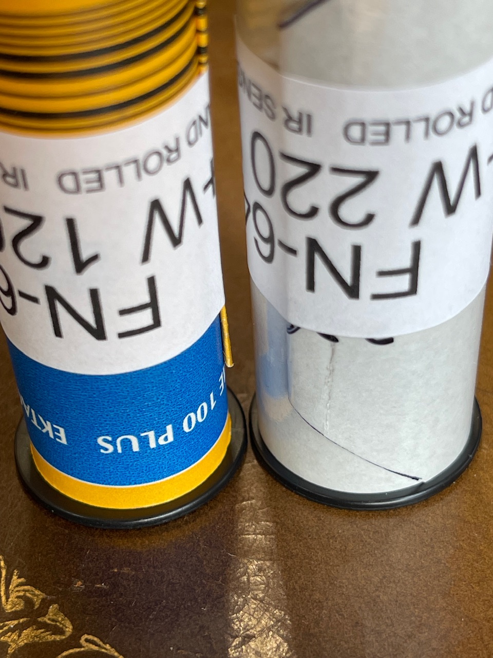

The backing paper or sealing band will tell you what format it is. They made the difference very obvious so photographers and lab technicians could tell them apart at a glance. If it’s Ilford paper, there will be a black/white diagonal stripe pattern on the top and bottom edge, and the film name will have “220” beneath it. If it’s Kodak, there will either be “220” in big letters with horizontal lines between each repetition, or green cross-hatching along the entire width of the film with the film name being accompanied by “220”. I have yet to get my hands on any Fuji 220 paper but I suspect that it will also be marked distinctly.
However, with all that being said, you probably just have a roll of blank paper. 220 is usually fatter than 120, if only slightly. Not narrower. See attached picture for a comparison between 120 and 220 roll “fatness”.

@MattKing all of the GW series cameras I've owned have had a provision for the 120 half roll.
Not surprising.
But I'm not sure I've seen cameras other than the Fuji ones.
Fuji being the only manufacturer of cameras that have a 1/2 120 roll setting while also being probably the only manufacturer of 1/2 120 rolls of film? Sounds sensible.
I mean, it was kinda an odd concept outside of Japan. But as I understand it, it was very popular even into the late 1990s for Japanese tourist photographers to use these half rolls of 120, since it was often more convenient to take 4-6 photos for each individual group, as opposed to having multiple groups on a single roll. That, and they could get the roll developed and printed faster than normal 120.
