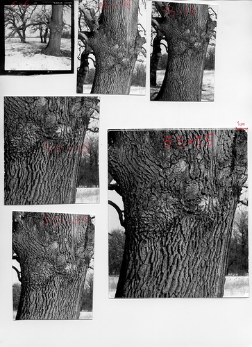

I was expose the negative at ISO 80, and then a was develop my negative in X-Tol at 1:1 dilution. Temperature, time and agitation from Data Sheet. Film T-Max 100.
And then I was enlarge my negative.
In the scan is the contact print, then crop from 18*18 cm., 30*30 cm., 40*40 cm., 55*55 cm.
Then I was scan this without correction at 300 dpi.
And in result I need some comments about quality of my photosystem. Is this a normal result for medium format at the 9x enlarge????
I don't have experience in this format cameras and lens, but when I use a small format Nikon with fix lenses I'm not sure that Nikon 50 1.8 was more quality at the same enlargement. Perhaps that Nikon 50 1.8 lens was little more sharp and because I was use a Ilford FP4Plus with D-23 little more grainy.......
I was use a Gitzo 5 series alluminium tripod, camera was Kiev 6S (made in USSR) with Carl Zeiss Jena Flectogon 50/4. Enlarger lens was Rodenstok Rodagon 80/4.
Dmitriy Shishkin from Russia With Best Regards.
