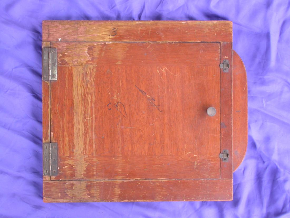

Sorry for my ignorance on plate cameras and accessories. I just never got into them. However, I received this as part of a package purchase a few years ago and I need help identifying its purpose. Thanks in advance for your help. Pics will be in two posts.
Overall dimensions are 11" wide x 11 7/16" long x 3/4" thick.

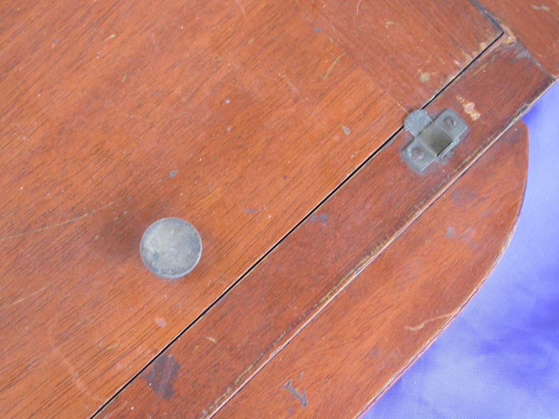

/// Back? ////// Front? ////// Pull knob & 1 slide lock

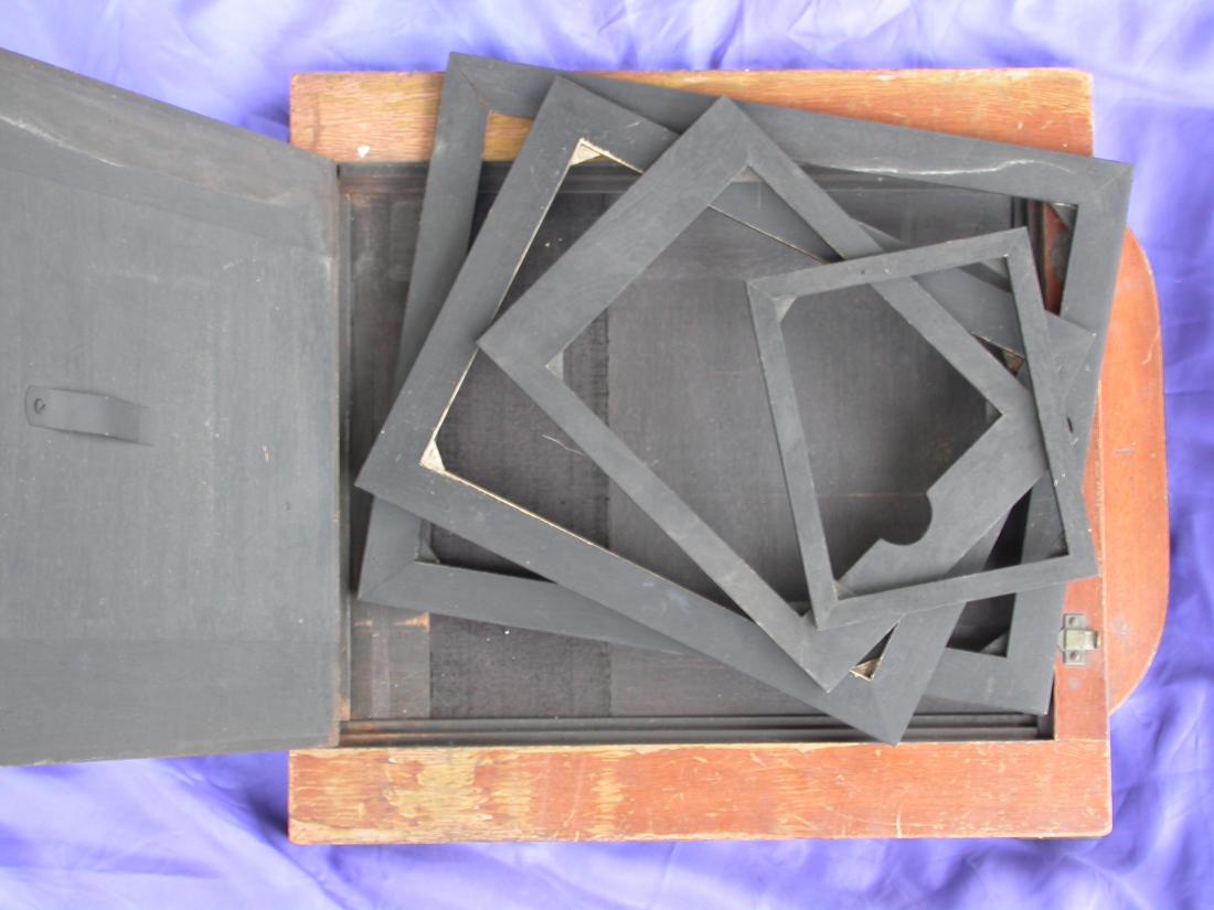

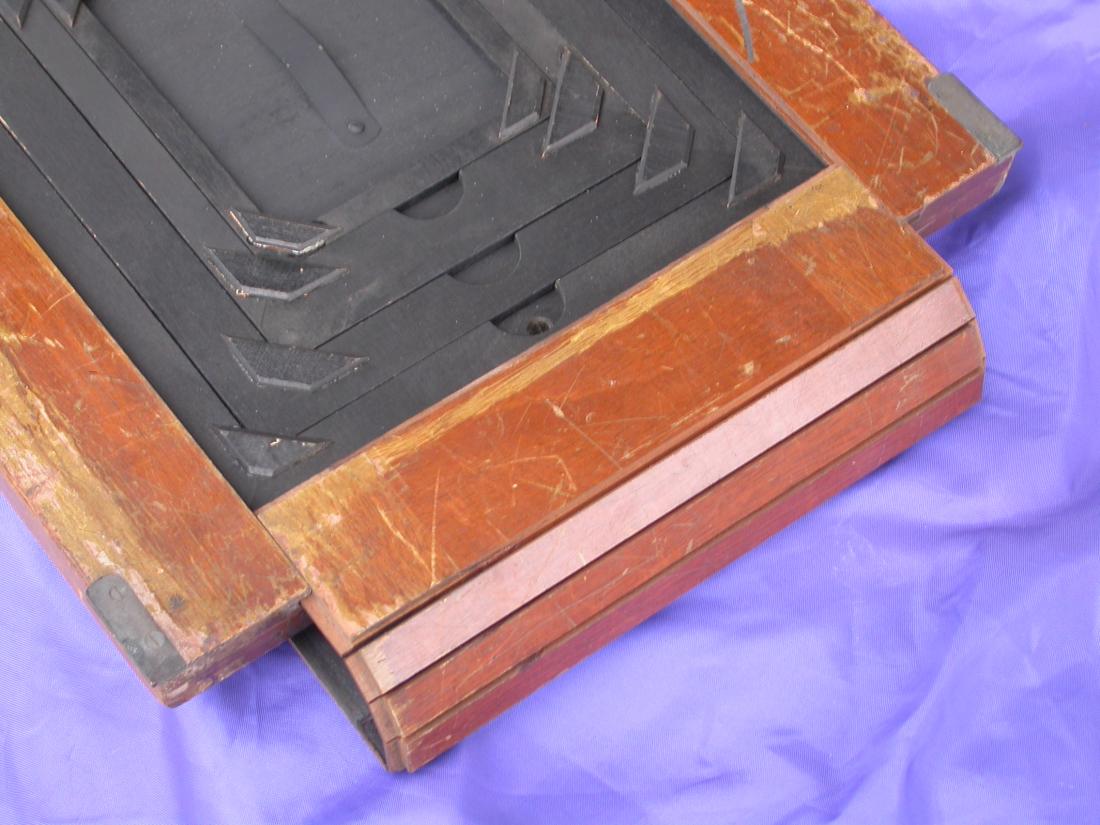

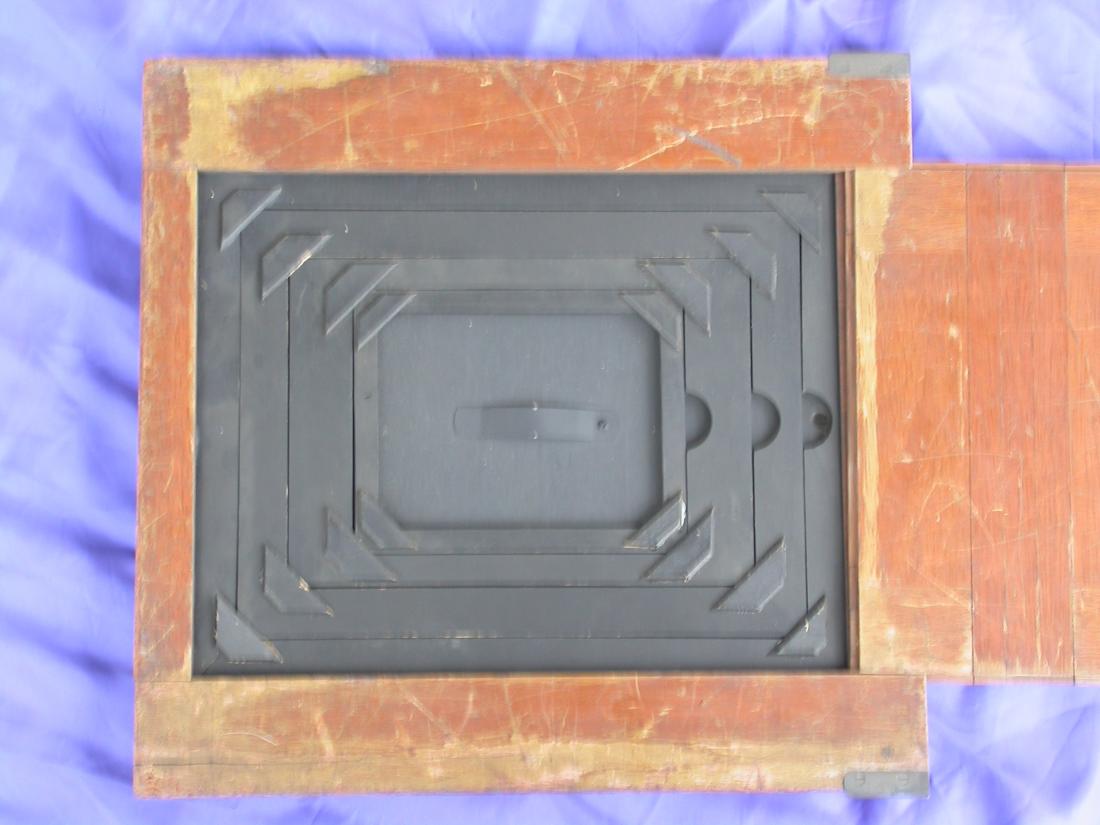

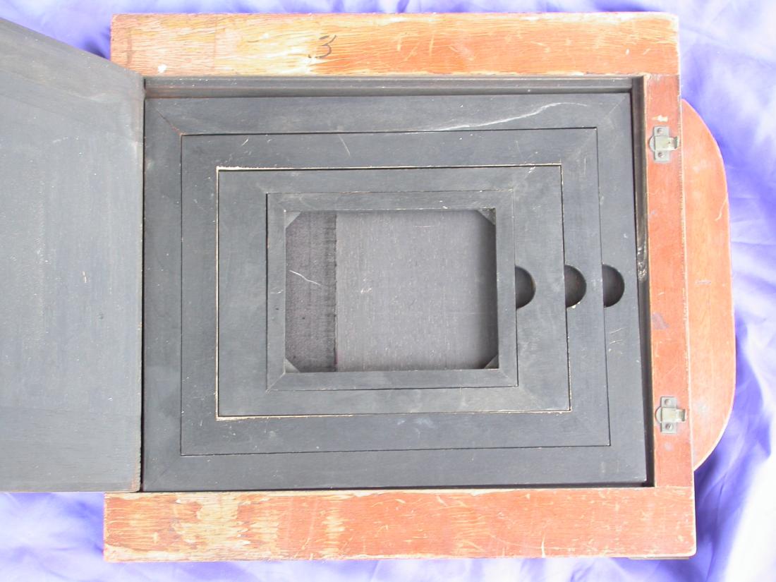

/// Front open / Inserts removed / Back open / Front slide has multi-hinge that wraps around to back.

Yup. The inserts allowed different size plates to be used on the same camera without changing backs. By the relatively clean appearance, I would guess the whole set was for dry plates, though I've seen them adapted for wet-plate work. Pretty nifty, huh? I have a set for my Rochester Universal.

I have two similar holders, which I purchased off e-bay. I paid $99 for one of them, and got the other for about half that. Sorry, I don't remember the exact price. The holders I have are different, however. Mine are labeled "Bromoil" holders. They are the same thickness as a modern holder. Unmodified, they were about 1/4 inch wider than a standard holder. I simply placed my regular holder over the Bromoil holder and marked the size with a pencil. I then trimmed down one side with a table saw. My holders have a hinge on one side which prohibits trimming both sides of the holder. There is no ridge along the top, but I have not had any problems with light leaks.
The holder you show looks older than the one I have. It also looks a bit thicker. Be sure to check the thickness of the holder (and film/plate position) before trimming down the sides.
The insides of the holders look the same. I clean the insides each time I use the holder for wet plates. I wipe down the inside before the plate goes in and after taking the plate out for processing. Be sure to clean the back of the holder.
I really like my holders. I can have one holder and it will take many sizes of plates. I hope you can make this one work for you.

Okay... measured the thickness of the plate holder area... approx. 4.57mm or 0.179921". The distance between the front of the plate and the front of the holder is approx. 8.86mm or 0.348818".

The depth of the plate in the holder needs to be the same as your ground glass when in place on your camera. Measure your ground glass and compare to your holder.
