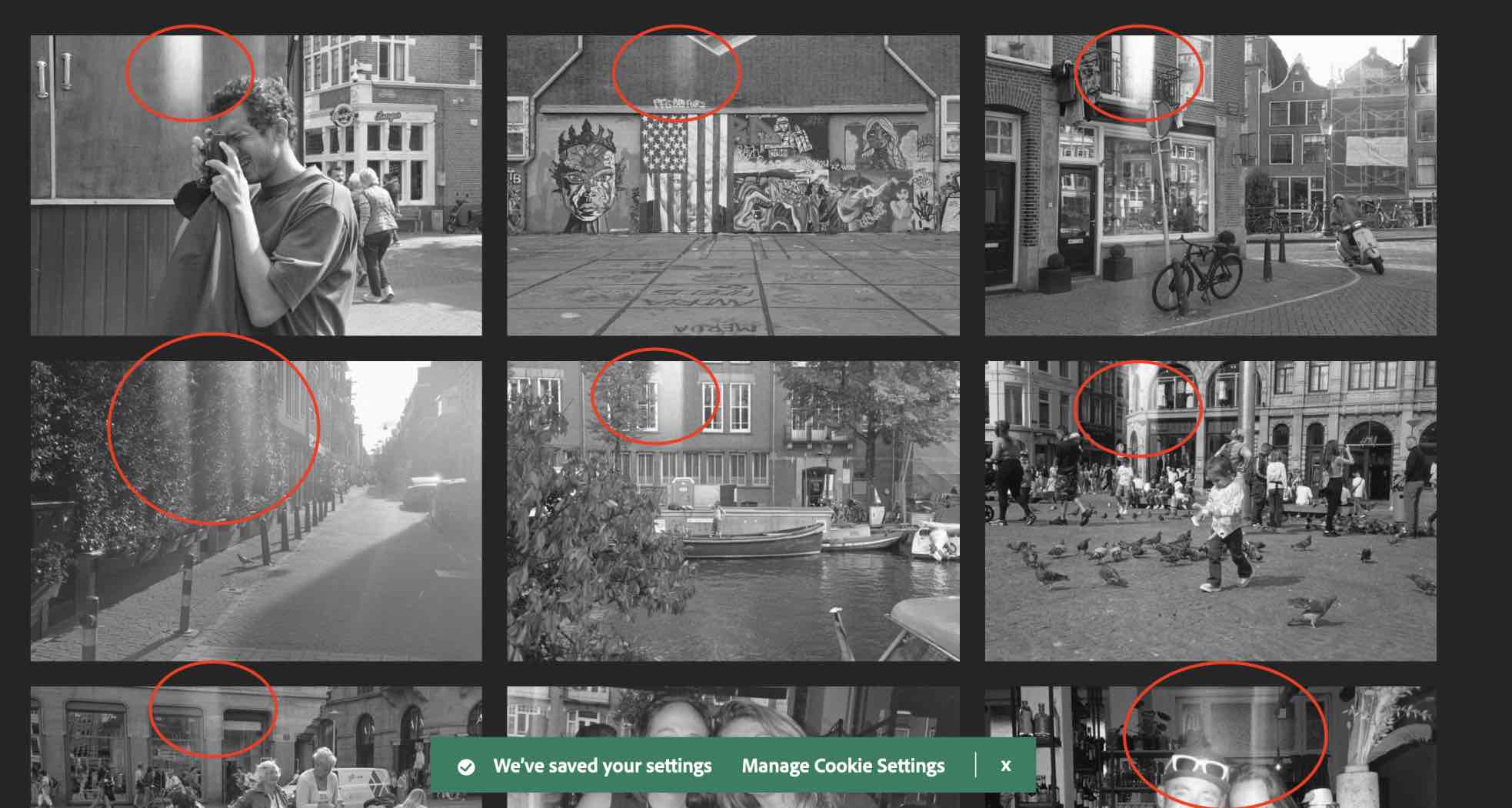

Hello friends, newbie to the forum here, and also newbie to at home developing. I'm hoping to gain some insights from the community to see if my recent roll is suffering from light leaks in camera or in the film canister, or if I messed up in development. This is my first time developing a roll of Kosmo Agent Shadow 400 shot at box speed, here's my development status:
  • Film - Kosmo Agent Shadow 400, shot at ISO 400
  • Developer - Adox FX-39 II (1+9 Dilution) at 20 degrees Celsius.
  • 10:30 minute development time with agitation for first minute, and 10 seconds every minute thereafter.
  • 8 minute fixing time
The constant appearance of what looks like a light leak to me seems to be in the same place, but I haven't run into anything like this before yet. Granted, this is only my 8th roll of film I've developed, but hoping to gain some insights here so I can prevent it in the future. To see the images in better resolution, here's a link to the gallery: https://adobe.ly/3Z4F9i0

Since this seems camera-related and not development-related, I'm going to ask: what was the camera?

@Alex Benjamin @koraks the camera is a Ricoh FF3 AF point & shoot. I've shot thru 3 rolls of film on the camera previously this past July & August in various indoor and outdoor & lighting settings, and didn't have this issue previously, which led me to assume I maybe messed something up in development as that world is quite new to me, and I had doubts that the camera would develop issues within such a short time frame.
I'm trying to think of what I could have messed up, and maybe the canister got some light leaked into after I removed it from camera. I can't recall if I just put it in my sweater pocket, or if it went back into a film plastic container. :-(
But to answer the question, def light leaking issues somewhere and not dev then? Haha

It's camera-related and most likely has to do with the light trap along the bottom side of the camera back. It's virtually guaranteed to be caused by the camera because the light leak occurs in the exact same place on every affected image.

Might be the canister—I don't know Kosmo Agent Shadow 400, or how strict their quality control is. Only way to find out is to shoot another type film and see what happens.
Don't think so; the light leak would not align with the frame spacing in that case. Also, canister problems tend to show up more on the first few frames and less so (or even not at all) on the final frames. In this case, the severity seems to change with every frame, which is consistent with camera light seal problems.

Here's a video on the light seals on that camera:

I agree with Koraks here - this is nearly identical to an issue I had with one of my M4's, which has a back plate hinged at the top. I spoke to Youxin Ye about it and he confirmed (he had done a CLA on this body), offered to send me a back plate which I could return if it didn't fix it. It was the hinge pin, I think, that was loose. Leak was at the bottom of the back plate (like yours, image inverted when exposing). I wound up placing graphic arts black (paper backed) tape around the back plate opening to prove the problem. I also noticed that I experienced more leaks (before the tape fix) when I held the camera with my thumb pressing the back plate. I wound up just keeping the tape, low tack, and replacing it every few months. Not a leak since.

The light leak is on the top of all the photographs, so look for the leak on the bottom of the camera. Remember the lens flips the image upside down and right to left.

Cut a small piece of b&W printing paper (unexposed of course), cut it to twice the width of a 35mm film strip. Fold or cut it lengthwise to 35mm width and place it in the camera gate with emulsion facing both ways and put marks to show how it is oriented in the camera.
Take it outside and, without firing the camera, rotate it in bright sunlight for several minutes.
Process the paper normal; if you have a light leak ,it will be on the paper

Though paper is far less sensitive to light than film. Maybe just a strip of film would be better. It wouldn't need to be doubled as film has a transparent base.

Thanks for all the insights guys :smile: I'll let you know if I can get another Kosmo canister, I bought it randomly during a trip to London as I had never heard of it, nor seen it previously, and the packaging was cool 🤣 so I'm not sure when I'll cross paths with it again.
So weird though, on the trip I was recently on I shot thru four rolls in this order with the following result:
1. Agent Shadow 400 - has the results in this thread.
2. TMAX 400 - No issues.
3 & 4. Ilford HP5 - Both had slight signs on some shots similar to the Agent Shadow 400, but nowhere near as pronounced. Like you only find them if you're looking for them.
