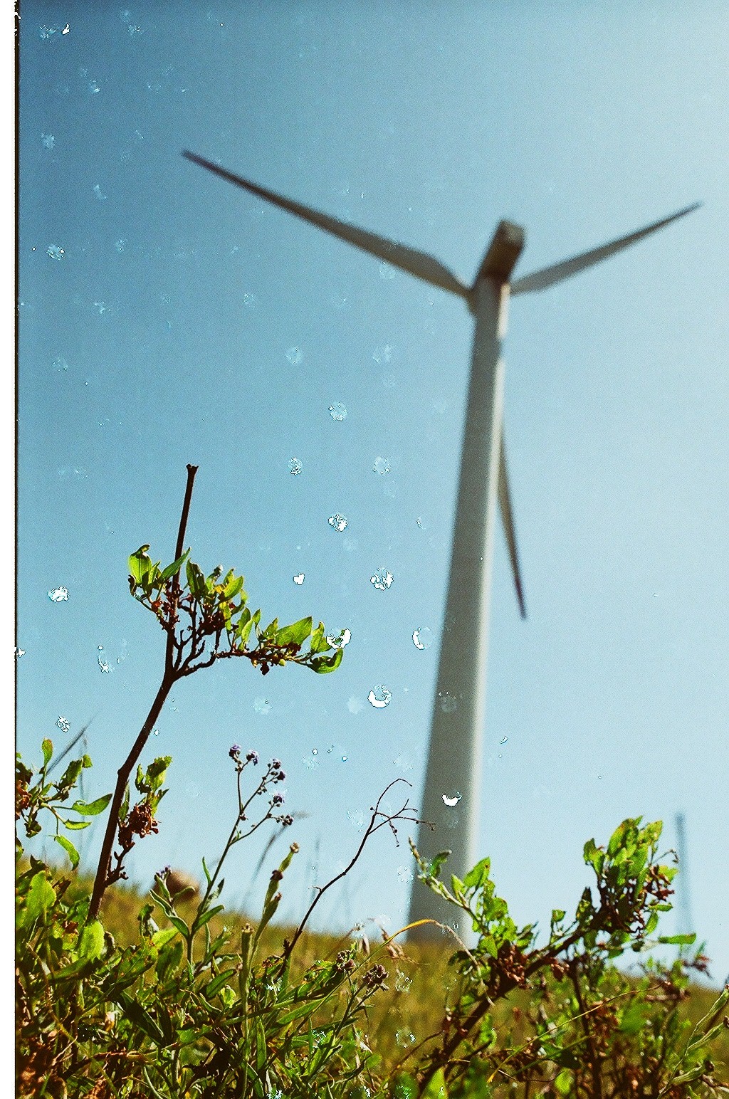

I had a roll of Kodak Gold 400 developed at CVS today. Every image is covered in white spots. I checked my UV filter to see if it was dirty and it appears to be OK. I also scanned in the negatives myself with the same results. Could this have been some sort of developing error at CVS? I'm wondering if using old chemicals could have caused this.

White spots on the print mean black spots on the film. Or dust! If it isn't dust, then it is a lab problem.
PE
pukalo
Nov 30, 2006
159
Its a processing problem that is common now in places with low volume (pretty much everywhere now, save a busy costco or two). Related to old/under use of the chemicals and the filters that clog up/fail as a result, allowing these precipitates to coat the film. I used to take my negs to Target, until i began home scanning andd saw, when ICE was turned off, how horribly speckled they were with this gunk. Hundreds of white spots on the resulting scans from each frame. With Digital ICE (the IR dust removal technology invented by Kodak0 turned on, you dont see these spots - they are digitally removed by the IR scan. But I had some hope of analog printing them some day, so I switched to costco. They are still busy with 1 time use camera film, so the chems are fresh and clean. Well worth the extra 50 cents per roll they charge (still the best deal in town - pro lab quality negs developed for $1.50/roll - and only $3.88 if you wants prints too).
Anyways, the Fuji hunt Europe website has an interesting paper on this problem, and they have developed low throughput/use chemicals to correct it.

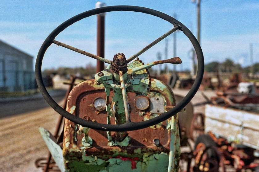

Thanks for the suggestion about ICE. My original scan was using VueScan. When I tried the ICE software the difference was noticeable as can be seen here.

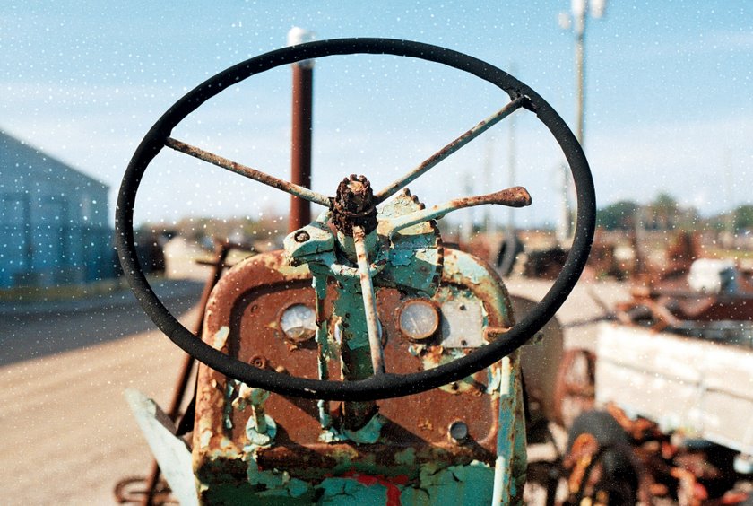

I had the same problem at a studio here in Nairobi. Since it's almost impossible to find developing chemicals and equipment to get my own darkroom set up (anyone with leads?).. and developing is less than a dollar a roll, this is the easiest option for me.
Does anyone know a safe way to clean the negatives to be rescanned? I really hope these can be saved.
this was the worst example on the roll:

You can try re-washing and then treating in a stabilizer solution. These can be bought very cheaply and they keep nearly forever.
You may have to filter your water to insure that the dirt is not perpetuated by more dirt in your water.
